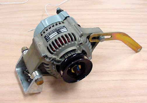

Generic Denso alternator:
Plane Power:
B&C:
Notice how they all pretty much look the same?
Plane Power:
B&C:
This proves that looks can be deceiving.
In all instances where those that I know have returned their PP alternators for repair (there are more than a few) they simply get another unit as a replacement and no description of what had actually failed...
Exactly! And that's the problem with this poll. If people would just (carefully) take apart their alternators and diagnose what actually went wrong before returning them, that would be a nice benefit for us.

Looking at the photos posted, the castings are not the same on any of them. So it does beg the question.
