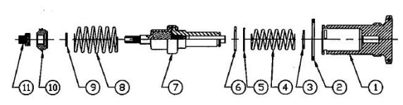

...I've concluded that something must be wrong with the machined seat in the oil filter adapter.
Paul, do you have a right angle filter adapter, like B&C or ECI/Titan? The four mounting holes are oversize, so the adapter body can easily be mounted with the vernatherm port not aligned with the port in the accessory case. Known issue.
Matt Burch recently made a nice alignment tool to ensure concentric mounting.

It should be removed, The vernatherm will restrict the movement of the plunger preventing it's bypass function in the event of an oil cooler restriction. Good Luck, Mahlon
So what happens to the Vernatherm when the plunger is installed?
Unscrew it. Remove the wire retainer (#6), allowing the vernatherm unit and associated parts to fall out of the adapter cap (#1). Screw the cap back into the hole as a plug. Easy to reassemble later if desired.

loosely install the oil filter assembly. Heat the Vernatherm and quickly insert it in the oil filter adopter. Tighten the vernatherm and then oil filter adopter bolts. A trick mentioned here at VAF. I just did this and will be test flying today. Will report back, if it improves the temps.

I just took a test flight with the "aligned" vernatherm installation. I found no change in cooling. At 7000', my oil temp was 210. The temps do not recover once level. Feels like the oil cooler is not getting any flow. My oil cooler is only two years old. It is a Pacific brand.
I will be testing the viscosity valve next.
Removed Vernatherm and installed Viscosity plunger and spring. Did the same test to 7000 and saw oil temp at 206. Leveling off, the temps will not recover and stays at 206 for a long time. Will be looking at oil cooler issue but not hopeful that I will find anything wrong. It is only two years old.

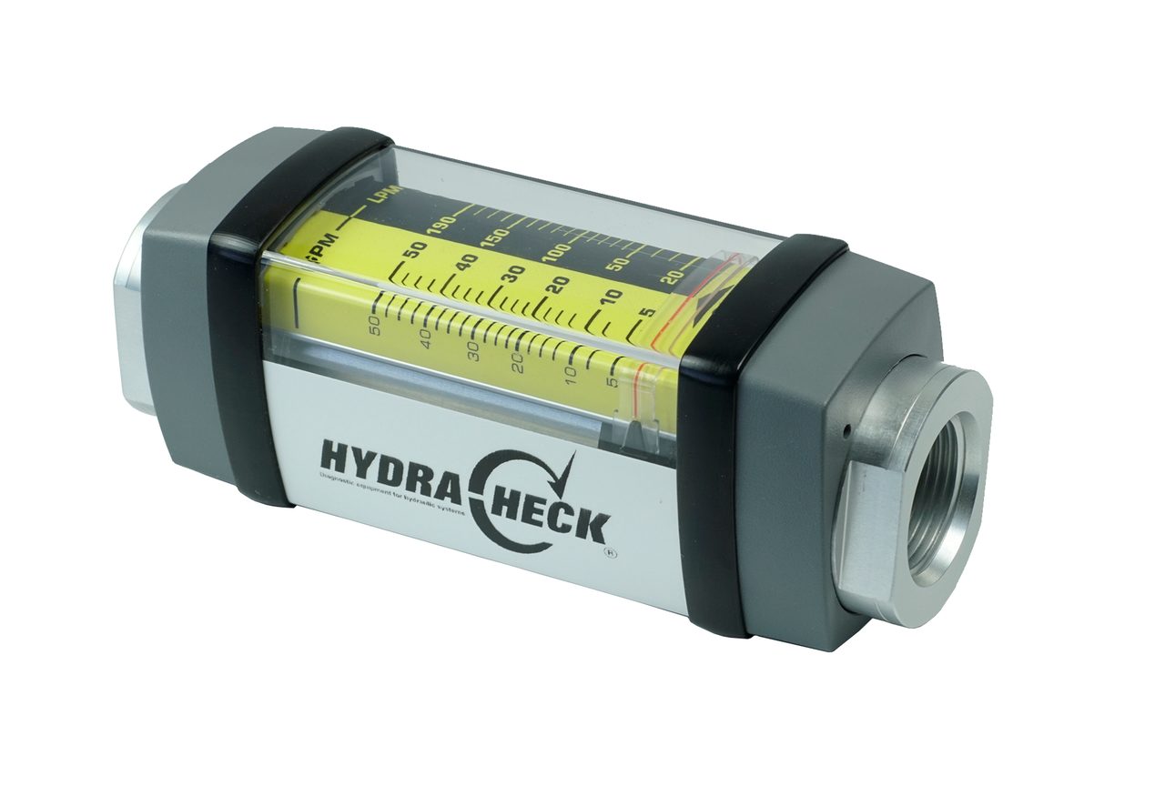

There is an oil side, an air side, and a heat transfer capacity based on those parameters and exchanger size. Put another way, you've ensured all oil flow is passing through the heat exchanger. Next you look at deltaP available. If there is good delta available, you look at exchanger size and efficiency.
Thank you DanH and agent4573 for your comments.
I think there are alternative to the $277 Hydracheck. It is great idea to run on the ground but I wish a Bluetooth model was available so I could check in flight.
DanH, any suggestions on measuring Delta P?
How about oil pressure? Is there possibility that my near 80 PSI oil pressure at cruise is keeping the vernatherm open all the time? Can't find the spec for the spring pressure on Vernatherm.
I tried to find a cheap alternative but everything <$100 is only rated to like 150F. You might be able to find a sensor-only that outputs pulses and tie it into a Garmin or dynon display as a fuel flow reading.
Wide range of choices. The measurement device can be as simple as a length of vinyl tubing and a yardstick. Add water, a few drops of food coloring, and one drop of Dawn detergent.

Nope. The tip of the vernatherm sees differential pressure, not system pressure. The deltaP is the difference between pressure at the vernatherm tip (flow direct from the pump) and pressure in the oil cooler return flow. The cooler's deltaP is often available on charts like the SW data linked above. Single pass coolers are low drop, and get lower as cooler size and oil temperature is increased. How low? For example, I run a SW 10611. 7 gallons per minute is the assumed pump rate for a Lyc, so at 7.5 lbs per gallon we have 53 lbs. The chart says pressure drop is 3 psi at 235F. To be precise, there would also be some additional drop due to the hoses and fittings, but the total would not be significant if the hose diameter is large enough.
BTW, your thinking isn't way off the mark. There is a specified "cracking pressure" for the vernatherm, which defines the psi at which the relief spring would allow the conical tip to push up off its seat. The Rosta spec sheet says it is 60 to 80 psi. If the oil cooler circuit should become blocked (for example, congealed oil on an Arctic flight), deltaP would become full system pressure. This relief is assumed to provide enough to oil flow to keep the engine alive.
