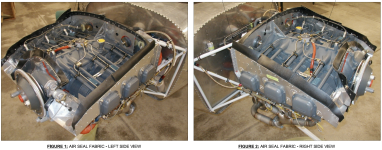

Brian Decker requested the attached pics of my installation.
Good call by Brian.
Zero sealing across the front. The seal is bass ackwards. Deteriorates deltaP across the cylinders and oil cooler.
Great catch guys. Thank you. Can someone post the right way to seal the front, especially around the governor?

Can we see some pictures of the inside of the upper cowling? We're looking for the "witness marks" that the baffle seals leave if they're set up correctly.
Also, the front ramps that start at the front inside lip of the cowl and extend aft....And...since we're here, how about a side view of the cylinder baffles (bottom).

One would think it goes without saying, but I still find this issue: With this type of seal arrangement around the front of the engine, be sure that the 'tunnel' created by the fiberglass diffuser ramps glassed to the inside of the top cowl are closed off. If the 'tunnel' is open, there is a huge leak path through it from the upper cooling plenum into the nose area of the engine.
