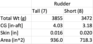

So how much heavier is a 8 rudder as compared to a 7/9 rudder?
I believe the -8 is lighter, but not by much. While the -8 rudder is smaller in area compared to the -9 rudder, it uses thicker skins (.020" vs .016"). The -8 rudder has fewer parts as well (no R-916 and associated rivets, smaller Rudder bottom, shorter counterbalance skin, smaller rudder tip).
The 7 Short (aka 8) rudder is smaller, lighter, and CG closer to the pivot than the 7Tall/9 rudder.
Area and weights not including fiberglass. Area is from spar rivet line aft.
Thanks Brian, I have just been lazy and not installed my 8 (aka 7 Short) rudder, and will have to invest in painting it too. I did all the glass fitting but not the final ready-to-paint details. Di you find any significant changes to landings?

Interesting that the 8 rudder CB weight is 1.85lbs vs the 7 rudder is 1.43lbs
Plans for the -7 big rudder (RV-9) call for the E-612-020 weight. Which according to Van's weighs in at 1.85lbs.
Ok now I'm confused.
According to the Van's website for the -20 weight:
"Counterweights for optional 0.020 Skins, RV-6/6A, Early RV-7/7A"

edit: confirmed the 7 tall-9 has the E-614-020 (1.85#) called out.
Yes but "I think" that was for the early 7 rudder (which was the 8).
The RV8 plans call for the -20....
Update: Van's tech support (Stirling) just confirmed both rudders (7/8/9) use the same -20 weight.
