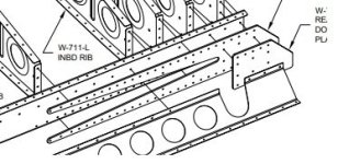

This is the area we are talking about right?
I understand that your concern is that you only have 9/16” instead of 5/8”…but just to clarify, Drawing 43 of the RV-8 plans (Section C-C attached) clearly shows that the 5/8” is from the edge to the center of the hole. I’m afraid that I don’t know the current generation of Vans tech Support folks like I knew the old gang (Ken, Joes, Gus, etc….), but I’d send them to that spot on the drawing and ask them to explain why they are interpreting it the way that they are. It coudl affect how you move forward with the replacements.

The fuselage connect bar part has at least 5/8 to the edges, so my plan was to use it as my guide to drill it from both sides incrementally. I didn't think the fuselage part has to be replaced, but if enough experts chime in and convince me otherwise, I guess it will be done.
The actual distance on the wing side is 4.5/8 or 9/16, or I really want to round it up to 5/8. Based on the builders' consensus here, I'm glad to say I was right and I know how to read the instructions!

My RV-9A drawing shows 3/4 inch spacing from center of bolt hole to the bottom edge of the rear wing connect stub, with a 5/8 inch minimum spacing. So, the optimum spacing (3/4 inch) to minimum spacing (5/8 inch) is actually 1/8 inch, which is substantial. Because the fuselage mounting bar stock can actually end-up overlapping after the wing angle-of-incidence adjustment is made, it's easy to get the edge margin less than 5/8 inch because the wing spar stub can become somewhat hidden during match-hole drilling process. My photo below shows this -- so, marking the actual wing stub line with a Sharpie on the rear mounting bar is probably a good idea -- that's what I did.
I did not remove bottom skin to buck the rivets on my redo. This area of rear spar has several(4) ribs a few inches apart. I was unable to reach between the ribs to buck. So I made this bucking bar extension to reach from a lightening hole to the rear spar. My wing was in a cradle leading edge down so I was reaching up with this bucking bar to buck on the front of the rear spar. Take your time. Its a tedious task but can be done
