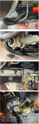

SOLVED: Need help adding B&C starter …PandaCub
After scratching our heads for awhile, my local A&P came up with a solution. As it so happens, AVStar makes a lever that offsets the mixture linkage such that it just clears the B&C starter housing. This, along with a little fiberglass work on the snorkel, seems to have done the trick. Many thanks to all involved in finally getting a reliable starter into this RV-8. Comments appreciated.
My RV-8 (Lycoming IO-360-M1B) has gone through two Sky-Tec 149-12LS starters and now the 3rd is starting to act up. I've heard only good things about B&C, so I purchased one of their starters (BCS206-149-12) only to find there are some fitting problems: First, it runs into the snorkel (Fig. 1)...
