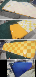

RE: A productive day in the hangar
Checker tail day.. it took 3 hours to get the cnc'd mask on.
Cant even think of how big a pia this would have been doing it the old way.
Good day... managed to get brightener through epoxy primer. The fillet material around the canopy wasn't on properly prepared aluminum so I removed it prior to today's steps. All in all I'm stoked with the progress.
