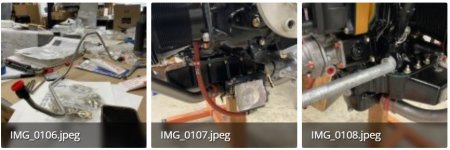

Facet Pump Alternate ...Tony Kirk
Facet quit making the 40108 pump.
You can use the following parts to convert a 40135 NPT port pump into an AN6 style pump.
ES 40135 4.5-6 PSI 1/8" NPT Fuel Pump from Van's Store
AN816-6-2D 1/8" NPT to AN6 Straight Fitting from Van's Store
AN823-6-2D 1/8" NPT to AN6 45 degree Fitting currently not available from Van's - Google search to find one.
Here is how it goes together.
