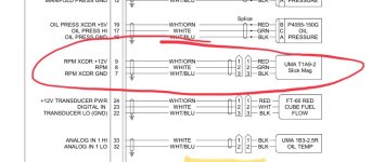

Tach input to G3X from PMAG...Webb
My schematics were drawn with a UMA sensor on a slick mag. Instead of slicks, I will be using dual PMAGs. Please tell me if this is correct…… The UMA sensor is deleted so the 12v input from the GEA24 is not needed and Garmin doesn’t require a diode.
