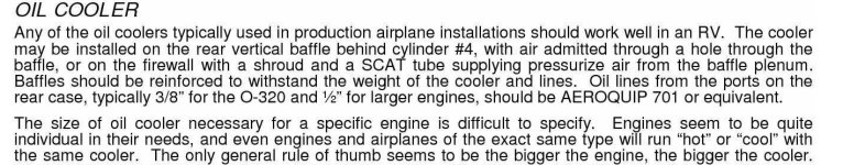

When I picked up the engine, the rebuilder told me "You will need an oil cooler". My -4 has never had one. When I checked the application chart on Aircraft Spruce, it refers to aircraft models, ie, Piper PA18. How do I know what oil cooler to buy? I see they are rated by "rows".
I see in the builders manual that it states, essentially, any oil cooler will work. But with confined space, etc., I was hoping for some examples. I have the O-360 in a 1985 RV4 (not sure if cowlings changed since then). What else do I need to consider before choosing an oil cooler?
https://www.aircraftspruce.ca/categories/aircraft_parts/ap/menus/ep/oilcoolers.html
Shawn
Generally, it comes down to what you can make fit in the available space. You will find wildly varying reports from -4 drivers about CHT and oil temps. My opinion is that this is due to so many variables with the cowling, inlets, baffling, engines, climate, and instrumentation (at least). With my old O-320 and 8 row oil cooler, my oil was always very hot. With my new O-360, 10-row oil cooler (AERO CLASSICS 8000081) and new cowl, baffles, etc... my oil temp rarely exceeds vernatherm temp. I would certainly NOT say that this is the only setup that will work - just the one working for me. I suspect mounting the oil cooler on the firewall would be ideal but I didn't have space for that. I would not recommend mounting it on the baffles behind #4. However; that does work for some folks.

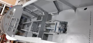

Moving on.....getting ready to paint the interior. Today, I stripped all of the wiring and things (rudder cables, static line, trim cable, etc) that might be in the way of spraying.

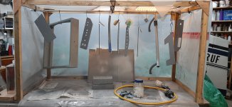

Paint prep
from post #13
I own a 94 -4 that I completely refurbed and modernized. My interior was painted that same hideous blue, It kept me up at night…I was never so happy when I repainted it. Used a flat gray epoxy primer, turned out great and is very durable. My apologies in advance if you are partial to the blue.
Flyhud
How did you prepare the interior before repainting? I visited our local automotive paint store. They suggested a fine 3M pad to scuff the surface. It does seem to work well for the general areas in good shape. I have areas with scratches and the old paint peeling that I would like to smooth the edges of, but I don't want to use a "too" aggressive sandpaper for fear of scratching the aluminum. What grit sandpaper is good to use for this application? I don't want to use paint stripper for fear of getting it between pieces of aluminum. My other thought was wiping with a lacquer thinner. That might soften the edges of the chipped area.
At the end of the day, anything I do will be better than what it is. I don't want to cause other issues.
Interior primed

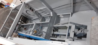

Got the interior primed yesterday. 2 coats of epoxy primer. I wanted the gray look. That certainly changes things. Now the fun part of putting things back together. :)

The fun continues. (Not sarcastically...it is way more fun putting things back together than taking them apart!) I assembled a small paint booth to try to control some of the overspray in the shop. It helps a lot.
While doing this, I am looking ahead to the panel and wiring. As much as I have skimmed through some of Robert Nuckoll's aero wiring book (It is loaded with info, but quite a read) I cannot find a guide for choosing the size of wire to feed the fuse panel/cct breakers. There is a lot of information of cross area of wires, etc. but for choosing this main wire, is it as simple as adding up all of the possible electric draws and choosing the wire accordingly? Each fuse is not the actual draw of the instrument/light/radio etc so it would lead to overkill. But short of finding a "rule of thumb", that would be a logical conclusion. Any suggestions/references on choosing this wire size? It will be relatively short (~ 2 feet) so not a lot of loss going on in my installation. I am guessing a 6 gauge would be more than enough, but hoping for some input.

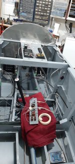

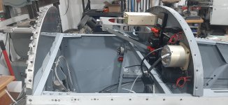

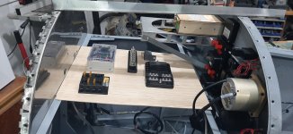

I am starting to work on the wiring. I will be putting a shelf behind the instrument panel to support the fuse blocks, grounding blocks, light control module, etc. I looked at options like on the floor for the control module, firewall for the fuse blocks, etc. but I like the shelf, and it be will be nice to install and for maintenance.
But, thinking about the wiring, how does one make the actual physical connections for the communications pins? I don't have much to connect, but the engine monitor can connect to the GPS RS232 lines to calculate fuel necessary, and the AV30's connect to the GPS for course information. The pins don't look large enough to put two wires into them. I think my system is too simple for the junction boxes I see in larger systems. So is it a matter of stripping the wire back from the pin and joining it there? I think Stein calls it "window stripping"? That is about the best video that I have found but hoping someone can confirm this is what I need to do for the communications lines. Or do I use a terminal block outside of any connector? I would be concerned about losing shielding but maybe those lines are not sensitive to interference? Any suggestions?

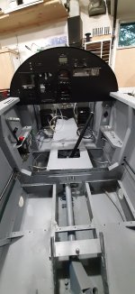

I would at least place the fuse blocks in a position where you can get at them to change a fuse Without removing the top skin. Maybe up side down on the bottom of the shelf so you can at least reach under the panel to get at them.
I have been toying with this, as well as putting the shelf on a hinge of some sort. But my reasoning for it being as shown is that, at 60 years of age, I would rather undo the screws and lift the cover off than contort myself under the panel and work upside down. Not sure if I will regret this or not. Depends on how many times I have to take the skin off or not.
Well, I, for one would not put it under the top forward skin. There are a TON of screws that would have to be removed every time you had a fuse issue. PITA. Looks like there is plenty of room under your starboard switch panel. That said, in all the flying I have done, I have never had to rest a breaker. I would still think about putting it in a more accessible place. If you do blow a fuse, you know it's going to be somewhere that isn't near your home base. There you are, out on the ramp in the rain.........:( Just a thought.
Your airplane is looking MUCH better than the pictures you posted after you acquired her.....Keep up the good work!
I placed mine on the front of the electronics tray angled down. It’s easy to reach under the panel and change them by feel. I keep a diagram of which fuse is in each slot so I can remember which is which.
Great progress! I would keep the eqipment shelf as small as possible, the larger it is the more you will inhibit access to the center tunnel and the rudder pedals, brake cylinders etc. I also placed a row of breakers (non essential equipment) on the shelf facing down so they can be accessed simply by reaching underneath the panel. I’ve attached a few photos of my installation that may help with ideas. To make wiring easier, I built a jig which replicated the position of the panel and the equipment shelf in the airplane so I could do a majority of the wiring on the workbench.

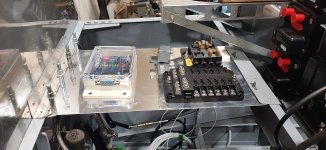

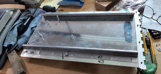

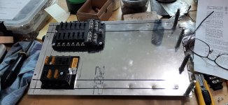

I decided to consolidate suggestions with my initial thoughts. I made the shelf that swings down with just 2 screws, should I need/want to get at the panel via the pilot seat. Or access it from the top which will make initial wiring much easier. Removing the hinge pin also allows me to slide it left or right for maintenance issues, but the pedals and brake components are pretty accessible without moving it anyways.
Thanks for the input!
Shawn-
This is a great idea.
Any concerns about vibration. I'm wondering if the additional vibration (if any) using a piano hinge will affect the any electronics where they require you to install on a "solid" structure.
Thanks guys. Yes, there are 2 j-channel stiffeners underneath. And with the front edge being screwed to the bulkhead, I think it is rigid enough. Hoping so anyways... :)

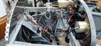

Panel wiring (or rather, general wiring) is moving along. But moving, so that is a good thing....:)

If it hasn't been said already, label ALL your wires, both at the beginning and the end. It will make things MUCH easier when trying to chase down an electrical problem!

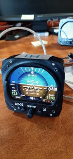

I have been working away on the wiring. As suggested earlier, I built a fixture to hold the panel on the workbench, and did most of the instrument wiring on that. This worked out well. But then the panel went into the plane for the next phase. The swing down panel did complicate things a bit, but I think it will be worth it long term. I will probably switch the screws holding it up for some quarter turn fasteners of some sort. Almost done though. Next will be putting the engine mount back on and getting it back on its gear. I had to change the battery mounting. The battery that came with the plane (Odyssey 925) did not fit the original brackets. I was convinced to change batteries to save more than 10 lbs and now have an Odyssey 680, much more reasonable. It is the same as the one in the 9A too so I have consistency. This meant changing the hold down method and my buddy came up with a nice bracket for that. Will post a photo of that later. Another feat this past month was the updating of the AV30's firmware. In doing that, I found one internal battery showed as a "Failure", from being discharged while waiting for installation for the last year. But after cycling a few times (connecting and removing power), the battery started taking a charge and passed the subsequent endurance tests. uAvionics support was good through this process.
I should be able to remove the panel from the plane by disconnecting just connectors when I am done...should I want to make changes in the future......if I did things right.....:unsure:

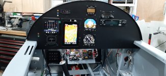

I arrived at the point where I started applying power to circuits. Woo Woo! I also did some configurations on the AV30's but have a lot to do. Being very customizable leads to time spent with the manual and after flying to set up all the fields and where you want them. The biggest things were getting the lower one to power up as a heading indicator and talking to the GPS. Relatively easy to do with the manual in hand. Kind of cool to punch a new waypoint into the little portable Garmin, and have the HI spin around to the new heading with course indicator. (Little things in life make me happy...:) )

Not really....with the brace for the radio there, and where I located the master fuse block, I kinda messed that up. No wonder some guys build more than one. The second one would be better, I am sure. At least, in my case. :)

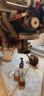

I don't have any decent photos in my phone but we are still making progress on this project. Fuselage wiring is done, engine mount is on, landing gear back on, brakes relined and reinstalled, new brake lines installed. The rudder will need to come off to address the fasteners discussed above. Deferred for now. Engine should be going on this week. Then all of the engine wiring, baffles, new oil cooler install (never had one so finding a place for it, etc)........the more I get done and closer I get, the farther completion seems to be....:confused:

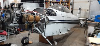

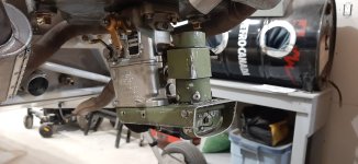

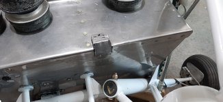

Plane is back on its own legs. Engine is on. Even after installing the Vans fitting into the fuel pump, I had a conflict directly with the firewall. So had to modify it. But I am happy with the result.
Firewall mod.jpg:)
