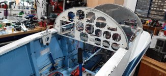

Attached is a photo of the current interior. Nothing is fixed in my mind re location right now.
Will need to sit in it and make airplane noises I guess.

I did sit in it one day and just kind of looked around. I have some ideas. Attached is a photo of the current interior. Nothing is fixed in my mind re location right now.
Good! Look at as many -4's or even -8's as you can and see what the consensus is for throttle placement. Look at jet fighter set-ups; nothing on a jet is way up where yours is. And the -4 flies like a jet, right?;)

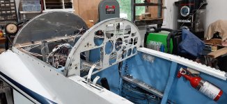

Hi Shawn,
I redid my -4 panel 1.5 years ago. I went with a pretty simple VFR setup. Here's a link: http://jdfinley.com/new-instrument-panel/
A couple points that I think are worth mentioning.
1. The removable fuselage/cockpit cover makes working on the backside VERY easy and changes a few of the typical design/layout thoughts (making things easily accessible).
2. My switches are mounted above the radios so access to the wiring is easy (from the back). In my case, the switches are rarely used in-flight and this location works fine. My more often used switches are on my stick grip.
3. An EFIS/engine monitor puts a LOT of information in a very small package. For VFR flying, the -4 instrument panel suddenly becomes very spacious.
4. You can just barely see from one of my photos that my trim is mounted about like yours with a very small lever. Throttle/Mixture is mounted just above it (but much lower than yours). This doesn't leave much room for accessing the trim lever but works fine for me - just muscle memory at this point.
5. I like the idea of a center console for storage but not for electronics. That's because of access (again, removable cockpit cover). I currently store a number of emergency repair items in the tunnel (with the battery (which is now lithium)) and some additional space would be nice.
Hope that helps... lots to consider!

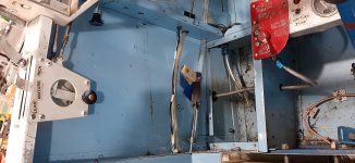

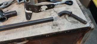

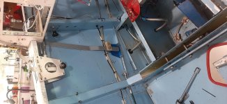

I have been gradually diving deeper into the re-build. I did put the seat back in and floor pans, etc so that I could sit in it and think....consider changes to be made, as we have been discussing.Not much new to report here. No revelations, although the trim cable location seems to interfere a bit with where the rear rudder pedals will connect to the rudder cables. That prompted me to explore electric trim again. Jury is still out. A tech at Van's gave me some good input on modifying an old -4 for electric trim but part of it was the suggestion to build a new elevator to accommodate the servo better than the original -4 elevator. Since a new elevator was previously discussed due to cracking, it might make sense to wait till that happens to install electric trim. Another option, mentioned here by a member as well, was to connect to the existing cable somewhere. Will see what happens.The trim cable needs to be moved slightly outboard anyways to put the throttle quadrant in that area so I can probably figure something out for the rudder cable connection.
I included the response below for those that might be looking into a similar conversion. I know there are a lot of threads and posts about this topic.
I then started looking at the engine. First thing I did was I dialed the crank to insure it was within specs and also did a compression test. Runout was good, as the seller told me. The compression test was a cold one and my intentions at the time was to do some engine work anyways, so, it was kind of irrelevant. Just an experience opportunity for me and I was curious. One intake valve a little leaky but otherwise, as expected for a well past TBO engine. I decided to send it for a rebuild/thorough inspection by an engine guy. I feel good about that so once it is there, I can focus on the other stuff.
Next will be just stripping everything out of the interior, then the relocation of controls and switches, making new switch panels as needed.

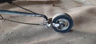

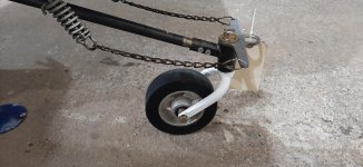

Couple of questions.
This plane has no oil cooler. Seller said one was never installed and he never needed one. Common?
The brake lines are all the plastic stuff. Good or bad?
Fuel valve is very stiff to turn! I will replace it. Any valves to avoid? I see quite the range in costs.
This plane has a Flightcom 403 intercom. It also has an Icom A210 radio, which has an intercom built into it. Does anyone have any experience with the use of the intercom built into the Icom radio? It is common, from what I have seen, that most planes have intercoms but I wonder why the extra equipment when the radio has that function.
Totally jumping of topic and out of the fuselage, what tools would you use to cut the light bay into the leading edge of the wing? Is a nibbler worth the investment? I would think tin snips would make a messy job of it (maybe that is just me). I have an oscillating saw. I am wary of distorting the front of the wing. Small zip wheel? Again, one of those things that once I get going, I will be fine but getting set in the right direction is always good. And as builders, who does not want to talk tools? :)

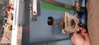

(Input from Van's regarding the mod of an old RV4 for electric trim)
The kit shown below is what would be used if a RV-4 builder wanted to install elevator trim servo into the elevator. The RV-4 however is not well suited for this kit as it does not have the E-615 reinforcing plate utilized by all other RVs to allow the servo installation in the elevator. Below is a snap shot showing the differences between RV-6,7,8 and the RV-4 elevator. It would likely be simpler to build a new elevator and alter it during the build than to convert an old existing RV-4 to allow this style trim servo install.
I have a RV-4 myself and If I were planning to convert from manual to electric I would instead modify the RV-10 installation detailed in the attached plans section 11 starting on page 8. This utilizes a short cable and then mounts the servo in the tail cone of the fuselage. You might take some time to study this installation and see if that is something you feel up to attempting.
If I were to change to electric, this is the approach I would take. I like the idea of not having the servo in the control surface.

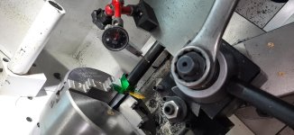

New tail wheel fork in
I modified the tail wheel spring and installed the Doug Bell full swivel tail wheel fork today. I still had the circa 1985 non full swivel tail wheel. I figured it should be one of the first jobs to do to allow easier moving of the plane in the next few months. Instructions from flyboyaccessories were great and walked me through the process.
Turning the tapered spring in the lathe was interesting but it worked out ok. Took some fancy pop can shims. :)
Hardware is temporary till I get AN hardware.

Yesterday was a fun day. I started removing everything in prep for a new panel install and wiring. (and painting the interior) It was interesting to look at how everything was put together. The plane was built with an old Loran, and then, over the years, that and the old radio were replaced, maybe other stuff installed, so I found old wires, coax, etc., also strangely satisfying to remove. ;)
Before I get too far, since I am going to move the throttle quadrant, I thought I should do this before removing the panel. I may need to look for interference, comfort, etc and the panel in place will help with that perspective. I need to slightly offset the trim lever as it is in the middle (inboard-outboard) of the space where the new quadrant will be. My solution was to put a bend into the lever. (I need to look at drawings before doing things...another lesson learned) The first bend went well but in attempting the second bend, the lever snapped. I guess aluminum does not bend like steel, my usual material to work with. Oops. This morning, I went to the drawings to see what the lever is made of. It is 2024 x 0.125 which I don't have, but I should be able to find some, or weld it back together. I am aware of the concern for min bend radius for aluminum and don't think I was anywhere near exceeding that (but it appears I was wrong), but alas...live and learn. In the plans, I now see that it is just straight so the easier solution would have been to just slightly adjust the mounting bracket, bringing the lever more to the skin in the area of the new quadrant location, thus, out of the way.
Other than that minor issue, a great day! Lots learned!

lever/quadrant/panel
I found some aluminum that worked out well to replace the broken trim lever. (Sorry, I can't figure out how to rotate image)
I have the new location for the throttle quadrant and a plan to mount it. Just finalizing the method to install it. Mentioned earlier, I found an old article on moving the quadrant. Attached is the article. Is this basically how those of you that installed your quadrant did it? Riveting support pieces to the skin to act as reinforcing as well as a means to attach the quadrant? Anyone have photos handy of how they did the quadrant mount? I have found/seen many of the final position but wondering about how it got there. Can't think of too many options outside of a variation of the article but my experience is limited right now....:confused:
For the panel, I purchased a large sheet of 0.063" 2024-T3, thinking I would "just" bend the lower flange. But after breaking the trim lever, I am thinking that this might be easier said than done. I googled bending aluminum and came across a few articles addressing the min bend radius (I was a little familiar with the concept) and how to do it (this is what I was wondering about). I think the stacked aluminum might work for me in my brake but doubt it will bend the panel material anyways. So I am now planning on riveting a piece of angle to the lower edge, as was found in my search. Any thoughts or input?

Well, no detail pictures, but I did attach the quadrant exactly as shown in the revised plans, with z-channels riveted to the F sidewall.
Same as for the lower bend of your panel, access to a proper bending brake will help manufacture those.
Re the bent on the panel, I’d really try to do it (or have it done), as the option of riveting an angle will not only add (a little bit… and another one) weight, but might introduce a sharp edge which might get your knees one day or another.
Dan makes good points ref the angle at the bottom of the panel.
An angle would be acceptable if it were my build. My Rocket project came with an angle and I never gave it a second thought. Regardless of angle or bend, consider a .75 or 1 in. flange in order to have easy to work with real estate available for adels if planning to bundle wire along it.
Thanks guys. I think I came up with access to a brake that can do it. The bend would have been the preferred method anyways. I will insure to have about an inch for running wires. Good point.

Looking at the diagram suggested for the throttle mount, it shows 2 pieces of aluminum running lengthwise and riveted to the inside of the skin. I know this plan is only a suggestion but since my level of experience is low, I thought I might ask a question or two.
Is there a reason that this cannot be one piece? I mounted my quadrant to a piece of aluminum so that it could be installed as one piece, versus removing the 4 assembly bolts. So having a flat plate to mount the mounting plate to would easier. And the lining it all up too. For me anyways as I venture into the world of riveting.
Seems obvious that it would not matter either way, but thought I would check in case there was a concern of cracking with over rigidity or something I am not aware of...:confused:

Mounting is really your choice,but make sure everything is set-up correctly before the commitment to drilling and riveting. My quadrant is all home-made, but much like any other store bought model. I incorporated a section of sidewall/armrest into my throttle mount and it all lines up with bracketry forward of the fuselage bulkhead frame to provide smooth movement and adjustability. I riveted some attach angles to the fuselage the quadrant mounts to, and the side of the quadrant becomes the attach angle for the sidewall close-out panel. Your idea of the one piece bracket would be plenty rigid.
