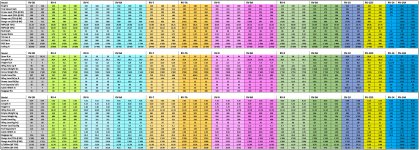

Whilst there is no, or little doubt on the landing performance, there are many variations on the takeoff technique, and again, the surface used. On a TD the takeoff can be performed in a 3 point attitude, or by raising the tail prior to starting the roll. Also the application of one notch of flaps during the roll on a manual flaps equipped model will give different results.
Interestingly enough, using Van's published numbers as in my model comparison table, TDs have slightly shorter TO distance (disputed), equal or slightly longer LD distance, a higher ceiling, a better ROC, longer range, higher load capacity, and a faster top speed.

I will now leave it as is, and keep wondering how those figures published by Van's were obtained...

What I wonder here is the contradiction between Van's published performance takeoff/landing figures, and what you are saying regarding the better takeoff/landing performance of A versions vs non-A versions.
Since you and I own a -6, I just took this screenshot of the performance as published by Van's on their website.
Takeoff distances for the -6, with the 3 different engines, are quoted as 325/300/270, and the ones for the -6A being 335/300/270.
Landing distance are all quoted at 300.
This sure is no reflection of any disadvantage for the taildragger version...
