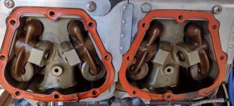

Mehrdad, I had the sump off my 390 earlier this year to do an intake flange mod for direct mounting of an FM-200. A little gray film, same as any other sump, but no sign of sludge. Same for last year's prop overhaul...the usual 1/16" or so of centrifugal deposit in the crank nose, and nothing noted at the prop shop. As for rocker boxes, pertinent to this thread, no sludge there either.
Can't speak to flow rate, but #2, on the left, is definitely not dry.

FWIW, here is a picture of my rocker box and my while I did not have much oil come out when I removed the cover, my other friend who has also had a sticky valve said, he had a bunch of oil coming out when he removed his cover.

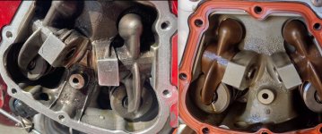

Interesting differences in appearance between your head casting (left) and my circa 2005 casting (right).
