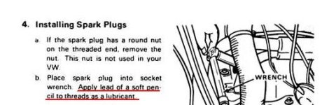

BTW, my bottle of antiseize dates back to VW beetles and airhead BMWs. Check out this instruction from a 1972 VW manual:
Dan,
I’d be really interested in what Lycoming says, if they ever decide to make it public.
Also, cool info from the VW manual! Wasn’t in my version of the Hayes manual for my 74 superbeetle. I don’t recall anything about plug thread lube/anti-seize in there. But, back then I’m not sure I knew what any of that stuff was. :) Good times.
