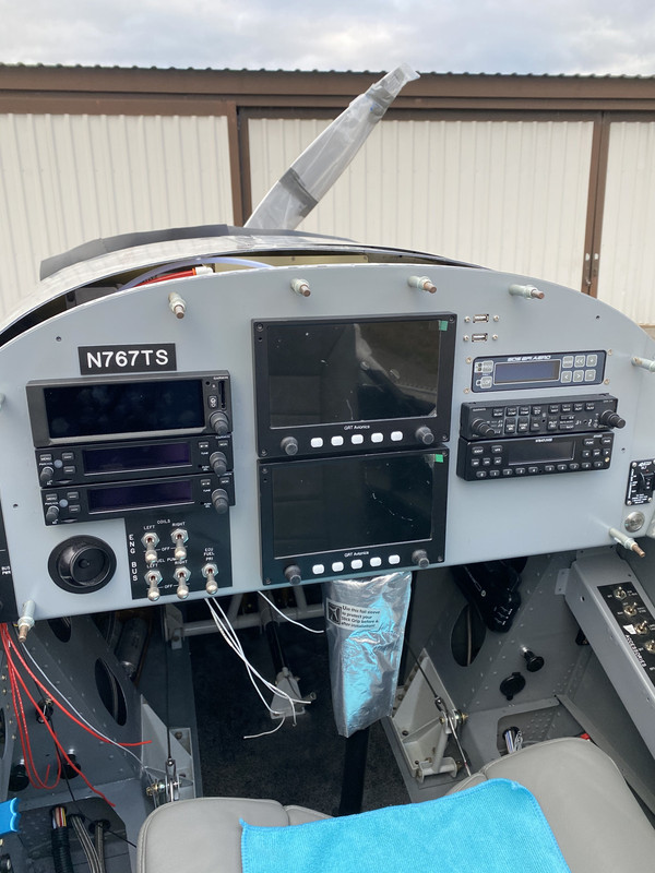

Just finished a rewire and new panel on a new to me RV8
I like where you put your circuit breakers.
Mine are located on the extreme left and right sections of the main instrument panel. Unfortunate as they are VERY hard to get too.
Also even if I moved the breakers elsewhere, those two panel sections are riveted to the fuselage so it would be very hard to re-purpose them.

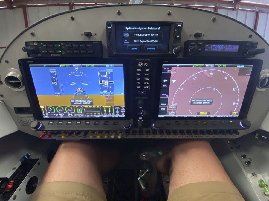

Here's my new panel, shortly after I fired it up for the first time this week. Still a few things to tie up and finish, but you get the idea.
Some details:
The panel was painted with PPG basecoat, then I had a local company screen-print the lettering, then we clear-coated the whole thing. It seems tough as nails, and I like the look.
The angled switch panel is a custom thing I created, inspired by the great Lyle Hefel and some other guys out there who created ones like them. It's structurally tied to the panel, the vertical channel cap, and also the stiffener that would have attached the stock Vans switch panel on the sidewall. It's removeable for servicing.
The annunciator panel is 100% scratch-built using 12V LED units like the ones Stein Air sells. The labels for them were created using Avery clear label stickers that go inside the lenses.
The circuit breaker panel is identical to a stock mid-cabin cover, but I made it out of thicker 0.040" sheet, since it was going to support C/Bs, a USB port, and a main battery charging port. (There is one downside to this location for C/Bs -- there are a LOT of wires going through the gear towers!)
The 2-1/4" gauge next to the G-meter is a Volt/Ammeter screen that can display data from both alternators. To the right of that is an elapsed time clock that will point at the tank I should be feeding from every 30 minutes. It's the KISS philosophy.
The military/airline Landing Light switch cap took me forever to source. It's a custom-milled item from a company in Spain that makes flight sim gear! Oh, the things we do for our passions...

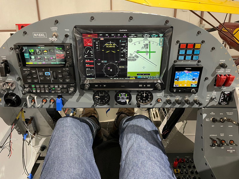

There's some fancy panels out there -) think I've posted this before but I still get a kick out of driving my 8 like the good old days -)
I spent a lot of hours staring at glass for a living, am over that!👍
FYI, for normal operation the 'Stby battery' (backup battery source for GDU/GEA24/GSU25) switch should be left on, turn on prior to start and turn off last at shutdown.
OK, got it. Thanks for the tip! Seller had told me to turn off after startup, but that makes sense to leave it on in event of an electrical failure.
