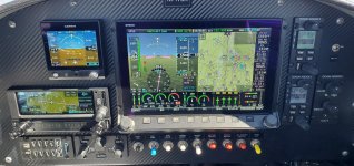

Scott Hersha's panel / LRI (AOA) gauge
Scott - that's nice how you have the top half of the gauge showing and recessed the lower half. Relevant info visible and red light hidden below - slick.
That looks like an Alpha Systems round gauge from image search but their website only shows digital displays. Where did you get that one ?
Joe
One other thing that’s cool about that LRI is the lighting. I have the under the glareshield strip led I bought from Stein. It was too long, so I cut it to fit. You can make a cut on these every 3 led’s. I cut a 3 light section and soldered a red and black wire to it and taped it to the glass on the face of the LRI under the glareshield where you can’t see it. When I turn it on I get a soft red glow up into the instrument. It puts a big smile on my face every time I turn it on.
It’s right in my line of sight when landing.
Joe
You can get it at Spruce:
https://www.aircraftspruce.com/catalog/inpages/liftmonitor.php?clickkey=14480
I bought mine from the LIFT MANAGEMENT, LLC owner.
The original LRI ceased to operate several years ago. Alpha Systems kind of took over, but no longer sell it either. LIFT MANAGEMENT does now. Contact the owner, or order from Spruce.
Scott,
Love that AOA indicator. Had one in my -4. It really helped me improve my short field landing performance.
Daddyman
Me too. I was coming across the fence way too fast, making things difficult. Landings improved when I installed the lift indicator, after calibrating it and understanding where I needed to be on the gage. 1.3 vs for me is around 65KIAS, and I know where on the gage that 1.3 is, and that position doesn’t change with gross weight or air density.

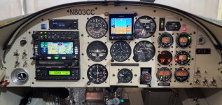

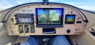

Panel evolution
After 4 years of ownership, finally have the panel just the way I want it, thru 3 steps. Original, 2 AV-30's, Dynon Skyview HDX and finally new radio stack.

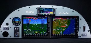

I just wanted to give a shout out to all the employees at Advanced Flight Systems but especially Jenn, Kyle, and Duane in helping make the panel I wanted!
The experience and customer service was outstanding. I can’t say enough good things about them. Great people, great service!
