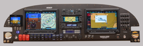

RV7 Center stack in standard height panel.
Put it in this standard height panel:
Thank You Walt. Very much appreciated.
Everything fits better than I expected. I better start planning. Any comments you can give on the Autopilot head being on top of stack vs on bottom near controls. I have seen it both places and can't figure out which is best.
I like not having to look down, it's closer to being where my vision is usually focused which is PFD or outside. Jets/Turboprops all put them up high so it standard with the 'big boys'. Depth is also limited up at the top of stack so that helps also.

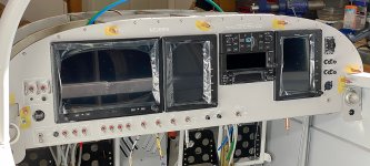

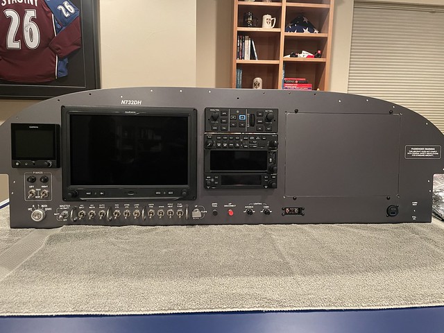

My RV7 panel
I still need to run wires, but here it is.
Dual 10” G3X
GTX 45R
GTR 20R
GDL 51
GTN650 rack only
GMC
245 audio panel

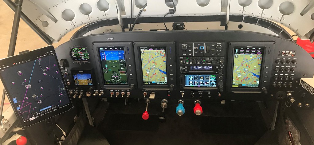

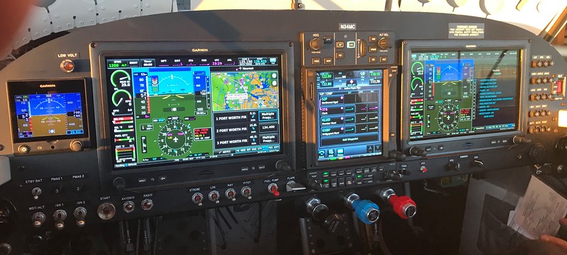

Here is a picture of my instrument panel all powered up. Rob and the rest of the guys at Advanced Flight Systems did an awesome job.

Looks great! Rob and Advanced are awesome. I wish I had done the G5 like you did on my panel.
Ya know... if you want someone to test out that IFD 540, Rob cut a spot in my panel that would look nice with that in it.
Thanks Dan. That's awful nice of you. :)
Greg- Looks great! 16o on 7.8 is nice too!
Question- do you mind the right handed grip on the left stick?
Stick grip works great. Second throttle on the left side. Behind the IPAD mini I use on longer flights. I have an empty spot at the bottom of the radio stack where the Apollo transponder was pulled when I did the Dynon ADSB/remote transponder upgrade. I hope to find a Certified GPS navigator to go in there with VORs going away. My current certified Nav source is a SL30. iPad and Skyviews for situational awareness, I’m told. WE Love the -7.
Yup, KPWT hangar furthest to the south facing runway. Working on the annual lately due to crummy flying weather of late. Can’t wait to aviate again soon.
Awesome! Well, just waiting on inspection and phase 1 fly off and I'll be exploring this lovely state we live in. Might just need to swing in and say hi.
Midway
I’m about 4 months behind you. I’m at KPLU. STOP in and I will buy you lunch!!
Left hand second throttle sounds like a nice mod, is how that was done documented anywhere, or is there a common way of doing it? Is it just a second cable to the carb/FI actuating lever?

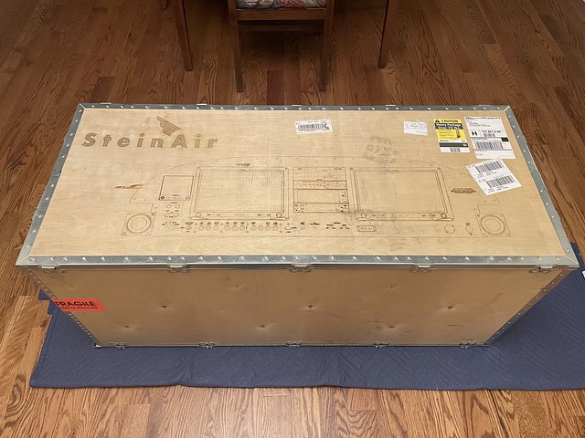

This is in the mail, delivers in 2 days. Looking forward to getting this part of the build complete.

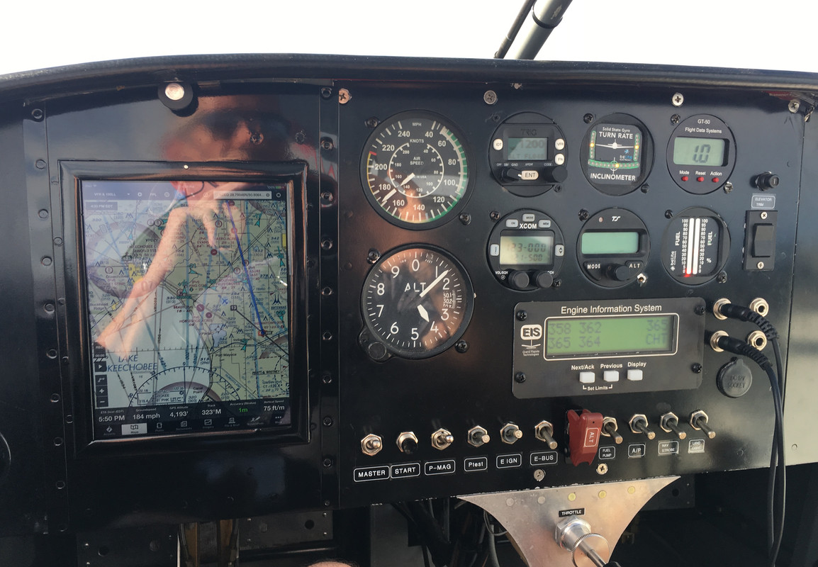

I have two mini iPads mounted in my RV-12 both running ForeFlight w/ cockpit sharing enabled. Angled iPad shows route and iPad above center stack is zoomed-in to show close traffic. I removed a 296 and left the large hole behind the center iPad for cooling. The iPad is mounted using small squares of 3M Body Side Molding Tape on the four corners of the case which provides 1/32” standoff and allows air to flow around the iPad for cooling. Works a charm…

Thank you for sharing Jim!
With two iPads, is "cockpit sharing" a feature provided by the Foreflight app? Or, is sharing something that any two iPads can do?
Thanks again!
Ryan

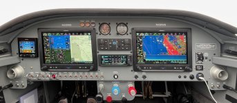

Just installed this all Garmin panel in my -7. Built the harness myself :eek:
  • GDU 460 primary display
  • GDU 470 MFD #1
  • GMC 507 auto pilot controller
  • GNX 375 GPS navigator
  • GTR 200B Comm
  • GDU 470 MFD#2

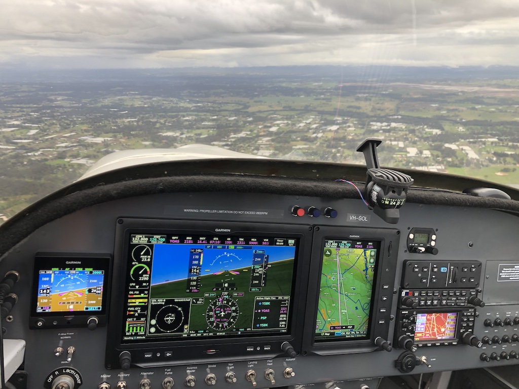

Here's my panel. After a summer of constant SF fog keeping me on the ground, it somehow grew some IFR capability (GPS175 + G5) ... funny how that works!
95 hours on it and it has been a joy to fly behind.
Here's my panel. ...
This is why we need a like button!
Nice looking panel. Although, I'm building an RV-8 and using Skyview, The colors, switches and labeling are exactly what I had in mind.
I'm laying out my panel by hand right now. Doing the cut template in 1/8 hardwood veneer. ....Tedious and nerve-wracking.
How well can you read the switch labeling at night? And, how do you illuminate them?
Awesome panel. Congratulations and happy flying.
