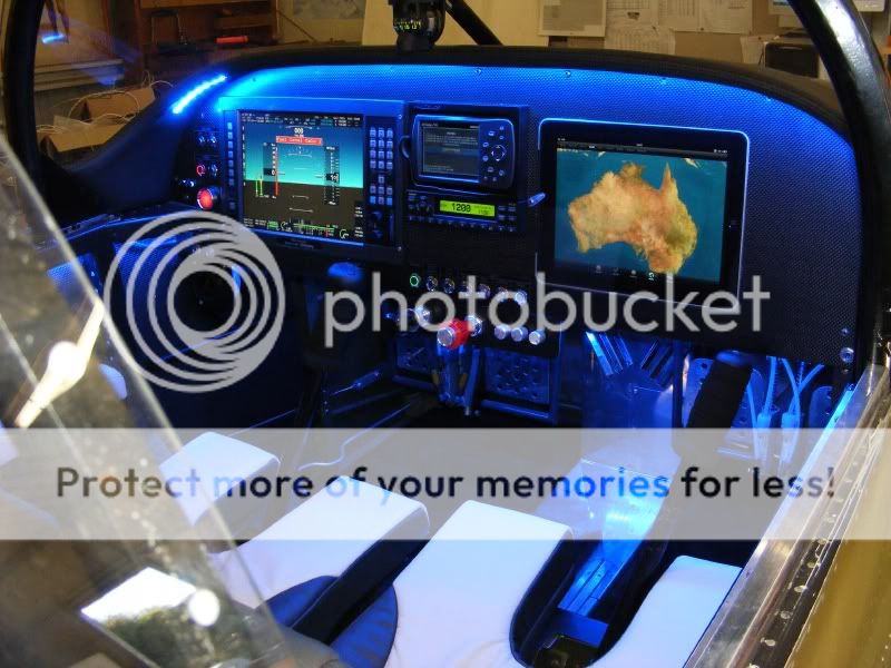

Show us your panel !!!!!
Some of you guys are out of control there with those flash panels! Amazing work & costly too!:) Airliner material:-)
Does anyone still do a std 6 pack these days? Old school here as I like to look out the window & admire the view than inside heads down fiddling missing the world go by:)
Go to post one, 2005, amazing to see how fast technology has advanced, I am new to all this and still learning, waiting for voice activated auto throttle take off and landing, they already fly A to B with just pushing a button!

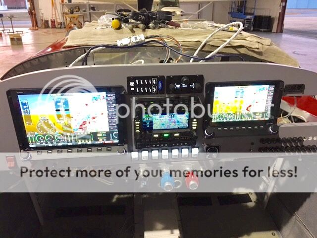

Review of my panel design/layout
Hello everyone.
So I'm working on FWF and will be moving into panel and wiring next. I have held off long enough and think I need some input on my panel design/layout. Please let me know your thought pro's and con's. RV7 - tipup

I like your panel. You might consider allowing a space large enough for a G5X just in case you (or a future owner) to install.

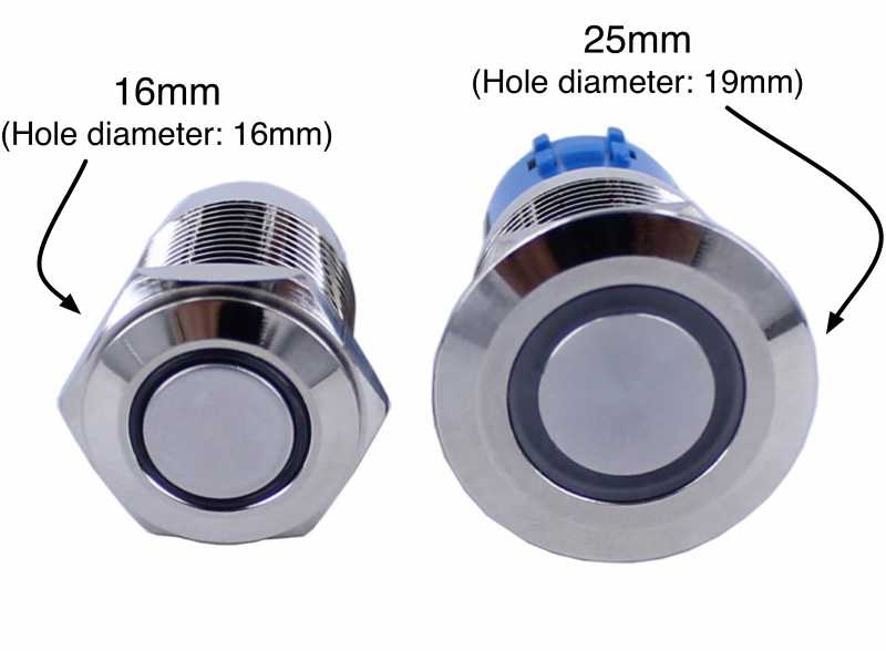

QUESTION > What switches are you planning to use for your lights (the larger circular), are they a push button?

Here are a ?few? comments, and of course, your mileage may vary:
1. The USB port on the left is so close to the throttle that there may be interference with the port or the cables;
2. If there is anything dangling from the ignition key, it may hit the stick when deflected or be a nuisance on your leg;
3. Things that earn their way onto the stick are those that you use frequently and need promptly, or need to access when both hands are busy. Boost pump does not qualify. Also, there?s the concept of flow, that you move your attention around the cockpit in the same order as they appear on the checklist to make sure that the switches are all set. Boost pump on the stick probably wouldn?t fit that concept well;
4. Similarly, the only reason for having flaps on the stick is if you need to dump flaps on the rollout. I?ve thought about doing this on my RV-8;
5. Nice that your stick grip is not left or right handed;
6. I?ve learned to fly my RV-9A with left hand on the stick, and it no longer has the awkward feeling it did when I started. You?ll have all of Phase 1 to get used to it, so you might not need the dual throttles;
7. Good that you grouped your switches instead of having a long row;
8. I?d put strobe at the end, rather than in the middle;
9. If you ever do go inside cloud, it will be strobes off, pitot heat on. You might consider putting them next to each other;
10. The parking brake is in an area normally reserved for power controls, and more specifically, for carburetor heat. I?d move it. Similarly for cabin heat;
11. No point in putting warning lights on the center stack, put them in front of the pilot;
12. Having a light for fuel pump on is no longer considered by all to be good human factors (quiet, dark cockpit concept). The argument is that it gets you used to seeing a light on;
13. Move the seat warmer switches closer to the pilot.
Hope this helps,
Ed

Here are a “few” comments, and of course, your mileage may vary:
Hope this helps,
Ed
Correct and there might be. The left side may move up / out on the panel.
Just the key – No dangling things….I’ll leave all the other keys on my car key chain.
3. Things that earn their way onto the stick are those that you use frequently and need promptly, or need to access when both hands are busy. Boost pump does not qualify. Also, there’s the concept of flow, that you move your attention around the cockpit in the same order as they appear on the checklist to make sure that the switches are all set. Boost pump on the stick probably wouldn’t fit that concept well;
How is the boost pump not used frequently? Pump on before / after takeoff and on during landing. Flow will be reconsidered, thanks.
4. Similarly, the only reason for having flaps on the stick is if you need to dump flaps on the rollout. I’ve thought about doing this on my RV-8;
I like it on the stick. Personal preference and I don’t need to move my hands during takeoff / landing.
I did this so there is no conflict if I want to switch hands.
6. I’ve learned to fly my RV-9A with left hand on the stick, and it no longer has the awkward feeling it did when I started. You’ll have all of Phase 1 to get used to it, so you might not need the dual throttles;
I will eventually adapt but I do this for personal preference.
8. I’d put strobe at the end, rather than in the middle;
My checklist have me putting on strobes before NAV, Landing or Taxi lights. So flow for me is this setup.
No problem. I’ll switch positions between the PITOT and A/P switches. Now they are next to each other but still separated by groups.
10. The parking brake is in an area normally reserved for power controls, and more specifically, for carburetor heat. I’d move it. Similarly for cabin heat;
I’m going FI so no carb heat. I don’t want any push/pull cables sticking out from the panel or hidden in a corner somewhere.
I have them above the COM to separate them slightly from the busy color screen of the EFIS. My eye will catch the out of place light warning better this way.
It will be off during most of the flight. Because I do not have a panel mounted fuel pump switch it will illuminate whenever the pump is on as a reminder.
This location is strictly for the wife. I will hardly ever use it and within easy reach for me and out of the way of normal switches. Same for the dimmers.
Thank you for the input Ed. It is appreciated.
Yes they are an on/off push button. An anti-vandal type of illuminated LED ring (or dot). The idea is from RV6/6A builder John Bridges (JackW - VAF) from downunder (OZ). Here is an image of his panel which I REALLY liked.
Not positive about the Master and Alt. switches. I think these need to be rated for load and I'm not sure if these push buttons can handle the master/Alt loads, hence the toggle. This will be my next round of questions in the "electrical systems" section after more research. John stated that his switches were "DPDT with a separate circuit for the LED ring. LED can be lit for either switch on or off. These switches are only rated at 3A@250V but that isn't a problem here because they are connected to a VP-X so only grounding a circuit to earth for the VP-X. The issue with that is I needed a separate power supply for the LED rings. Not a big deal with the VP-X though. The switches are IP67 rated."
An example of the switch I'm looking at is https://www.oznium.com/anti-vandal-led-switch and are rated 3A@12VDC. I'm trying to find a dual color button. White for off / Red, Blue, Green colors (depending on function) for on.
