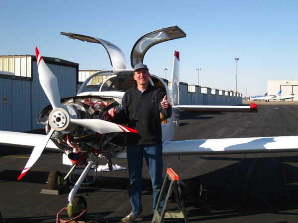

Engine started first time
Only a couple instrumentation bugs to figure out, otherwise ran great, no problem starting.
IO-540C4B5, dual Lightspeed, RamAir, AC, custom prop :)
Way to go, Dwight!
That is a Vans Smile if I've ever seen one. :D Can't wait to see you flying, so keep up the good work.
Yep.
That is a weird looking prop.
What on earth is it?
Jan, Paul Lipps was a one-of-a-kind individual, very forward thinking and definitely marched to a different drummer...a compliment, BTW.
His prop technology added a lot of speed to biplane racers at Reno and other venues. A brilliant man, laid to rest not long ago, with many technical articles on here over the years. He's already missed by many of us.
Best,
Yep, exactly
Second what Pierre said. It's a Paul Lipps design. Can't wait to try it out. I'm pondering copying Paul's cylinder cooling design as well, since I suspect I am going to have some cooling issues with my reduced inlet areas.
Dwight

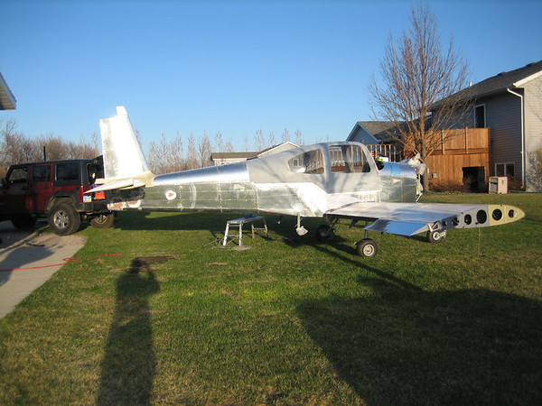

Yesterday was a pretty good milestone for us. She is finally standing on her own feet!
What an awesome feeling!

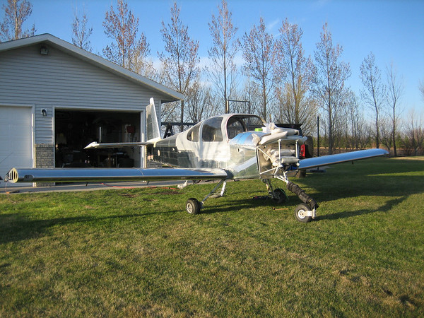

Wings Attached
Got a nice weekend so decided to take the plane outside and get the wings attached for the first time.
Really a cool milestone to see the wings on. It was very hard to take them off and put them back into the garage.
Congrats!!!!!!!!!!!!
Ya know, that thing is starting to look like an airplane:D
That is funny. Good thing I do not live on a busy road. The traffic that did drive buy, made sudden stops once then noticed it. Funny to watch the look on peoples faces, especially the neighbors that did not know what I have been doing in that garage all this time.
We've now got a 285 HP fan in the garage.
Where's the neighborhood cat when I need them? :D:D

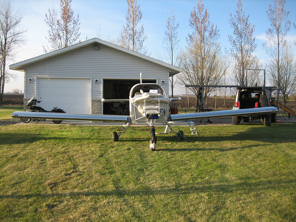

Still working on wheel pants and working on baffles while the epoxy is curing on the plane's shoes.
That Prop looks Great! The only downside is... wait till you start fitting your cowling. I lost count of the number of times it came on and off!
A friend of mine has a three-blade on his -10 and he ended up cutting the whole intake snorkel off, in order to remove the cowl. He then added camloks around its perimeter so it's a quick removal.
Best,
Looks great Phil! I have a two blade but still made a removable piece that fits in front of the nose leg. My cowl drops straight down and is easy to do. I'll round a pic up if you are interested.
Everyone asks about those. My two year old was parading around the garage wearing mama's shoes and left them at the airplane when I snapped the photo.
He comes out every day and asks me to make the airplane "go up". Can't wait until the day I can say alright let's do it. We may be changing his diaper.

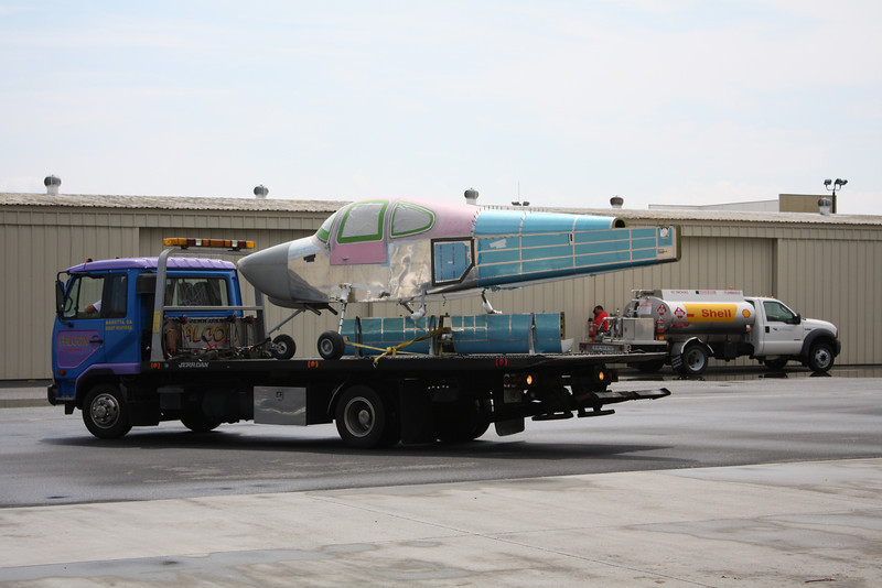

Hangar time!
We moved the big metal baby to the airport today. Next step - wings and tail feathers. :cool:
Congrats on your progress. We just moved ours to the paint shop using the same method... Tow truck. It was scary following behind it!
Excellent!
Good job Brian and Brandi! I am excited for you both. You look like proud parents in that picture! :D
Good for you guys, hope the drive to the airport is not too bad, dont let it spoil your rate of progress.
Flying by the end of the year?????
Thanks all. It was a great day and just having made it there safely with no mishaps was a huge relief.
Nice...
But what's up with the styrofoam cup? :)
hahah Brandi asked the same thing about the cup - we thought we were going to end up caught in a thunderstorm on the way out to the airport so I think one of our visitors thought their cup would help to keep some rain out?? :rolleyes:

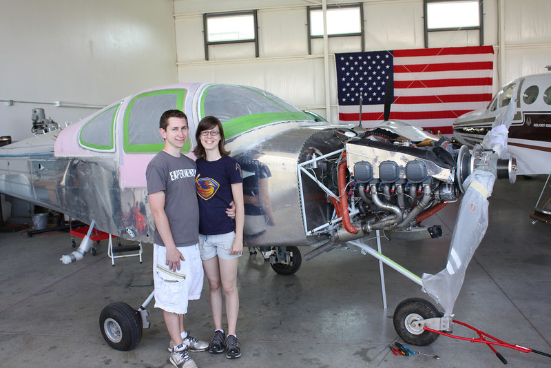

I think i see your manifold pressure (MAP) line running down then back up to the firewall.
Personally, i think it is better to run it up then down instead to prevent buildup in the line that you can't see thru.
My trap is in the clear line in the cabin instead. I can visually inspect it for blockage. Recently, i noticed some strange MAP readings. Sure enough, i had oil or fuel in the clear line.
I am curious how others have handled this issue.
Jae
