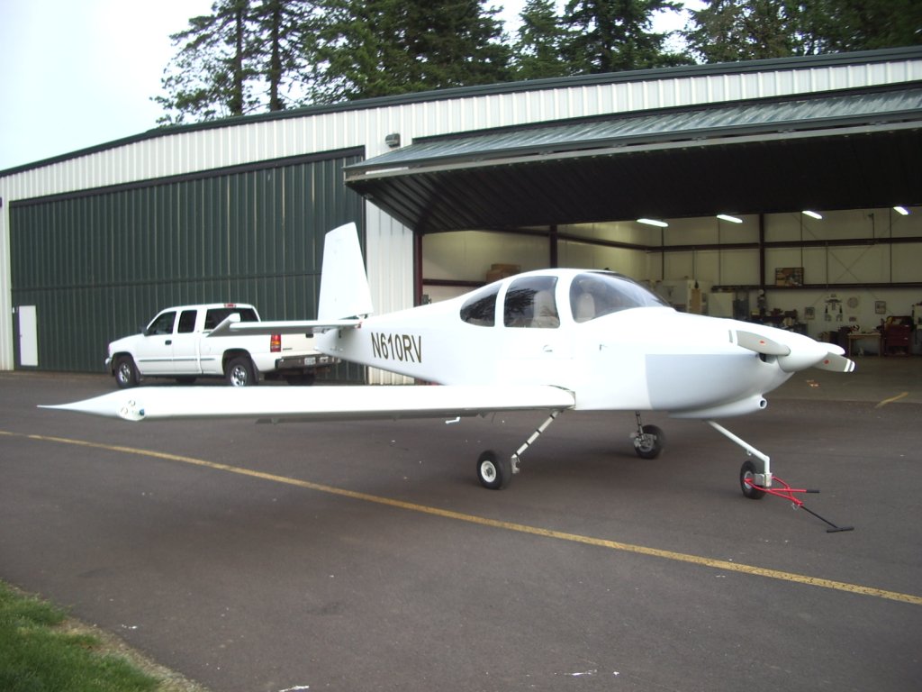

Well, the prop is on and paint and other items have started.
Working on a concelled oil door
Exhaust and baffle installation
I've started installing the baffle and exhaust system. I had the baffles powder coated black and the exhaust was ceramic coated at hpcoatings.com
People have talked about decreased life with ceramic coating because of increased heat inside the exhaust but the guys at hpcoatings haven't seen this. From what I can read this mostly occurs to turbocharged aircraft flying high with minimal cooling. I haven't supported the exhaust yet, that is why it is hanging down. I had to go buy some anti-sieze for the bolts before finishing.
I am hoping for a cooler cowling plus it just looks awesome!!!!

Scott,
I have had considerable experience with the Jet-hot coating and didn't have any problems. (Racing cars and motorcycles) You won't have shorter life, rather the opposite if you take a minimum of care. As you say, it looks great! I was visiting my kids and grand kids, (scary isn't it), for Christmas just outside Provo, I wish I had thought to call and see if you want to show it off! You will have lower in cowl temps. On the motorcycles I did the most recently I saw a reduction of about 10?F, which is a lot when you consider that the fairing isn't that tightly sealed.
