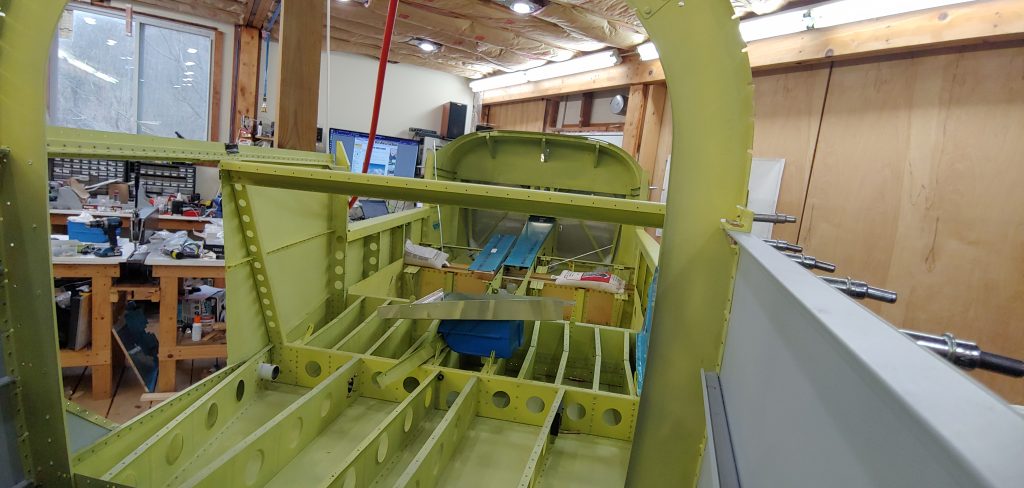

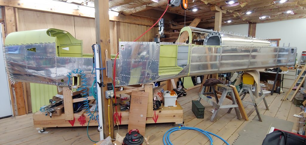

Tailcone Attached!
About a week ago I completed the tailcone attach steps, and am now embroiled in a lot of decisions about conduit and wiring runs! Also working on part of the brake lines and preparing for rudder pedal installation.
I've spent a ton of money in the last two weeks on fuel system parts, brake system parts, electrical supplies, and general hardware and doo-dads.
It's a real shift from primarily sheet metal work to starting to install systems!

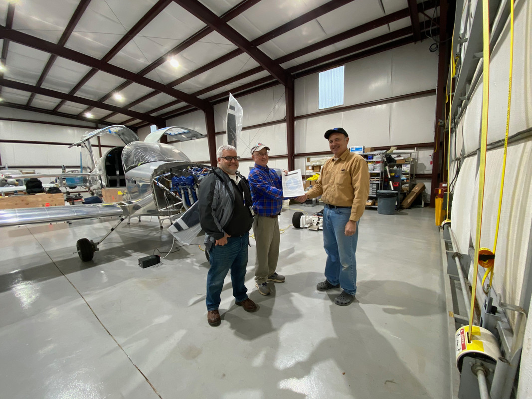

It's an Airplane!
After 3975 hours over 36 non-consecutive months, N10KE is officially an airplane.
Many thanks to DAR Vern Darley, for his thorough inspection today while he was being "inspected" by the local FAA FSDO representative.
Now to finish re-assembly and get on with Phase 1!

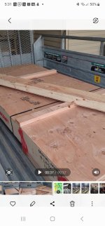

Anxious to start
Not much motivation here. Waiting to clear out garage and move this from hangar to house.

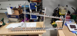

Do I need butter? :p
Can't exactly tell from the pic, but it looks like you could radius the most forward edge of the forward flange a bit more aggressively to give you some more breathing room.
On the -14, Section 6 (Vertical Stab), this is specifically mentioned:
Step 6: Radius the corners at the forward end of the
VS-705 Nose Rib and VS-706 Tip Rib flanges to
ease fit when the skins are installed. See Figure 2
and Section 5.2.

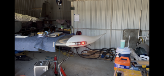

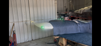

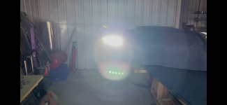

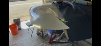

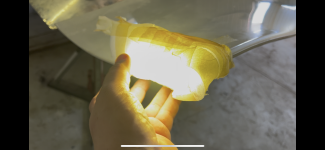

Got my ZipTip wingtips on. Nice and bright. Slow progress, but progress nonetheless.
The prop is on. It is a WhirlWind 330-3B-A/ 78G-78-S-R. Apparently one of the last before WW was sold.
Those tips are the Vegas tips, right? Are there any "gotchas" involved with the wiring?
They are the previous model Premier ZipTips. The Vegas tips look nice though; I like the ground lights.
I didn't have any problems wiring them. They came with CPC connectors; the female side was complete and bulkhead mounted and the male plug came with pigtails already pinned and a wiring diagram that worked for me. I did use shielded wire with grounds back to my common grounding block. No issues for me - the quality of fabrication is excellent. The landing lights are very bright; as in I completely lit up my neighbors hangar across from me on a bright sunny day.
