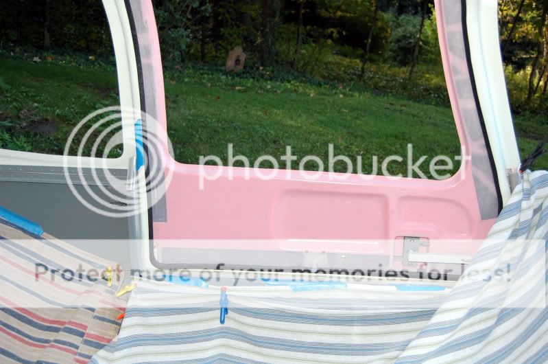

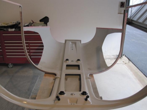

I don't have the doors finished like Bill, but I just finished the cabin cover interior a few days after him.
Aerosport Products Overhead, Map lights and air vents from SteinAir, general work lighting from Vans, Door Strut brackets from Planearound.com.
Yes, it is two colors. Geoff used my cabin cover as the master for his headliner mold, so the rear was finished awhile ago for that function. Since I'm using the Aerosport Products headliner, I chose not to waste paint where the headliner will be.
I plan to put individual task lighting on the aluminum inserts in the overhead.
bob​

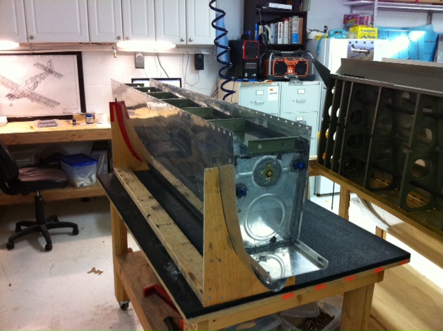

Finished my right tank today.
It will be nice to move on to something less sticky :) I will do the leak test when I get home from OSH.

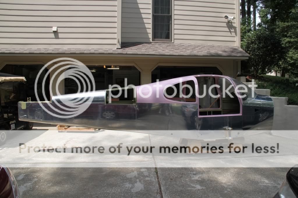

This may not look like much of a milestone, but it really is.
The skins have been match-drilled, dimpled, and clecoed to the tail cone for well over a year. The delay in riveting is so I could plan and prepare for all the systems installations and wiring runs, not just in the tail but also through the fuselage. Riveting the tail cone means that the forward fuselage is also ready to rivet (side skins are next) and I hope to be joining the sections within the month. I've been waiting a long time to do this riveting; now I'm installing the tail surfaces before removing them again until the fuselage is entire and on gear.

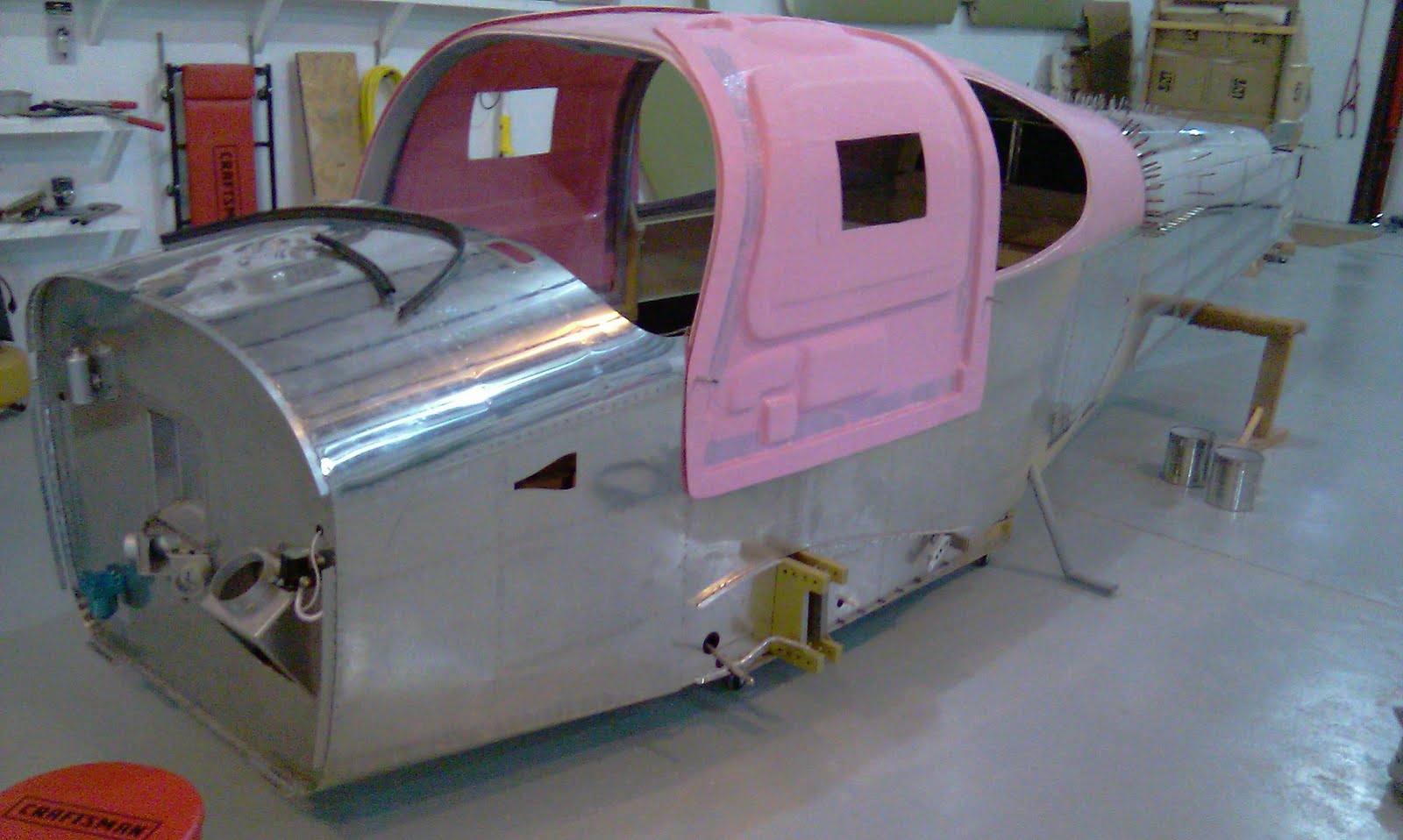

What did you do with your summer?
I built a RV-10. Doors. Began the door section on July 18 and worked pretty steady on them since, with some time out for the merriment of fitting windows and finishing the cabin cover. Many clouds of fiberglass dust later, today I completed final fitting (I hope). They actually fit fairly well, nice even but tight gap all around. Some minor deviations from cabin surface elevation, but nothing that some fiberglass work can't fix. Latches work smoothly and without undue force. Proper engagement with the door seals. Only an RV-10 builder can appreciate the emotion associated with this particular milestone.....
Great progress
As a 10 builder I know just how much work went into those doors.
A lot of on and off and a little grinding here and a little there but in the end you can make them fit very well as you have apparently done.
Keep it up.

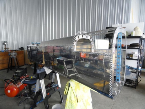

And then there was one
Well its been a long time coming ( four and a half years to be exact) and finally the tailcone was mated to the fuselage this weekend. Everything connected perfectly and its just about time to sit in it and make airplane noises:D
