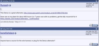

Anyone have a source for the wire harness or plug for the Denzo alternator?
Just buy the one from B&C, $17. The L-40 is the same alternator except B&C takes it apart and modifies it for external regulator, works perfect with Denso internal regulator. The field connector and harness are the same.
https://bandc.com/product/replaceme...-alternators-l-40-bc410-h-bc425-h-sk35-lom30/

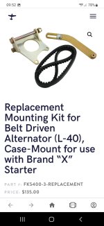

and depending on your engine, you might need the mounting kit from B&C order from their replacement parts link I posted above where you order the field plug and wire harness

Thats under $150. total for alternator and harness, the mount kit B&C sells will add another 100 or so if you need that
