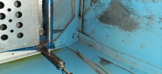

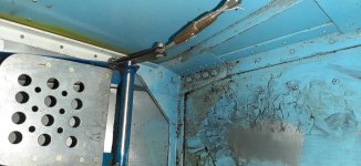

I did note two things. The paint on the bolt on the left one looks like it has been either removed and reinstalled or has shifted. Perhaps not torqued correctly? The right one shows no such paint break.
In the upper left, there is a very minor looking crack. It may be paint only and appears not severe, just something to investigate more when the fuselage is here in my shop.

The large bolt/engine mount
The large bolt is as you probably know, the engine mount attach bolt. Most are done with a drilled bolt, castle nut and cotter pin, which may be was "turned back" to get the cotter pin in, thus slightly loose. I installed mine with 12 point tension lock nuts. You can simply re-torque yours most likely. I'd dye penetrant inspect that suspected crack. At least who ever built yours did a pretty nice job of spacing the fasteners in the weldments..some I've worked on are horrible swiss cheese looking disasters.
..... may be was "turned back" to get the cotter pin in, thus slightly loose. .....You can simply re-torque yours most likely....... I'd dye penetrant inspect that suspected crack. At least who ever built yours did a pretty nice job of spacing the fasteners in the weldments..some I've worked on are horrible swiss cheese looking disasters.
Thanks. You bring me positive hope....:)
If you have the opportunity to pull the engine mount off (which if you need to replace the weldments you will), firewall cracks can just be stop drilled and sealed with an appropriate firewall sealant. I used a tube of 3M fire barrier caulk from the aviation aisle at Home Depot. You can opt to replace the lower firewall but it will just end up cracking in the lower corners again; it’s a design flaw that everyone has just come to live with.
"The wrinkles"
The wrinkle will appear in the lower half of the firewall/footwell usually just above the lower engine mount bolt and some "oil canning" can occur. There is a load of flexing going on with landings that can cause them in the soft stainless firewall. It has relatively zero structural purpose, and the load is carried through the engine/gear mount and the stiffeners behind the firewall. See attached picture..not mine, but they are abundant.

My wrinkle
This is the wrinkle photo I received from the seller back in the summer. After reading about it, and knowing I was buying a project, I went ahead with the purchase.

I wouldn’t give the minor wrinkles in the firewall another thought.
If the lower mounts are the thinner version you can add a .050 doubler on the outside. Replace the rivets one at a time with structural screws.
Only worth considering if you plan to operate regularly from sod.

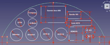

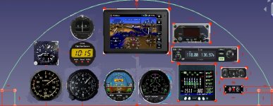

Panel fun
I have been playing in FreeCAD to layout the new panel. It is based on what I am keeping from the old panel and what I am planning to purchase. I have looked at several RV4 interiors on line and seem to like the switches and circuit breakers on the right side of the pilot versus in the panel. Some guys have done a really nice job with that so I hope to get close to what I have seen. Therefore, I have not left room for switches in the main panel. I have also seen some panels slightly taller and some with a panel added to the bottom of the normal size panel which contains the electrical switches and or breakers. All seem good options. Each to his own. I wonder if the extended bottom would make entry a little more difficult as I get older...? I will play with that when the plane is in the shop but for now, limited to planning with the standard size panel.
The attached is preliminary. Exact locations, ie to the 0.001" is not done but the general layout is appealing right now.
Please let me know what you think or notice if I am missing something. I do not have a slip indicator as the AV30 AI has it. With that in mind, the old style compass may be redundant but it gives me comfort. I am not sure of regulations if the AV30 satisfies all requirements. I guess it does as it takes care of everything else....
So, since we all like looking at, planning and discussing panels, have at it...

A crude albeit better than lines version of it the panel proposal.

wonder if these standby instruments are still necessary... if in clouds, the only vital thing is a horizon, outta clouds no instruments work good if one learned to fly rear seat, on a J-3 Cub, with a tall and wide CFI in the front seat :D
That's only me of course ;)

With 2 AV30’s and a backup 6 pack available on the Aera, the steam gauges are clumsy left overs. FWIW I have experience behind the AV30 and the G5. I much prefer the readability of the G5.
To revisit the lower engine mount: here are a couple of pix of my short geared -4 that was built in ‘87. The logs show a new firewall and engine mounts in the late 90’s due to wrinkles and cracks. The beefing up extends beyond just replacement of the mounts with the newer version.
Reconsidering panel ideas
Good points Dan and andoman. Thank you
I have not flown behind a digital flight instrument. What are they like for aerobatics? I was thinking that the ASI would be easier to read and may respond more quickly than a G5 or an AV-30. I also wonder how easy it is to read in those situations but I suppose that like anything, one gets accustomed to it.
Good point on the Aera 660 6 pack feature. Again, I never thought of the Aera as a back up flight instrument, but rather just a GPS. I underestimated it. So, since the AV30 can be both AI and HI, should the AI fail, I could switch the HI over.
So, yes, lots of redundancy. That was not my sole purpose. It was more to have a quick reference for airspeed and a backup for the AV30 Attitude indicator. But, obviously, I have lots to learn. For those that fly only behind a G5 or AV30, ever wish you had an analog ASI?
Thank you for the input. I may reconsider the extra instruments.

Version 3
Because I like playing with CAD and Paint, here is another option based on the last few posts.
I like it better already. The ipad will come out after every flight and might not go in for every one, depending on what I am doing. With the Aera660, it will be in for most flights, I would imagine, hence the in panel mount. Much of my flying will just be around the local area but I have aspirations of doing more cross country stuff in which I will want both foreflight and the GPS.
Anyone see anything else that I may want to include in the panel?

Shawn,
If it were my airplane, I would move the compass to the left and put a purely pitot-static round dial airspeed indicator in its place. That way, when the electrical smoke cleared and all the screens were black, I'd still have indicated airspeed. A non-electrical AOA indicator could substitute.
