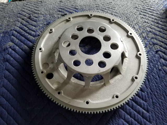

We've just completed the first batch of production flywheels for Lycoming engines. These are machined from 6061T6 billet and are available in either 5/8 or 3/4 inch prop lug versions. Weight is about 1 pound less than the factory Lycoming part. Initially, only 149 tooth ring gear versions will be available.
These will be available with the SDS crank trigger magnets mounted or virgin as you see here. Cost has not been finalized yet but it looks like we may be able to price below the factory and other aftermarket choices currently out there.
Hopefully these will be available for sale in early August.
These are the first parts to be offered under our new SDS Aero Products umbrella also debuting in August with a new logo and new aviation-only direction. You'll see a growing line of new CNC'd bits and electronic EFI/EI controllers for Lycoming, Continental, Rotax and Jabiru engines in the future.
After struggling to keep up for the last couple of years, we finally have enough production capability available to branch out into other areas like this.
We're always looking for customer ideas/ feedback on new features or parts you'd like to see us produce.

What, if any, are the advantage or disadvantages of a lighter flywheel?
This would be cool to have on a new Aero Sport engine, especially if I didn't have to pay for the original one :D
Wow, Those look great.
Lycoming calls them Ring Gear Supports, really not much flywheel effect compared to the prop inertia. Many of the STOL guys want to trim every ounce off the plane possible.
We think a lot of the engine building shops may like these for new builds.

I started making a lightened 360 flywheel a few years back with my trusty Smithy. Just the work I've done made the flywheel noticeably lighter then a stock one. I suppose I should finish it. They do get some weight off the nose.

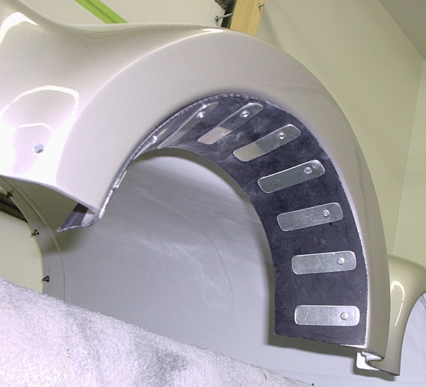

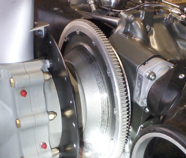

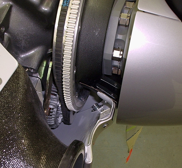

Cooling airpath still ok with lightweight flywheel?
Hello Ross
Do you have any information about cooling, when using your lightweight flywheel?
I remember that Dan Horton made seal that where sealing at the conical face of the flywheel, this to stop there airflow out at the front side of the cowling. With the opening on your flywheel this is disturbed ...
Any possibity to let a this wall there on the lightening holes?
I will look for the thread of DanH.
I imagine Ross could have one made without the big lightening holes in the conical section, but a lot of the weight savings would be gone. If running a prop extension, the foam seal approach seems to work well.
As Dan said, we could leave the large lightening holes out of the machining process to seal things up but it would be only a few ounces lighter than the stock one. The stock one might be a better bet although be aware that new Lycoming engines are coming with flywheels which lack the 12 tooling holes to use our drilling jig for the magnets (also used for prop balancing). Also we found out last week that some Lyc 540s are coming with a dual sheave flywheel which isn't suitable for mounting our magnets either. Further, be aware that the Sky Dynamics ones also can't mount our magnets.
