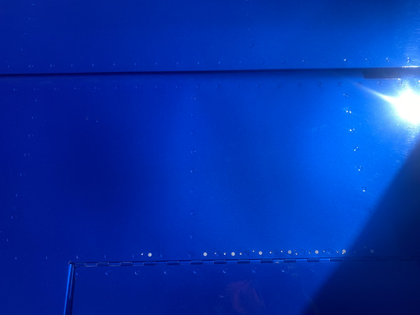

This is what the Van's demonstrator RV-14A's elevator looked like at Oshkosh 2022. Yes, over a year ago.
At the time I was helping assist on the build of an RV-14 tail kit, so I asked why all of the cracks and stop drilling, along with all of the extra rivets. They mentioned the pulsations from the engine caused these and that proseal should be used under the structure. Too bad we already closed up this tail kit!
I took this photo just to remind myself that this area should be checked on RV-14's.
So they’ve known about this issue for well over a year, they modified the plans in June and we are just now hearing about the problem.
