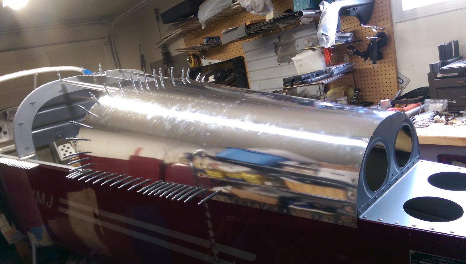

Not much, but a step in the right direction...
Just about done with the left side and just short of a few rivets...I feel like once I get the firewall set and the forward bottom on I can flip it over and start making real head way.
Had some real trials with this stage...lots of tweaking to get her neat and tidy. I had inexplicably forgotten to dimple about a dozen #4 holes! Realized this after the skin was firmly installed on the fuse...:( :(
Had to use some pretty creative processes to get them half good...
You can see the string of #4's on the angle moving toward the firewall are pretty fuglly. Lesson learned.

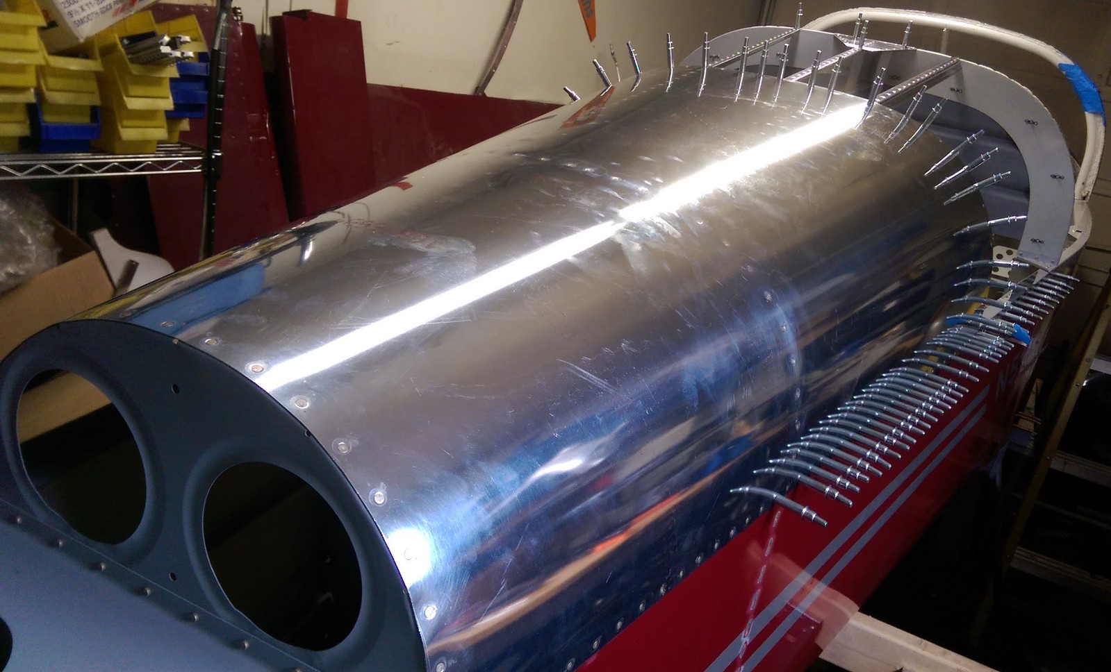

I have a few update pics. Had a vacation and came back, flew a few times on my new Private pilot ticket, awesome and trying to get this bad boy put together correctly. Takes a bit more time when you have to make careful extraction then installation of rivets. Some have gone up to -4's. Not many and the one side skin I saved fit really well at the firewall, almost perfect! Had to add multiple clamps to get it held firm for riveting.
So, I finally got my son Reid to get back in the garage to rivet.
He is not into it...so I have to pay him a little to get him out there. I think he is a bit intimidated at times more than lazy.
See pictures of the progress...

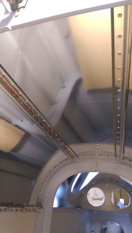

I got started on installing the steps and found the rivet pattern and the initial fit was for ****e. I cresent wrenched the step flange and it was really easy to manipulate. No sure what to do with the rivet holes from PO, might weld up the holes and start from scratch. These steps are going to make movement around the fuse a bear in my confined space...

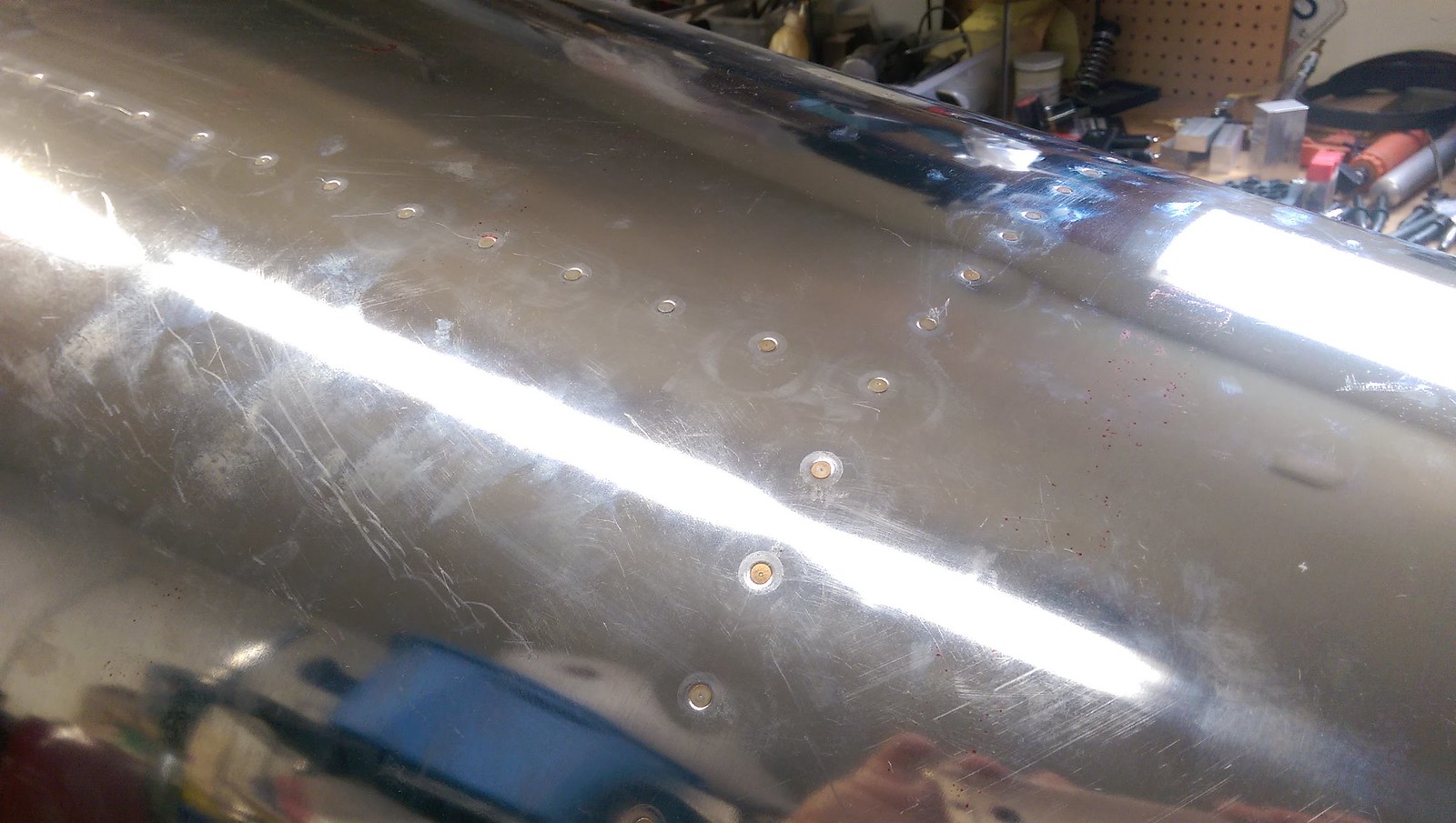

It isn't perfect but it is getting along nicely...Edit: I have realized that I have installed the rudder pedal frames in incorrectly...I had them in and out five times and just well just screwed it up lol!
