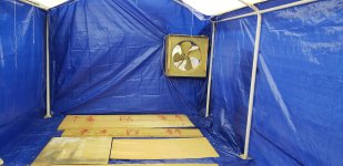

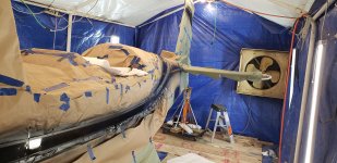

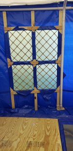

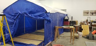

My neighbor has a party tent left over from a wedding that he gave me. A few new pieces of blue plastic, an old attic fan for exhaust, shipping crate plywood on the floor, a bunch of lights and good to go. I made an air intake filter from scrap lumber and such. The cold water bucket was the final barrier to water in the airline. I drained a lot of water out of it.
