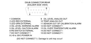

@Bafava, to be frank I'm not sure since I'm in the middle of an engine replacement, and still some wiring left to do.
Here's what I found out to now, no guarantees given ;)
Yes it can be used with the Garmin 3GX, see screenshot below.
I only have the oil level option, so in my eyes will give the electronic intfc power thru pin 8, prob 40 ground thru pin 1 (common?), and signal output from pin 9.

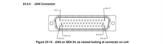

On the GEA24, use one of the available discrete input 40-43.

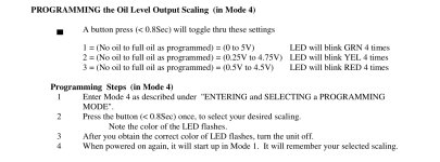

And finally programming using one of the 3 scales provided, not sure which one's the best...

Thank you for info. I had these and to the extend of my knowledge, a G3X discreet can be configured only as ON or OFF (Active/inactive) and does not have the capability of sensing based on voltage or resistance which would be needed to determine the oil quantity.

I emailed the manufacturer Aircraft Extras, and got a super quick and complete answer from Rich, super service, also thanks there :)
Quotes:
Yes, common means ground and vice versa for pin1.
You can take either one of the analog outputs, the oil quantity or the oil temperature, to your analog inputs on any of the EFIS systems. Some of those Garmin systems allow you to actually make a gauge and others may not. I,m not really up on those yet.
I suggest you program the oil quantity sensor one quart at a time until you get to the maximum quarts that your engine manual states. That way you will always see how many quarts your gauge shows in relationship to the maximum oil quantity stated by the manufacturer. Some people use a maximum quart level a little below the manufacturers maximum. I do not recommend that you do this.
If you have an EFIS system, you can set your alarms in that which would be easier Maybe. I just created the alarm outputs on the electronics so that people could use them if they do not have an EFIS. When you are programming your system, just don't program the alarm levels, since you already have an EFIS.
