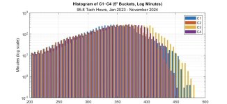

My RV6a has an O-360 with ~800 hours on the engine. It was flying fine, I stopped for gas, and on start up cylinder 3 would not fire.
I spun the prop by hand, and had no compression in cyl 3. Borescope and cylinder removal confirmed that the valve seat had dropped. The mechanic at the shop I was stuck at said this was a rare failure. I am interested if anyone else has had this happen and what could've caused it?
Some background:
It seems like the excessive heat in cyl 3 contributed to this failure. I've been reading about valve recession with unleaded fuel, but unsure if this contributed. How can I inspect for this? Is the drop in compression over 50 hours (during the heat issues) related to this?
EDM 350 data (log plot), from before we fixed cooling.
Some background:
- ~800 hours on engine, I bought the plane at 650 hours.
- This engine has run 91 octane mogas (no ethanol) for 500-600 hours, with Marvel myster oil added to the fuel.
- Cylinder 3 historically has been the hottest. Previously had baffling issues which lead to overheating cylinder 3.
- On take off, it would often hit 450 F momentarily. In last 200 tach hours it has spent ~ 20 minutes at 450F.
- There was an additional carb issue which caused cyl 3 to reach 480 F for a total of 20 seconds over the course of 20 flights.
- Cylinder 2/4 have never gone over 450.
- Cylinder 1 has hit 450 due to an intake leak.
- Cooling issues have since been resolved, now CHTs never go over 420 on take off, cruise at 380ish.
- At 650 tach hours, the compression was 75-76 across all cylinders. The carb issue then occurred causing overheating. We fixed it, and at 700 hours the compression on Cyl 1,2,4 was the same, but Cyl 3 dropped from 76 to 71.
- Leaning has always been done ROP
- Previous owner who ran MOGAS would lean ~150 F ROP
- On AVGAS, we lean 50 ROP
