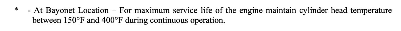

The biggest issue I have seen over the years is not pilots RUNNING LOP, it's pilots GETTING to LOP. You must not meander in the "red fin". Get to LOP quickly (even if it means a temporary rough-running engine) - AKA "the big pull" - and then approach smooth running from the lean side of peak.
That assumes you buy into the red fin mumbo jumbo. Lyc doesn’t. They recommend running at 50 -150 rop or peak, both of which are in the middle of that fin thing. That red fin stuff is a lot like the old over square thing. Unjustified and mostly inaccurate generalizations to create simple rules for folks to follow and a heavy dose of fear mongering. No doubt that peak combustion pressures prior to tdc create stress, but the red fin thing doesn’t really address that in anything close to reality. Ignition timing is a big part and not even mentioned in the concept.
There are a lot of shortcuts I get to take cruising up high. I basically never worry about "red box" or "red fin", even with high compression pistons. If the atmosphere won't give you more than 22" (and often much less), you can't possibly hurt anything. This probably leads to bad habits like never running full rich, ever, and my mixture lever is pulled halfway back even for takeoff (at ~5500). I probably need to adjust the top range of my fuel servo. Mike Busch has said "full rich is horrendously rich" and I agree.
I've been playing around with peak EGT vs 50-100° ROP, and 25-50° LOP recently, and it definitely goes faster with a bit more fuel (no surprise there). I'll spend more time LOP if I can get my GAMI spread down more.

LOP makes a big difference in economy, but not a best speed tool. From all of my research, just going to about 20* LOP will give the greatest fuel economy. You can get a bit better by going much leaner (reducing pumping losses by staying WOT, if that applies in your case), but the gains are small. Simply going from best power (~100 ROP) to 20* LOP will net a speed loss of around 5% with a 15% fuel reduction. I forget the actual numbers, but in that range.
i suspect the LOP scare comes from some instances of pushing WOT and forgetting to enrich mixture beforehand, while at relatively low DA. that could potentially cause detonation..
It depends, it depends, it depends -- However, I think @lr172 is right on the money with posts #74, #77.
However, If you have stupidly high compression pistons (e.g. 10:1) along with a spark at 25° BTDC (really bad), or/and really sh!tty baffling:cooling, or/and sea level ops (+29.92inHg), and you dilly-dally on the pull (read: it takes you > 15 seconds to transition from full rich to peak) -- I can see that creating problem(s).
I should include PV's to the list above -- On my AV, I've never seen CHT's above 370° in climb (1200ft/min - 100kias) --- and I'm in central Texas (read: hot, unbearably-oppressively hot.)
