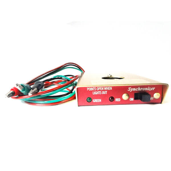

For only $89, I bought this nice little "buzz box" from Spruce and Specialty many years ago, and I'm still using it! Yes--all top spark plugs removed, and all plug wires disconnected (top and bottom). I turn the prop in the normal rotation direction until I hear the impulse coupler "click", then rotate it to the 25-degree BTC timing mark for my engine O-320-D2A timing. Then rotate the prop back-n-froth very slowly until you see the red and green lights and buzzer all trigger simultaneously--sync test should always be done in the normal engine rotation direction. Adjust the mag or mags that are not triggering on the proper timing mark. Remember to go passed the impulse coupler "click" before synchronizing the mags. Note--different engine types time at different timing BTC numbers, so check your specific engine type for proper timing value.

Wow so may spurs to the topic. I use the Eastern Buzz box and just checked my dual Slick mag(s) timing yesterday.
Key off - hook up leads to each mag
Key on, Use 1/16" drill in hole for reference point, pen light to make a shadow to eliminate parallax.
Rotate one rev until lights come on (box check), back up 15 deg (removing backlash) and go slower approaching timing marks, bump prop tip with hand.
Get first light - record, get both lights record positions. Mine was 25 and 25.5 deg, so decided not to try and reset.
I remove the lower plugs and all leads when differential pressure testing followed my the mag timing check.
The whole thing took longer to get the buzz box & leads out and hooked up than to rotate and check the timing. Resetting timing is a repetitive process to get accurately set near perfect.
The shadow technique is just me trying to make it easier.
