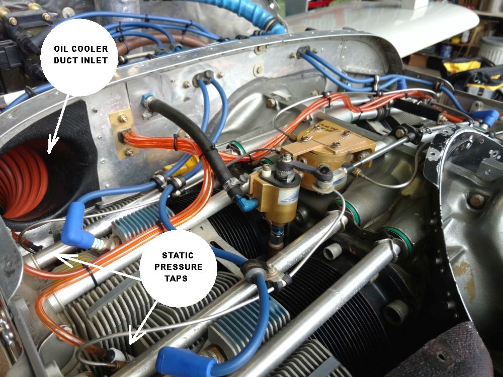

As it happens, I recently rigged my plenum with pressure taps at each FI nozzle location, a story for another time. In the context of stolen air, I thought everyone might like to see the reality.
Below you can see the pressure taps on the #1 and #3 nozzles. They are simple aquarium bubble rocks, the goal being to record static pressure, not dynamic. The taps on #2 and #4 are similar, but note they are on the forward facing part of the head, where the conversion of dynamic pressure to static is a little higher, rather than on the rear facing part like 1 and 3.
Key point here is the location of the #3 tap, immediately in front of the oil cooler duct inlet:

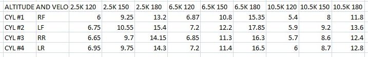

And the numbers, at three altitudes, with three speeds at each altitude:
Note that #3 pressures are not significantly different, and in fact are just a bit higher than those recorded for the #1 nozzle well forward of the oil cooler intake.
