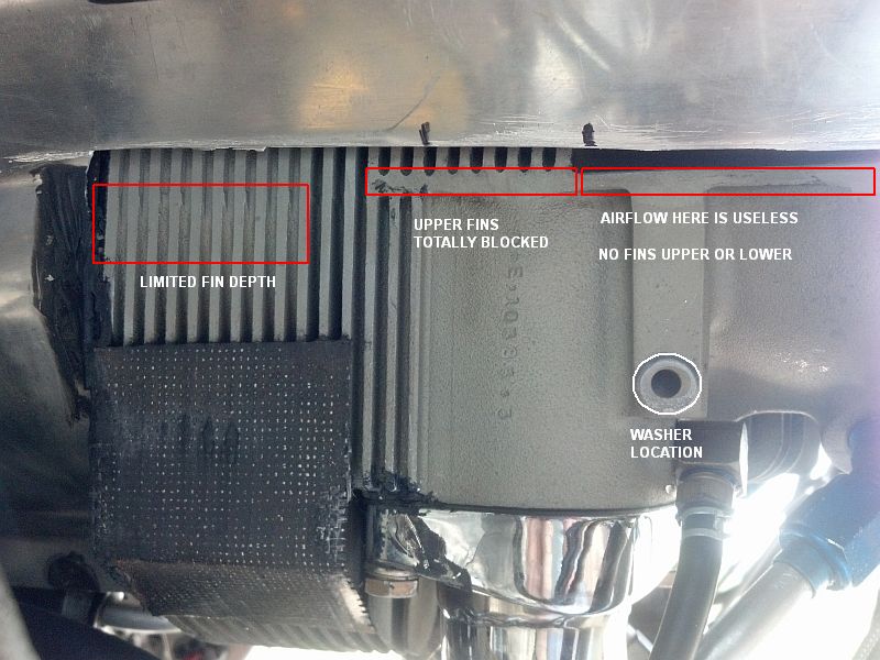

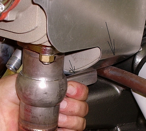

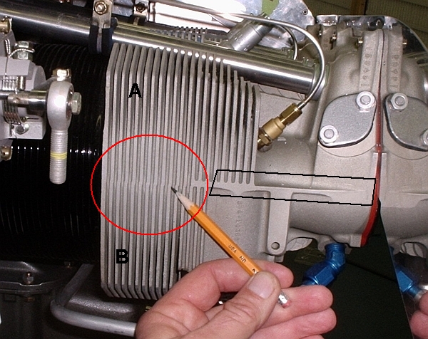

Just to keep this thread going as I haven't totally solved the issue......
The ol' "washer between the baffle and cylinder" trick worked beautifully on the No5 and took 20F off the temperature. It won't work for the No6 because it is 180 out and doesn't have the narrow fins at the back.

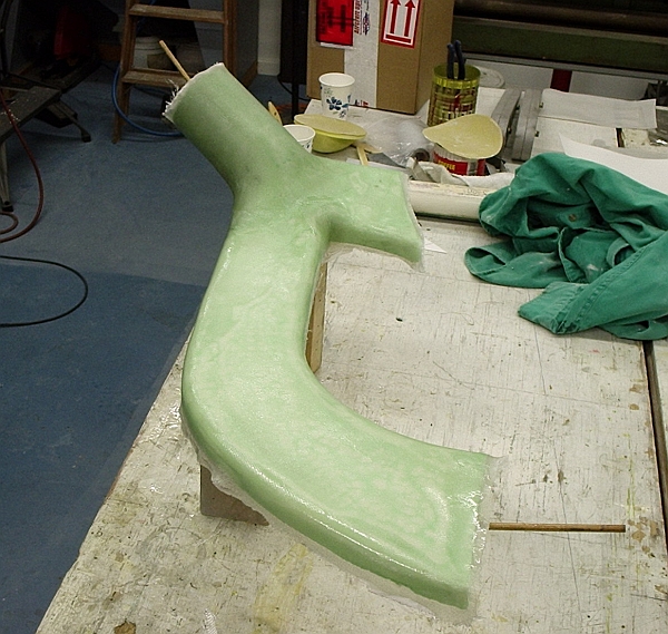

I believe that the issue is the big 4" hole for the oil cooler just above the cylinder taking too much air. Unfortunately, I can't block off any of it as the oil temperature is where I want it. I don't think it is a baffling issue as I can't find any obvious faults with it and the other cylinders are fine.
I have just come back from an air race in Botswana (see www.airrace.co.bw - it's awesome :D). At 21gph, max MAP (about 26" at 4000' DA) and 2600RPM, the CHTs were around 370F except No 6 which hovered around 400F. Oil temperature was 200-205. I feel I could have leaned a bit more for best power and an extra couple of knots but didn't want to because of the No6 temp. I made my handicap speed (173.5kts TAS) but racing is all about those extra knots (Oh, but staying on track and finding the turn points helps.....)
My plan is to fit a 17 row oil cooler instead of the stock 13 row and use a 3" duct. My hope is that the lower airflow through a bigger cooler will reduce the CHT whilst maintaining the oil temp. Before embarking on that expense, I intend to check a couple of other things:

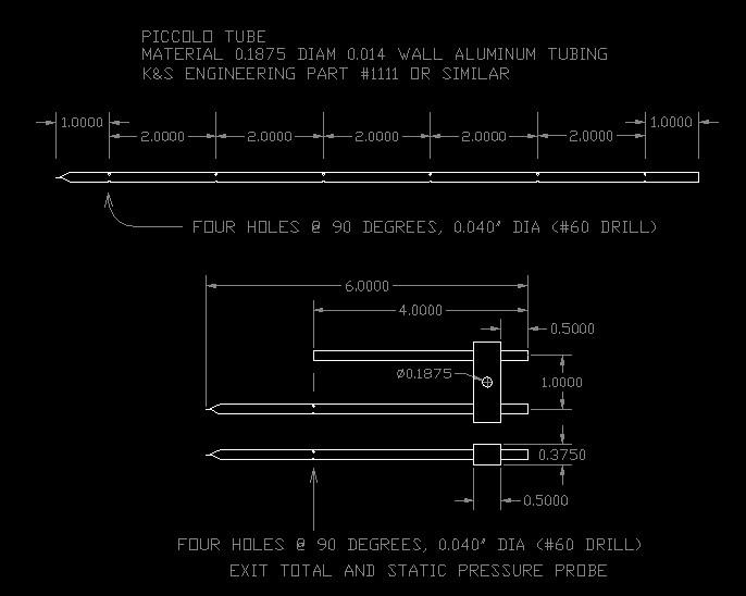

Don't think that plan will work. You'll cut flow area almost in half, but you won't double cooler area.
As for CHT reduction, I'm pretty sure you won't see it go down. However, one good test is worth 1000 opinions, including mine. Make some simple conical adapters (sheet metal, a pop rivet or two, and duct tape) so you can run a length of 3" duct for one flight. Yes, oil temp will be warmer than usual, but you should be able to determine if CHT changes in relation to the other cylinders.

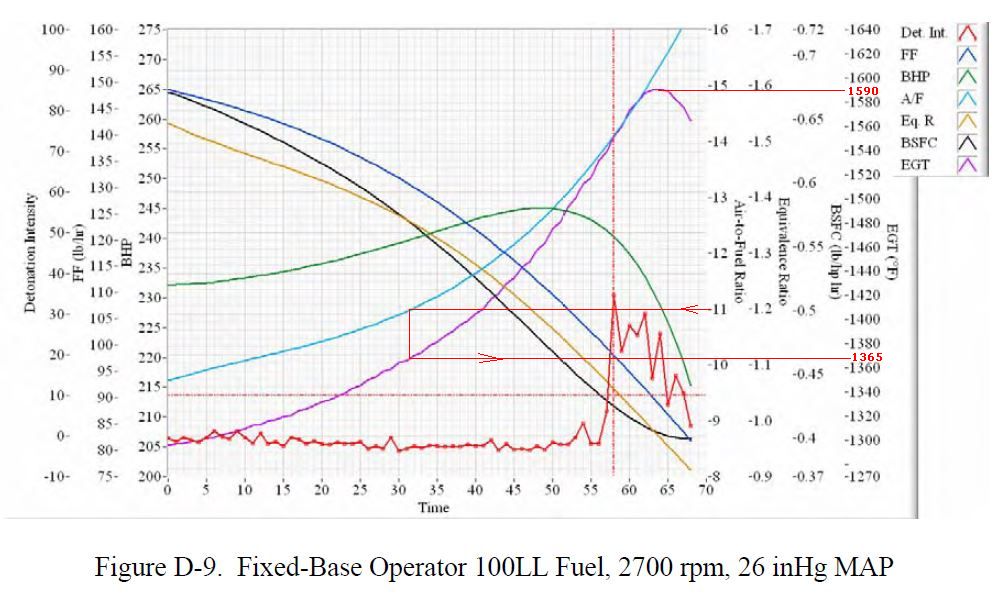

Answer is "maybe". A lot depends on CHT and intake air temperature. An FAA-standard detonation sweep is done with one cylinder at redline CHT, the remainder within 50F of redline, oil at max temp, and intake air at 103F. At full rated power under these conditions, the hot cylinder will probably suffer detonation at only a bit leaner than best power mixture...still well rich of peak EGT.
However, when racing at 4000 ft (26" and maybe 2650), with lower CHT and intake air temp, the risk is reduced. The EAB wildcard is ignition timing, fixed (usually magnetos) or variable advance. More advance increases detonation risk.
A bit of mild detonation won't hurt anything, so sneak up on it. Set desired power while rich, let everything stabilize, then lean a little bit at a time while watching CHT carefully. It will rise as you lean, but if at some point the CHT digits start flipping like a gas pump, richen up or pull off some MP; you just found the detonation limit.
Alternate plan; We know best power mixture will be about 125 rich of peak. Settle in at the expected flight conditions, set 24/2400 or similar, find peak, go to 125 ~150 ROP, and note the actual EGT. Now put power where you want it and readjust mixture if necessary to achieve the same target EGT. The EGT which equates to 125~150 ROP at 70 or 75% will be the same EGT at a higher power setting.

The corrugated interior wall suggests a thick boundary layer, so true flow area is probably less than the nominal diameter, and it would get proportionally worse as the nominal diameter is reduced. A simple intake restriction wouldn't incorporate the effect of the duct walls, which is why I suggested inserting a length of actual 3" scat hose.

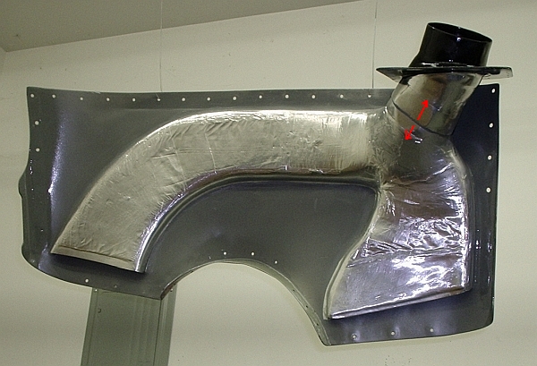

As to CHT, well, been there, done that. It started when measurement found a 16F to 17F difference between OAT and the face of the oil cooler, just down a short 4" duct from the #3 baffle wall. A little bit is compression heating, but most is heat picked up from the upper cylinder fins.
One way to lower oil temperature was to duct the oil cooler air supply all the way from the front of the plenum, just behind the cowl intakes, delivering lower temperature air to the oil cooler. It would also isolate cylinder #3, which would no longer have any of its cooling air supposedly "stolen" by the oil cooler duct inlet. So I built this insulated duct system.
Results: As expected, dropping delivered air temperature improved oil temperatures, even though I'm sure it reduced mass flow slightly (long flat ducts, not an optimum shape).
However, I noted no change to #3 CHT when I installed the above duct system, nor when I later removed it, returning to a flared intake hole in the rear baffle wall. A little thought tells why. The key factor driving air through the cylinder fins is simple pressure delta between the upper and lower cowl volumes. An oil cooler intake near the cylinder may flow a lot of mass, but if it does not reduce pressure in the vicinity of that cylinder, the cylinder's cooling performance will not change. Setting aside frictional duct losses, pressure should be pretty much the same in the oil cooler duct as it is in the upper cowl volume. It has to be. The upper/lower cowl pressure delta is what drives air through the cooler face, just like the cylinder fins. The pressure drop comes after the cooler.
Admittedly, it's an observation and a theory. Confirmation or denial would be to install two piccolo tubes, one over each rear cylinder. One would be near the oil cooler inlet of course. Compare in-flight pressures. If the piccolo near the oil cooler duct inlet is lower by some significant amount, then (and only then) is the duct stealing from the cylinder.

The mixture vs power curve is fairly flat in the ROP region, but there is a little power to gain with careful knob management. Here's an example, a 540K on the FAA dyno at Hughes, 26" and 2700, pretty close to what you mentioned as your race conditions:
Max power is about 245, at 125 ROP (1590 EGT vs 1465). Detonation onset is about 60 ROP, with full development around 50~45 ROP. The difference between heaven and **** is a spread of about 75F.
Remember, this data was taken when real hot, and the K is considered to be a worse case example. You might have a bit more leeway, or less, depending on compression and ignition advance.
First determine if you can run at best power mixture with the CHTs you have now. If so, work on CHT reduction. When you get it down by 30F or so, install a variable cowl exit to reduce mass flow at high airspeed. The restricted exit area will drive the CHTs back up to where you started, but you'll get the 2 knots.

The piccolo below is 12", but 6" would probably work ok, just model airplane aluminum tubing. Or you might try a few aquarium air stones, since you're trying to measure a point source. I just ordered a six-pack of the small ones, as I have some similar measurements on my own to-do list.

Dan, Confused - what are exactly are you proposing to measure? Static pressure is clear, but where and why, to illuminate what? Pressure at each individual cylinder?
BTW-Paul - at these velocities and pressures the compressibility of air is not a factor. It is acting like an incompressible fluid.
Spot pressures in various locations...making a 3D map really. The subject of interest is how the oil cooler duct location might affect the adjacent cylinder's cooling. Since all flow is driven by pressure delta, we could survey pressures at the locations of interest to gain some insight. For example, in Paul's case one might zip-tie a bubble rock to the aft side of the #6 exhaust pushrod tube, then fly the changes in duct opening that he proposed. Since it is now winter in Oz, perhaps a quick turn around the patch with the cooler duct entirely blocked would be possible. It's a parallel valve, not as dependent on the cooler as an angle valve motor with squirts.
I'd also locate one well inside the duct, perhaps at the cooler face, then another on the exhaust side of the cooler. Perhaps another over #4. The bubble rocks come in packages of six, so place 'em all as desired, and run a bundle of tubing back to the cockpit with the ends marked. A fella with a test plan might learn a lot in a few flights with a helper to swap tubes on the manometer and record data on a clipboard.

Dan, could you describe the "cylinder fin flashing problem" that does exist at various levels on many cylinders as a "luck of the draw" issue?
A variation in airflow between the fins right next to the CHT sender location could cause at least an indication of a CHT variance. The other possible variation is flashing on the cylinder side that has minimal depth fins - my old picture from my Tiger -
Sorry, but the Lycoming cooling charts are not wrong...and whatever cooling issues a builder may suffer are not based on luck of the draw.
My only point, Dan, was that there's a lot more than baffling that may impact engine temps. Sufficient fuel flow, proper mixture distribution (especially for carbed engines that are prone to wacky distributions), inlet air vs. exit air, proper oil temperatures, etc. I'm not at all arguing that good baffling is not an important, maybe the most important factor, just that there are other things that can also play into it as well.
Yes, and to add to that, the baffle system execution is one of the biggest variables in the entire RV line. People always say theirs are "sealed", but invariably they are not.
And as long as Van continues to ignore the "zero fin depth issue" with their poor baffle design, we will continue to fight that issue as well.
Address those two fundamental issues, and the "luck of the draw" aspects (casting flash, for example) will become noise level.

Speaking of which, is there a thread on the High CHT subject that has pics of someone installing or the installed washers for the washer trick for the rear cylinders? For some reason I'm having trouble visualizing how this is implemented.
Yes...in terms of what we get off the UPS truck. How it gets installed and flown is builder choice.
That flashing provides an interesting illustration. The average aluminum baffle achieves little more than rough proximity to the ends of the fins, very often not touching them except in a few places, as well as leaving leak paths out the side edges of the wrap. To make things worse, Lycoming inserts rubber combs in the bottom fins, which block the passages even more than flash, and push the wrap away from the fin tips.
Ok, partially block the passages between fins with flash or rubber combs, and where does the air go? Was the problem the flash, or the loose-fitting wraps allowing air to bypass the pinched paths at the flash? If the wraps were really sealed to the ends of the fins, the air would just squeeze through the narrow places...a local increase in velocity, increasing turbulence, an arguable plus.
First fit attempt, my own baffle wrap, cyl#4. Bend at the big arrow is non-existent as the wraps come out of the box, and you can see the gap prior to the comb.
Left front and right rear cylinders. Read here, as well as the links: http://www.vansairforce.com/community/showthread.php?t=93949
Dan, I was actually asking a more literal question-- How is the washer installed between the cylinder and bafflle in the no fin area?
On the mounting screw. Here the screw point is just above my left index finger.
Of course, the washer spaces the tin away from the head at the black rectangle as well as the no-fin depth area in the red circle. Airflow at the black rectangle is just a leak. That's why I referred you to how to make a bypass duct instead.
