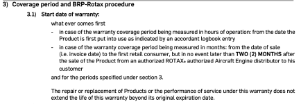

Bob - I’m curious. Wouldn’t this be covered under the Rotax warranty? Including diagnosis and repair?
I can find no actually warranty terms other than :
  • For non-certified engines: 18 months or 200 hours, whatever comes first
That, of course, doesn't tell me when the clock begins. At purchase? At first engine start?
One of the things I'm running into is where to turn for professional advice. I haven't been able to get anyone to return my calls or answer my emails. There's Rotax the company, then there's Lockwood. What's their interest ? Did Van's get the engines from them? Do I talk to Van's. It's all very confusing.
You should be able to get warranty info from one of the three U.S. distributors: Lockwood (East), Advanced Powerplant Solutions (Central), and Motive Aero (West); all of these are under Kodiak Research, the main distributor for the western hemisphere, based in Nassau, Bahamas (the original shipping sticker on my engine crate was from Kodiak).

Unfortunately, I think you're going to be out of warranty. See my screen cap below.
John described the distributor structure well. All of the distributors are fairly busy, some (Lockwood) more busy than others. For all of them, it may be difficult to get immediate attention going directly to them. I would not expect Van's to be in a great position to support the engine, and they seem to have a supply chain that is outside the 'Big 3' and I would expect warranty and support to defer to one of them.
It's unfortunate that you can't get a local tech to respond. Your local tech would have been through training and probably has a relationship to leverage for the more difficult questions. I know that if you were local to me and I could be hands on with the engine, I would be able to get through to Motive if there was a need for more support.

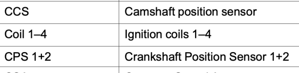

I’m sorry. AAPTS is that air box plug. CPS is the crank position sensor. Marked with a pair or dots or a yellow stripe depending on the vintage of the engine. They are removed and routed around the mount during installation and can be installed reversed.
Crankshaft position or Cam position sensor? I'm not familiar with how Rotax does valve position sensing.
The connectors I am recommending a look at are crankshaft position sensors, CPS. There are two and they are removed during installation. Cam position sensor is referred to as CCS.
As you can see from my original installation notes, the CPS 1 out of the box was connected to the middle connector as depicted in the Van's figure (which comes from the Heavy Maintenance Manual). BUT, the only yellow mark was a single yellow dot on the wire (not the connector) on the bottom connector. According to the Heavy Maintenance Manual, the yellow dot indicates the connector for CPS 1.
Curiously, my notes seemed to indicate a wire had two dots and THAT was connected to CPS 1. But today I could find no evidence of two dots.
Hmmm, what to do. At the time, I decided to make the connections as they were out of the crate.
Today, I swapped positions and attached the CPS1 to the connector whose wire had a yellow dot.
It made no difference when starting the engine.
Now, I'm not really sure what configuration these wires should have . I'll have to research where these wires go after that connection point and figure out which one is which.
