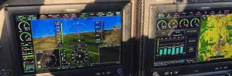

The indication of the Power Setting in % on the G3X Touch seems to indicate 2 % less vs the Power Chart
The engine is an IO-540, leaned to best power
-see pictures attached
-any idea why it's off? The difference seems to increase a bit with higher power settings.

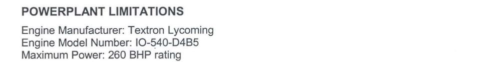

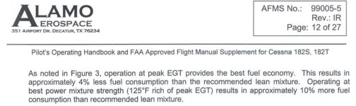

Below is a screenshot from a C182S AFM Supplement with an IO-540-D4B5 engine
It suggests a difference in power of about 3% between 50F ROP and 125F ROP (I'm not debating if flying 50F ROP is the right thing to do)
So moving the mixture from Best Power (125F ROP) to 50F ROP should display approx. 3% less power.
On my G3X T I don't see any change in the displayed % power while leaning from Full Rich to Peak EGT.
