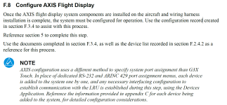

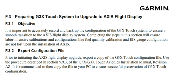

Question regarding the upgrade process. The instructions state that one should export the configuration to a file from the G3x Touch before removal, but does not give instructions to import into the new AXIS screen. Is an import an options or will one have to manually reconfigure for example all sensor and other data?

My main concern after that, is the set up. Is there a method for transferring all of the data, set up and features on my current 460 directly to the AXIS or should we expect to start from scratch?
See the AXIS Installation Manual, Appendix F, starting on page F-17. You'll find the whole process spelled out for you there:

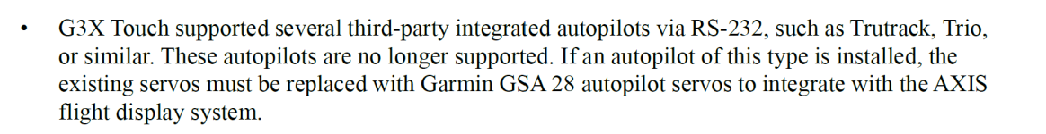

FWIW the Trutrak Vizion servos fit the same brackets with the same hole patterns as the Garmin ones, in my experience.
