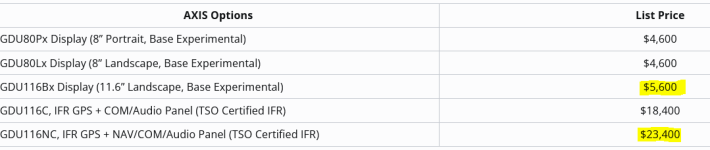

Literally from the G3xpert post? You have always had to buy a "certified" navigator to be legit IFR.
Display Pricing
AXIS Options
List Price
GDU80Px Display (8” Portrait, Base Experimental)
$4,600​
GDU80Lx Display (8” Landscape, Base Experimental)
$4,600​
GDU116Bx Display (11.6” Landscape, Base Experimental)
$5,600​
GDU116C, IFR GPS + COM/Audio Panel (TSO Certified IFR)
$18,400​
GDU116NC, IFR GPS + NAV/COM/Audio Panel (TSO Certified IFR)
$23,400​

also - your list price says the GDU116Bx is $5600 but your examples say $4980, which is accurate?
Edit: I may have answered my own question @fl-mike called it above. These are just napkin numbers i've pulled from websites and may not be complete, but it sets a clear winner.

For a new build, I have GNX375 on hand.
Would you recommend keeping that and buy 2 x GDU116Bx + Audio Panel + Nav/Com + Com?
Or just sell it and buy your IFR Example, but would need to add a second Com and Transponder.
The display pricing table is List Price. The price listed in each example is the Minimum Advertised Price. You will need to discuss pricing details more in depth with the Garmin dealer you order your equipment from.
