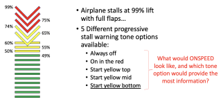

You can adjust the onset point of the tone, and the setting that gradually increases the rate I find useful to let you know you are approaching the high AoA condition like when tightening the turn for a short approach. Not as good as the "on-speed" system discussed at length on the forum but better than a straight stall warning. I rarely look at the chevron display on the EFIS.

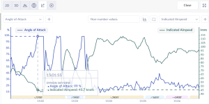

This is how my Dynon AoA behaves after I calibrated it. It doesn't beep until the plane is almost at touch down. It's more like the analog stall vane where the buzzer sounds when you are at the flare
I tried to zoom in on your EFIS in the image - looks like approach speed is OK….but yes, your range from the onset of AoA tones to stall is very narrow - I’d try a re-calibration. I don’t have any Dynon reference material at hand, so can’t remember the exact procedure, but I think you can control the onset point to be at or slightly above your Vref - then you should have a slow tone for approach. You’re right thatwith the current Calibration, it’s not as useful.
Hey - its an excuse to go fly and experiment!

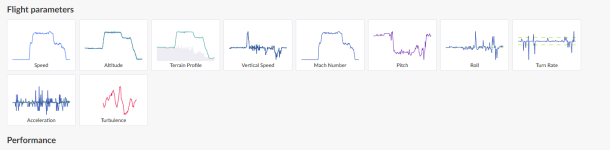

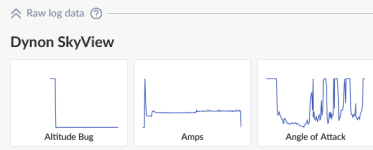

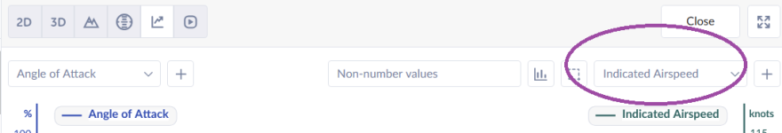

This isn’t my airplane but I found it from YouTube that shows the similar AOA behavior that I see in mine. I found some additional calibration adjustments in the menu so I will try to experiment with them this weekend. Thanks

After the previous post, I went up and re-calibrated the AOA again. The Vs was the same as before. I readjusted the software setting so the initial tone will come on at the earliest time. Yet the tone from the Dynon comes on very late. It will start beeping at at 1.10 x Vs for my airplane, a very uncomfortable speed for anything except close to touchdown.
Exactly. The settings allow you to adjust when the tone starts, but the "earliest" setting is 50% AoA. And before I altered it with the new CONFIG file, the system had the break of the stall at 70% AoA instead of 100% as logic would suggest. After loading the new CONFIG file it now shows the stall at 100% AoA (Data gleaned from exporting the user-log-data file). After the fix, with the initial tone adjustment still set at the minimum (50%), the tone comes on right where you'd want it to, just about exactly 1.3Vs. Why they don't set it up to do that as the factory default, I can't figure. And my very helpful contact at Dynon did not know either.

If you want the gradual beeps to come on sooner (like an approach speed in Paul's video), but keep the full stall tone at or just before actual stall, check out page 4-22 of the install manual; SETUP MENU>SYSTEM SETUP>AUDIO SETUP. The AOA can be set to begin alerting sooner (or later). Not sure why it isn't explained better in the manual or referenced in the AOA calibration area. It's been a couple years but I recall changing the 80 number to 65 or similar. I had to try several different numbers before I got the tones to begin just where I wanted but it worked okay and retained the full stall tone at the correct AOA.
Also, there is another setting at the same menu to silence the tones below a set airspeed. Use this to prevent it continuing to alert while you are rolling out.

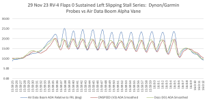

One point to ponder is that when comparing AOA indications (even with the same system) from airplane to airplane (even airplanes of the same type) is like comparing indicated airspeed values--both will vary as a result of calibration. This is one of the primary short-comings of a field calibration: it is difficult to replicate results consistently. This, however, doesn't lessen the value of AOA for stall avoidance but it may limit the utility for deriving any performance cues (say approach condition, etc.) from displayed data or tone. When calibrated, a differential pressure system should reliably detect stall even in edge cases (ground effect, high sideslip, etc.) since the coefficient of pressure (the difference between the pressures adjusted mathematically) will always peak at stall. This is what the system is engineered to do: provide progressive stall warning. This doesn't mean the derived AOA solution is accurate in the sense that it's measuring 100% fractional lift (in the case of the Dynon) or actual AOA or body angle in degrees. But again, to emphasize, if calibrated, the system is doing what it's designed to do: warn the pilot of impending loss of lift.
First, let's consider an edge case. I demonstrate this by putting the airplane in a condition that maximizes side slip and allows a sustainable oscillating stall condition to occur. That's a fancy way of saying I stall the airplane at very short intervals (less than 2 seconds) in a sideslip. The takeaway from this demonstration and plot is to note that even when we challenge the sensor, the physics of using differential pressure to detect stall works. In the video note that reliable stall warning occurs prior to stall (loss of stability). This is NOT the Dynon AOA solution driving the tone, but it is a Dynon sensor. All coefficient of pressure AOA systems share this characteristic. In other words, if you calibrate you can have confidence in your system:
Again, the takeaway from the demonstration is that the system accurately detects stall. What's interesting is that the condition is so dynamic, I couldn't tell you what the actual AOA accuracy is; but it doesn't matter. The system detects stall and provides warning. Here is a plot of AOA and sideslip data during the demo:
This first plot shows three different AOA solutions, the red line is the solution using the Dynon probe, the green line is the solution using the Garmin probe. Again, not the Dynon or Garmin AOA system--just the probes, both mounted in the same flow field under the left wing at about 25% chord:
The big takeaway from the first plot is that all three sensors reliably detect stall. There is variability in magnitude (stall angle) and some variability in frequency due to the difference in shape of the sensors and the length of tubing from the pitot/AOA to the pressure sensors. Since measured stall angle is approximately 20 degrees, it appears from this plot that the pressure-derived systems are doing a better job than the boom mounted vane, which is likely subject to inertial effects mounted on the left wing tip. This is also the case in ground effect, where actual critical AOA changes due to upwash effect. That is one of two conditions where that is the case. The other is at extreme pitch rate change, which may be the effect occurring at the alpha vane on the boom. Any time the airplane rotates rapidly, the CL/alpha curve extends momentarily, and you can actually exceed critical AOA without stalling; but there is no free lunch, and the air molecules catch up quickly :rolleyes:.
This next plot simply compares the pressure-derived AOA solution to sideslip angle (engineers call that "beta", just like they call AOA "alpha"). Note that the stall is occurring with about 20 degrees of sideslip:
OK, now that we understand that a pressure-derived AOA system will reliably detect a stall if it's calibrated, let's look more specifically at the actual Dynon system. One of our early experiments was asking 10 folks to calibrate their Dynon AOA systems using the same system in similar airplanes and the manufacturer's instructions. The punch line is that all ten calibrations varied, which is exactly what's happening to folks in this thread. The takeaway is that all ten calibrations accurately captured stall, but if you were to compare visual or audio indications, they varied from airplane to airplane.
The first thing to understand, is that the Dynon AOA is a fractional lift measurement, it isn't computing AOA (or body angle) in degrees. When a wing is producing no lift, the fractional (or percent) lift is zero. The wing produces 100% lift just prior to stall. Thus, we can express the "CL/alpha" curve as either a fraction from zero to 1, or simply as a percent. This is just as effective as deriving AOA in degrees. As a matter of fact, a couple of key performance parameters are easily expressed as a % lift: maneuvering speed, stall warning, on speed and L/Dmax ASSUMING the system is accurate enough and has sufficient amplitude of usable AOA signal to do so. The Dynon % lift signal may, or may not meet this requirement depending on the airplane (see the example of the SeaRay above); and, as I said, it's not engineered to do so. It's engineered to provide progressive stall warning.

Looking at my own data it seems that AoA peaks at about 45.7 kias and the break is at 42-43 kias. I do hear the steady "stall" tone slightly ahead of the actual stall.
I'm not yet clear on how to configure Dynon so that the initial AOA slow "chirp" starts at the ON SPEED condition. That would make the Dynon aoa feature a lot more advanced than just a stall warning.
a screenshot from flysto (what a great site!):

We don't have a decoder ring for the Dynon display, but based on some very old data, it appears to work like this (BTW, that would be a great question for the Dynon engineers to answer, if they are so inclined):
We THINK (heavy emphasis on think) that the display works as shown on the left. In a perfect world (i.e., the system accurately captured zero lift to 100% lift), the display makes good sense: L/Dmax would occur when the lowest yellow bar was lit, and on speed would occur at the bar/chevron display. But, in this example, we aren't working with 0-100, we are working with about 25-100, so on speed occurs somewhere between the bottom and upper yellow V lit, and close to start yellow mid for audio cueing. So that's what we'd look for on approach. If you are down to a single (upper yellow) lit, you are definitely on the slow side of on speed (back side of the power curve).

At the WOT level flight Dynon log shows 9-11% AOA. this varies slightly depending on the power/lean settings and DA, and probably dependent on the calibration data as well.
The Alert data file logs each time the audio tone comes on. These are marked in the alert description column as AOA_NN_16, NN from 01 to 16. It looks like 01 is the continious stall tone, and 16 is the slowest chirp. So it's possible to derive the AOA of the onset tone for any given airplane
The last piece of the puzzle may be the instructions on how to set AOA_16_16 alert to start at whatever AOA we belive is the ON SPEED condition. Right now it looks like 3 choices are available in the Skyview. Mine is set to start at the yellow/red border and I guess by sheer luck this falls close to the ON speed calculations above
May be we are looking an option to set the starting tone to a specific AOA %, and a thechnote on how to determine this value using the data logs. This does look like a somewhat advanced technique :)

I noticed that the AOA % can jump very rapidly with just a small change in IAS especially when close to stall. overlaying the AOA and IAS data on a chart in flysto can take some of the guess work out. It's very easy to do: after opening the flight, click on the graph icon, select Raw Data/Angle of Attack
Then add IAS to the right Y axis.
it helps if the recording is at 1sec intervals
I don't see the AOA in Flysto, but I see it in the Savvy data. Is there any setting in Flysto to record the AOA data?

The Dynon display would be impossible to fly onspeed. It is a yellow bar in the 60% lift region.
I would be hard nail that indicator due lack of unique differentiation. I am guessing the sound lacks differentiatetion too.
What onspeed gives us is a safe maneuvering speed on approach.
with the full flaps my AOA wakes up at about 52-53 kts which is 10 kts above Vso of my RV9A. I cross the threshold at 60kts and never hear the AOA until in the flare. Curious if 60kts is too fast and i should slow to hear some AOA chirping on short final instead of just during the flare.
It would be nice if Dynon could add some sort of on-speed tone that sounds distinct from the stall warning to aid flying the approach at the proper speed until runway is made.

Paul is being polite, and spot-on with his observation regarding standardization. I'm not a formal member of that committee, but I do serve on another EAA safety initiative that is developing resources for reducing risk during power-loss on takeoff and initial climb. I chime in on a thread like this for educational purposes, sharing what we've learned in the last eight years.
I agree with your assessment. We gave up experimenting with Dynon as an AOA signal source as we learned more about the system, and civilian AOA systems in general. They are designed to be stall warning devices for the most part, and all depend on some sort of field calibration. To beat a dead horse: calibration will vary, and with it, any indications or tones driven by the system. That's why we are developing automatic calibration--and taking the physics out of the pilot's hands. That means that if you fly the on speed tone in an RV-4, it's exactly the same as flying the on speed tone in a J-3 or Lancair. Actual AOA and airspeed will, of course, be different, but the condition and how you apply flight controls and power to react to the tone will be identical. That's as much standardization as we can hope for. I originally naively thought if we simply demonstrated how we did business in the military it would just translate. My RV-4 flies just like an F-15 with a prop and bit less horsepower, and airplanes are airplanes...but alas no. And other than a variometer in a glider, the concept of flying a tone is alien to GA--so much so, we just call it "green eggs and ham syndrome."
When we developed our own hardware and software, we utilized two technical papers prepared by the FAA. One dealt with the physics of accurately measuring AOA using differential pressure as well as various normalization techniques and second was an evaluation of ten commercial systems. The second is an excellent read, and became our "requirements document" by highlighting how we needed to approach engineering to avoid short-comings detailed in the report. The FAA TC server isn't currently working, but we keep a copy on our website: DOT/FAA/TC-18/19. It's a technical read, and the systems are de-identified, but it presents a great over-view of "what's out there." That is not to construe that there is not a benefit to adapting AOA: any AOA system (that's calibrated) is better than no AOA system, purely from a stall awareness/prevention stand point. And there are different ways to skin the AOA cat.
