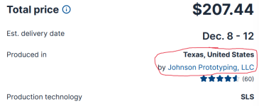

Since I originally started this thread 5 years ago, I thought I'd go see how much these parts would cost today. My favorite 3d printing broker today is craftcloud.com and their offer (from a vendor in Texas), is for $207 shipped. That's about 50% cheaper than 5 years ago! I just had Johnson Prototyping make some plastic parts for my Sling A/C project last week and they are very nice, so I can recommend them.
This is for SLS nylon-12, which materials property-wise is about equivalent to the HP-MJF process, and is what you should be using for an "underhood" application like this which will get hot. I'd stay away from FDM or other hobby printers for an end-use product here.
I was just looking at craftcloud last night. Which vendor in TX were you considering? I want to buy from a US based company
Since I have a printer (Bambu Lab P2S), I'm also considering printing the parts myself using their PPA-CF filament. Any thoughts about PPA-CF?

Mark, I don't have any recent experience with FDM printers, so I can't say yea or nay. That material sounds good, but the problem with FDM is strength in the Z axis due to how the part is made in the machine.
It's probably not a safety-of-flight deal if the part broke, so why not try it on your Bambu? If you do have a concern, you could always apply one layer of thin fiberglass to the outside of the part to hold it together... but that mostly defeats the convenience of printed parts. Could also carry a roll of aluminum duct tape in your toolbag to do field repairs.

That's a commonly stated issue with FDM, however it really needs to be kept in perspective with the filament. The described material, PPA-CF, has a X-Y axis tensile strength of about 168 MPa and Z axis tensile strength of about 57 MPa; you multiply MPa by 145 to achieve pounds-force, meaning if the part is printed and annealed properly, the strength will well exceed the application need.
I've used a version of PPA-CF for several parts, including my intake ducts, which is about as strong as fiberglass in the Z axis and stronger than fiberglass in the X-Y direction. My own tensile strength testing using a standard specimen resulted in me not being able to break the part with my test rig. It's well strong enough to route air at temps far exceeding FWF temps, unless of course you're on fire - in which I case I'd actually prefer less incoming air.
FDM printers can make parts with safety and strength in mind, just need to be mindful of the filament and printing orientation with regard to the stresses that will be applied in service.

And that's why I keep preaching to use SLS or MJF process with PA12 material in an underhood application which gets hot.
