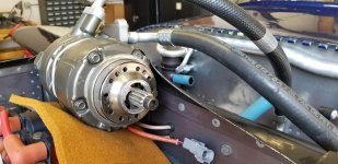

That is a tiny compressor, is it driven off of the accessory drive? I looked up the name and he got a prize for the design. Any way we could get some pictures of the components installed?
I did take a picture, but only of the top cowl removed. It shows the compressor and the plumbing heat exchanger (round silver tubing under the top cowl hinges) which, if I recall, accounts for significant efficiency gain. Hopefully, I'll do the pic upload correctly for it to show.
PS-I did ask permission to show this pic.

Compressor off of engine accessory case? That is a lot of load on the gear train. Also what if compressor seizes? I assume it has a fused coupling.
It's actually less overhang moment than the bigger vacuum pump-mounted aux alternators. Torque and overhang are less than allowed by the Lycoming TCDS. And there's a frangible element in the coupling to protect the engine if compressor failed.

Can you elaborate on the clutchless compressor? What kind of load does it apply to the engine when A/C is not required? Is there some way besides a clutch to cycle it on and off?
After witnessing PlaneKool in operation, I looked into the type of compressor that was being used. It is known as a clutchless, variable displacement compressor. It is Very common in automobiles. If I understand it correctly, it is spinning continuously. Its operation and thus true load on the engine is controlled by the refrigerant pressures in the cooling circuit as determined by the demand for cooling. This is where the 'variable displacement' function of the compressor comes in.
To add to Radioflyer's comment: the compressor is an axial 5-cylinder with a variable swashplate, controlled by a PWM signal. PWM width determines swashplate angle, which determines the actual displacement. With no power to the compressor, the swashplate goes to 1-2% to maintain a tiny bit of pumping for oil circulation to keep the compressor lubricated. You can spin the shaft by hand in that condition, so no detectable load on the engine.

Interesting, I can see some real advantages for variable swashplate compressors, for example, soft starting a RV (Camping) type air conditioner.The starting inrush current would be reduced allowing it to operate on a much smaller generator.
