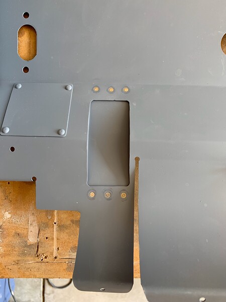

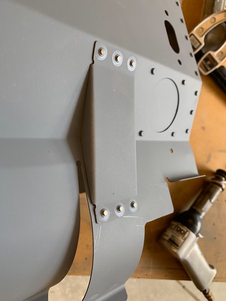

I went with a mini-duct per a later DanH post ..it was easy to make and gives more cross sectional area for the air to get through. YMMV, but my #3 has no cooling issues. I did a similar thing on the front of #2, tucked behind the IO-360 snorkel. The only cooling mod I had to do after break-in was to remove the dam in front of #1.
(photos prior to sealing with RTV)

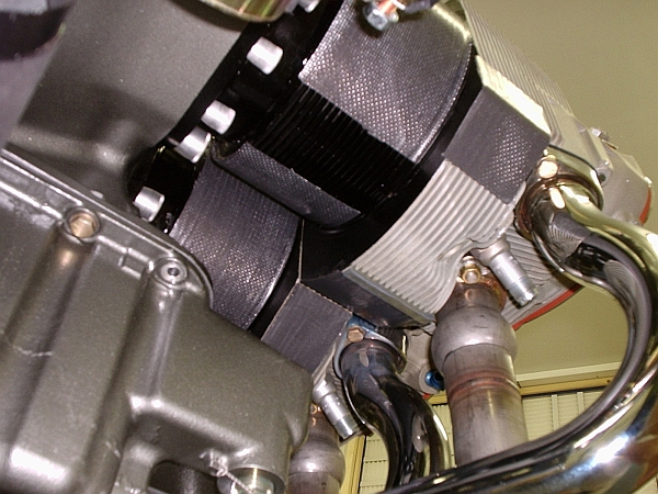

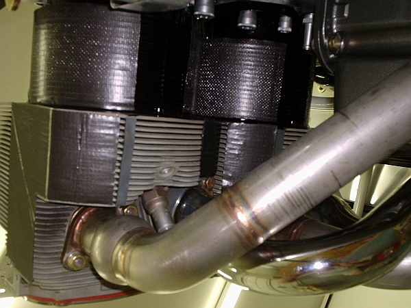

My CHT issues weren't terrible on #1 and #3, but in level flight my #2 ran hot compared to #4. I did a similar mod to the front of the baffle on #2 and it cured my temperature imbalance with #4. Now they are within a degree of each other. I wrote up what I did on my blog.
Bill, This is the exact mod I used in 2015.
Here are the flow areas based on the starting gap at the centerline (.4") then below, as the head wraps around. The chute above has .20"+ at the centerline and has the flow area plotted in post #56 above. 8 fins (1.9") is about the max there are 8 fins that get deeper down to the bottom. The other fins remain constant as they are limited by the exhaust port. The chart plot for .063 is the flow area for a washer. Note the area difference for the chute. I ran no temperature data for the difference, only present the area comparison.

Bill, This is the exact mod I used in 2015. A template is posted somewhere here for it.
Here is the flow areas based on the gap at the centerline and below as the head wraps around.

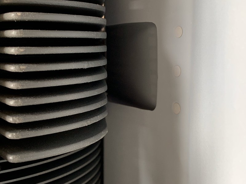

It looks like the cleanup on the cylinders after the casting could have been better.
Is there any reason not to remove what looks like it shouldn’t be there?
I think a bypass duct is less risky then touching a cylinder. I think the price of a Lycoming is about the same as a Ferrari engine. JMHO
