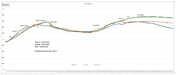

After a flight, my under-cowl temps will hit about 180° F. IMHO the only problem that those post-shutdown temps cause is that the fuel temps can lead to difficult hot restarts on a hot day (an example would be landing to refuel, or 5-7 Young Eagles flights). More important to engine health is the condensation that will form in the crankcase as the engine cools. My routine for managing the hot restart issue is a 12v muffin fan as a vent fan on a timer plugged into my battery-maintainer connector, that I put in the oil door. Not necessary if it's just going back in the hangar. My solution to venting the crankcase condensation is an engine dehydrator blowing through the dipstick tube. Doesn't have to be high volume, just positive pressure.
The vent fan (Amazon) is kind of high-speed noisy and does draw attention from people walking by if parked on the ramp. Only runs for 1 hour. Current draw is minimal.
