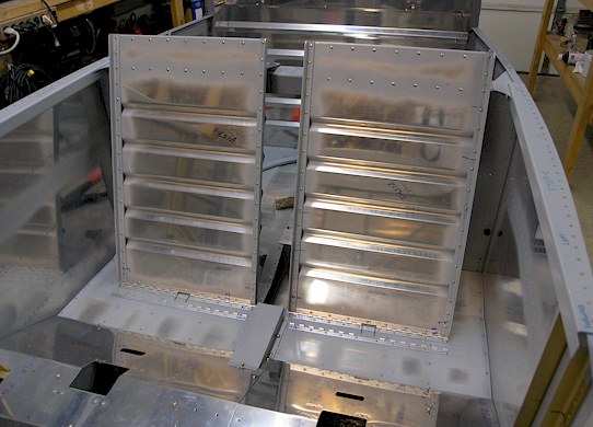

Nice! I'm hoping to get there myself this weekend - I've got 3 days all to myself, and finished my wings last night. I've got all the bulkheads built and I'm at the point of assembling into larger pieces.
It goes pretty fast!
It goes pretty fast Greg, I solo bucked every rivet no problem. The last 2 bulkheads were a real pain to get in and aligned. I just thought the tanks and leading edges were a pain:(

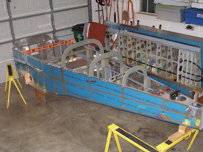

Hey Don - it's hard to see from your photos - the bottom 4 J-stringers on the rear fuse section, are they notched on BOTH ends to go under tabs in the 712 and 706 bulkheads? The instructions show only the rear ends of the stringers getting notched, and that's all I've done so far - but the 706 bulkhead sure looks like those tabs are meant to have the J-stringer notched and run under them, and the stringers are too long (by just about the required amount) to allow me to assemble the 711/712 bulkeads into place. I'm thinking I need to notch the front end of those stringers as well, can you confirm?
*Update* - after looking at the situation some more, I went ahead and notched the fore end of those J-stringers and now it all goes together just happy-happy. If I find out later I screwed up, all it will cost me is a new set of J-stringers, no major loss.
Yes!
Greg, yes they do get notched and inserted between the bulkhead and the skin. The instructions suck here. The plans show the angle to cut on the stringers, tried one and it fit like ****. Ended up custom cutting every one of them.

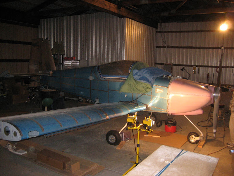

Recently passed both milestones. Here is my photo entry for the RV-9(A) fuselage club!
N858JK is Airworthy
My DAR, Bobby Thomas from Laurel MD came out to hanger 17, KXSA, at 0800 hours this past Friday. By 1130 hours, RV-9A, N858JK was airworthy! 971 lbs empty weight with an ECI O-320 and a fixed pitch, wooden Sensenich prop. The panel is day VFR with a Dynon FlightDek D180, Garmin 496, SL-30 and GTX 327 stack with a PS Engineering intercom. 3.5 years, 2100 hours of build time. 50 mile radius around KXSA for my Phase 1 testing.

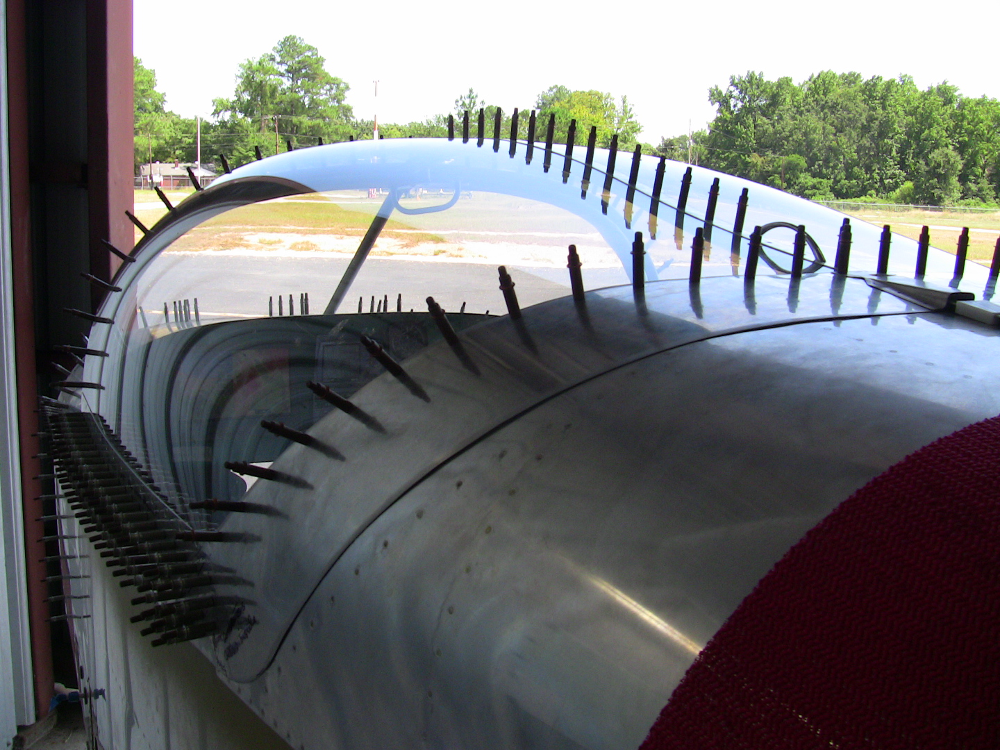

Today is my builder number day - 90709 - and I am not finished with my project. I always joked since I started in 2003 that I hope I would be finished before my builder number became the date. Oh well, I am trying to finish up my slider canopy:
I think I see some light at the end of the tunnel...

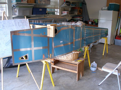

Making progress again as the divorce proceedings are getting straightened out - should be final in about 6 weeks. Man it feels good to be back in the shop...
Last night I got the aft fuse and center section mated up - it ain't "rolling the canoe" yet, but I'm getting closer!

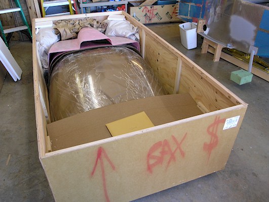

Finish kit is here!
On Friday, I called the trucking company in my home town about the status of my kit and they said
"Oh yeah, it's been here in our warehouse for couple of days now. We should be delivering it by Tuesday next week."
Being the impatient person I am, I said "How about if I come get it myself on Saturday?" Then they said "no prob!".
So I rented a U-Haul and picked up the kit. They were gracious enough to knock 60 bucks off the delivery price.
That payed for the U-Haul truck. Here it is sitting in my garage.
It measures 97 inches by 49 inches, and is 27 inches tall. It weighs 337 lbs.
Christmas in October!

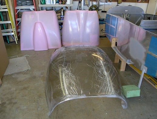

My canopy and windscreen are done.

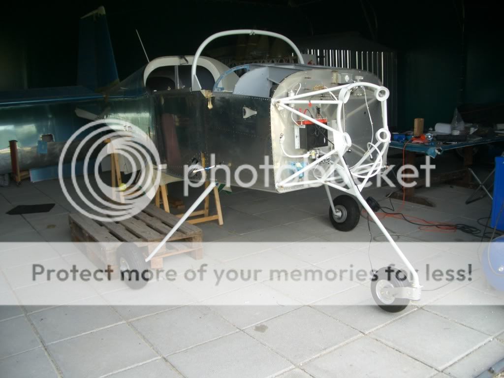

I don't have any pictures loaded to the computer yet, but I am just about ready to prime the horizontal stab. I've been working at it for about a month and will post some pictures in the coming days.
We're almost done fitting the cowling. I've been pretty happy with the fit. It will require some glass work later to make the inlets line up properly, and I'll need to glass in the bumps on the upper cowling for the H2AD's governor and fuel pump mounts.

I've been remiss in not posting any pictures of my progress. Finally got the wings on for the first time. I've got about 2' of room to spare in the garage.
