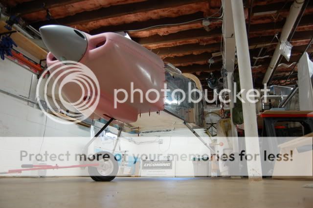

I hung my engine on Friday!
It sure was easy since I have a conical mount. It's a "pre-owned" (as the car dealers say) O-320 B2B "Frankenstein". I call it that because I swapped out the sump to move the carb forward to clear the nose gear.
I will be removing at least two jugs so that I can perform a rattle can overhaul on them. Plus, those red valve covers will go away.

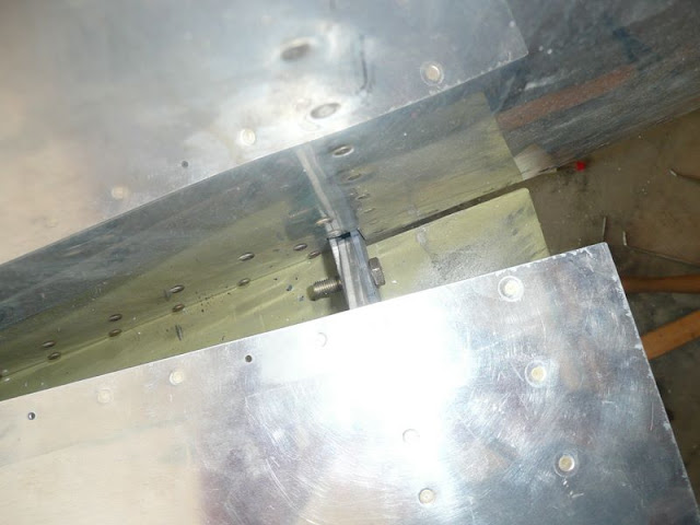

It was milestone day for me, I just completed the rudder... (well sort of).
Because we still have pre-close inspections, here in Canada, I left one of the skin unriveted to the ribs, left the top rib unriveted, left the trailing edge as-is.
I could have rolled the leading edge but if I need to replace rivets along the spar, I will be easier this way.
The last image was taken by my brother using his cellphone... sorry for the quality ;) As you can see, I've been using a free room in my basement to store the finished parts. Having a small 1 car garage has its disavantages.

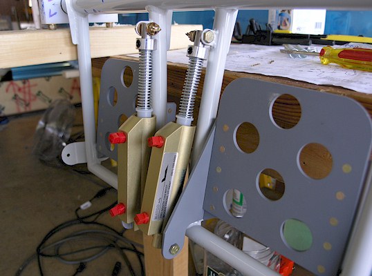

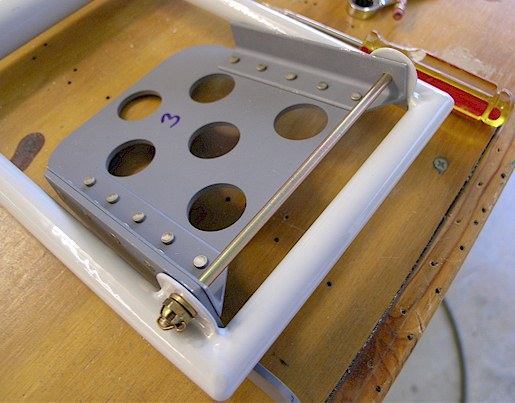

Rudder and Break Pedals Done!
This was a bit of a brain teaser, but I gotter' done! Thanks to everyone who helped me out with this part!
Long bolts in the backend:
Springs on the master cylinders:
Everything in place:
More details here.

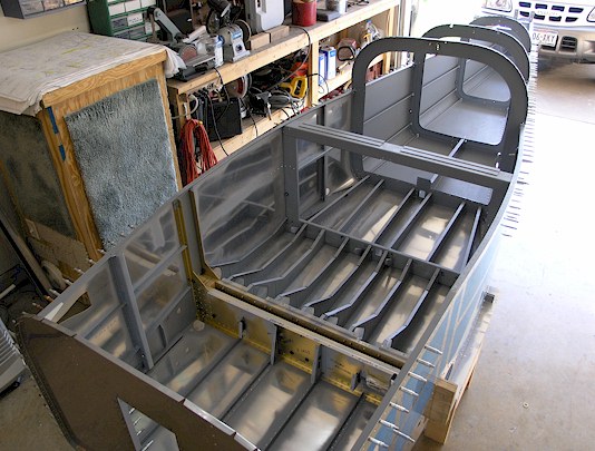

VAF, we have a canoe!
This weekend my lovely bride and I finished pounding rivets and got the canoe rolled...

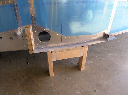

Rolled the Canoe!
I've been waiting a long time for this. Thanks to my best buddy Norwood Story for his hard work and dedication in helping me rivet this dude together.
Here's my homemade flat sawhorse. It's made from an old piece of 1x12 shelfing and some 2x4s. It's 12 inches high. I hope that is an OK height. We'll see.
Here's my tail stiffleg. I was guessing when I made this dude before rolling the fuselage. The 2x4 on top was cut at an angle and has the inside scooped out to match the bottom of the fuselage so it won't slide off.

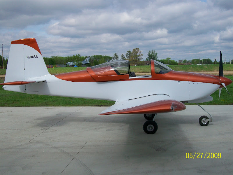

Here are some pictures. The prop is not on the plane for good yet.
rv9a
She needs an engine really badly...

Wow, Kelley : you engine is one nice piece of work.
For my part, I just hit the 200h mark on my project. What was I doing : closing up the empennage. We still have pre-close inspections, here in Canada. I was working on my first fuel tank but since I bought the pro-seal for the tank and just had my EMP inspected, I figured I would try the proseal on the EMP before the tank!
I hit the 200h mark while closing up the rear of the HS
I was kind of weird working on the emp again but at least I can see progress : the wing is very repetitive and it's giving me a break!
