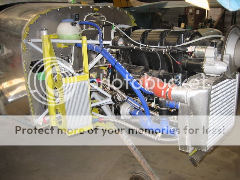

RV-10 builder and tech counselor Gary Speckter came over tonight and helped me hang my engine. Thanks Gary!

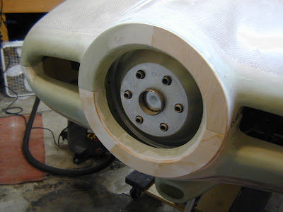

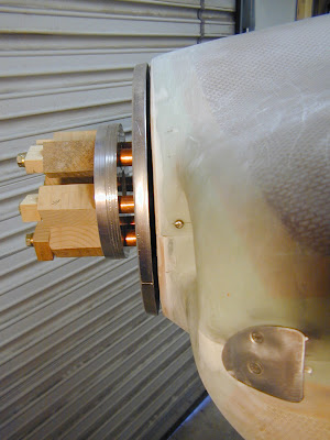

Cowling - Spinner Ring
Today was one of those days where your smile is far larger than the chore just finished. I think that's an indication of how much I love building. I've been working the cowl front ring, compensating for a slight mis-fit that resulted in an uneven gap between it and the rear of the spinner plate.
I had read on another VAF posting that someone had used balsa ring segments, epoxied to the cowl ring, to build up the thickness and reduce the gap. As a former R/C airplane builder, this made some sense to me so I thought I'd give it a try. I used a thick slurry of West Systems and microballoons to fair out edges.
The pictures show the results just prior to a final coating of the balsa with a brushed application of epoxy and flocked cotton to give it some protection. There is a bit of final sanding to do but that can wait until paint prep. Anyhow, I was pleased and smiling when I left the shop. What better attitude to have on the way to the day job!
Just thought I'd share it.

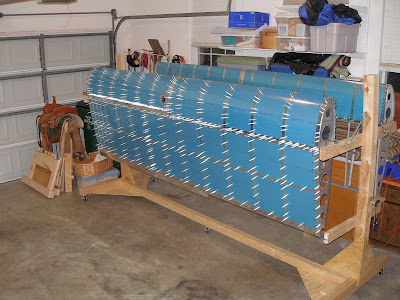

Looking like a wing!
Almost time for Proseal! Both wings have skins match drilled 1 with leading edge and fuel tank ready to assemble for the last time. Still need to take the skeletons apart and prime the ribs, just figured there was no hurry. Gonna have to rivet some of this sucker together to reclaim some of the cleco's!

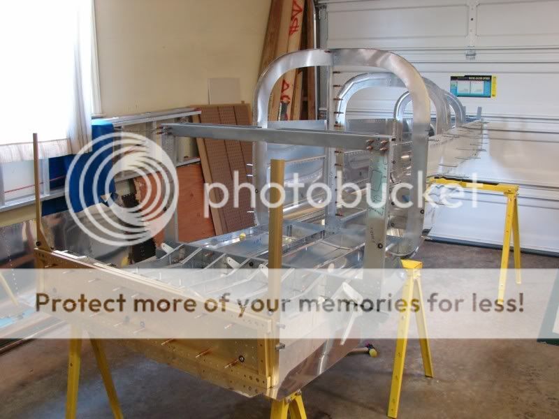

The Canoe is Rolled!
I just past the 800 hour mark on the build....I have rolled the canoe!
[/URL][/IMG]

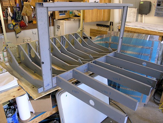

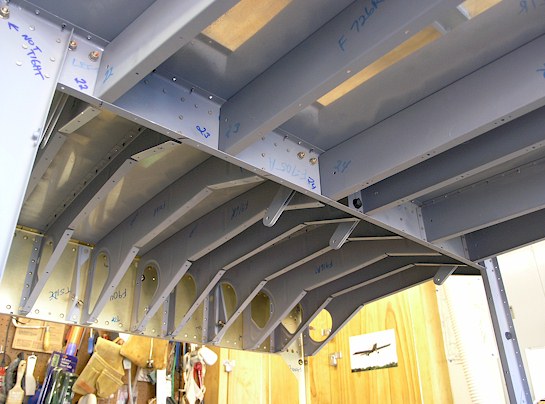

Center section well on it's way
I got the center section skeleton all riveted together today. I pretty much used my 4 inch yoke on the pneumatic squeezer for this whole riveting session. Once I got on a roll, it wasn't so bad.
The I clecoed on the bottom skin. Time to give my riveting buddy a shout! Hey Norwood! Ya' ready for another free hamburger and a beer?

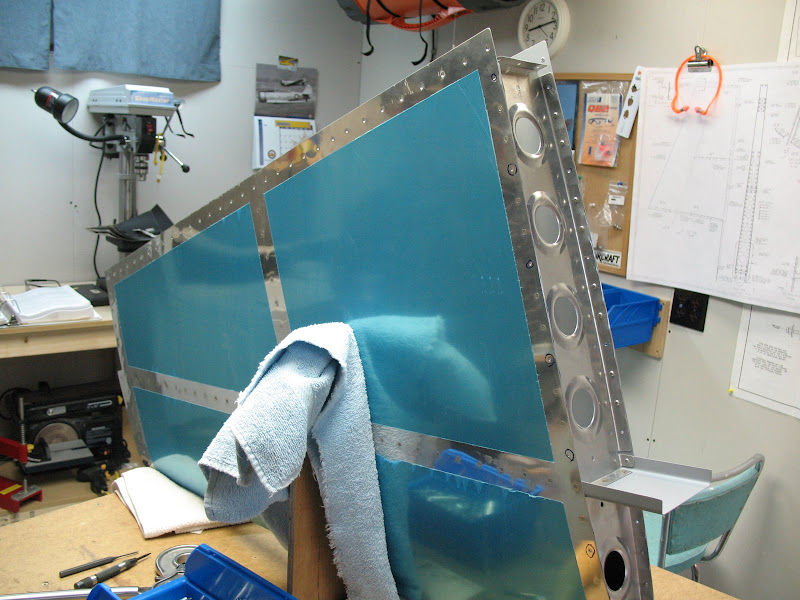

Just completed the horizontal stab(the rear spar is still attached with clecos, we still have pre-close inspections here in Canada)
and started the vertical stab

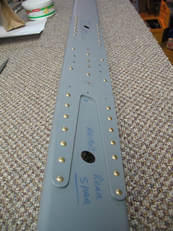

Just completed the vertical stab... that was quick.
Rear spar left un-riveted for pre-close inspection

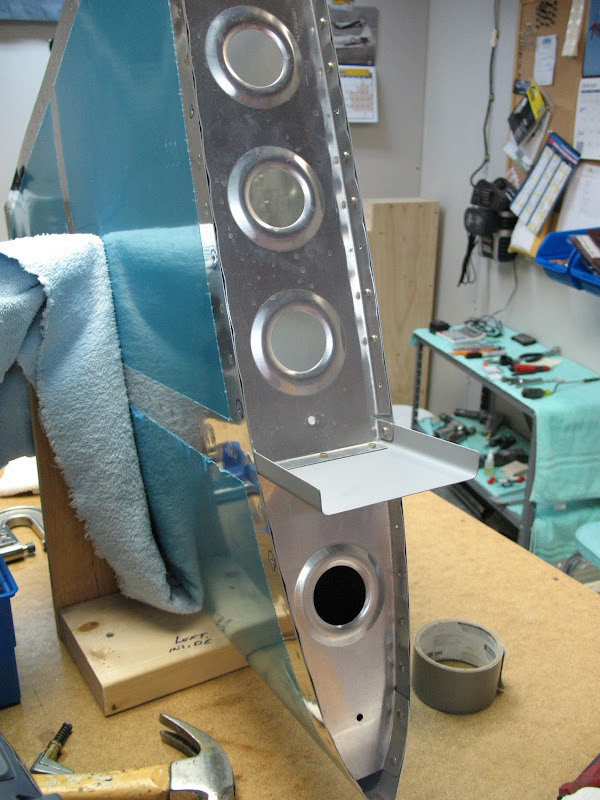

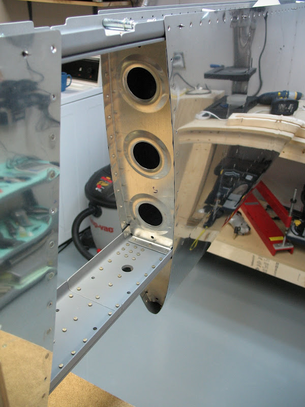

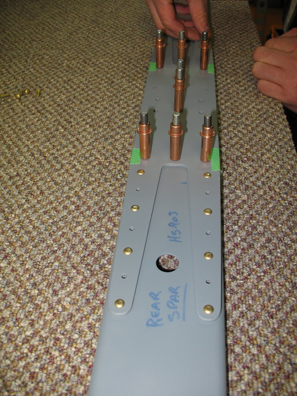

Vertical Fin almost done.
Getting through the Vertical Fin... still need to cleco on the Rear Spar after inspection and drive the top nose rivets. not sure yet how i'm going to reach those two.?? a very thin bucking bar i suppose.
I was barely able to buck them using my small thungsten bar. The first one was fine but once installed, it blocks the path to the 2nd one.
They turned out OK using the following technique :
1-Put the rivet in the hole, not all the way
2-Squeeze it a little
3-Push it flush against the skin
4-Finish the squeeze
I did that by installing the really thin flush set (1/16") on my 3po yoke. I ordered 2 new yokes last week, a longeron yoke and a 4" no hole yoke. I'll probably drill the 2nd rivet out and squeeze it back with the 4" no hole yoke. It's fine (within spec) but the head is a bit squashed and I don't like it!
Ho, and, where's the primer on the ribs :p

thanks, i'll see what we can do... i unfortunately don't have any other yokes for my squeezer though:(
may have to investigate getting some more. i have the one from Isham.
primer is only on the matching surfaces for us:) we debated long and hard over that... and that's what we settled on. :D
thanks for the tips!
pete
got em' done... squeezed the two upper ones and then bucked the others. a modified bucking bar did the trick. so, it's sitting off to the side now.
