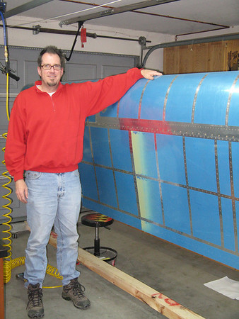

Rolled the fuse tonight!! 808 hours so far, almost 2 years since I started mangling aluminum.
Greg,
You are moving right along. I just checked my log and I was at 1156 hours when I rolled mine over.
Greg,
Yep, I'm trying to get a little done each night. I have averaged 8.4 hours per week so far since I first started. My next door neighbor is the crew chief for the B-29/B25 based here at the Midland CAF, he'll come over from time to time and BS with me while I'm building - he told me a couple weeks ago after I had the center fuse mated to the aft fuse and was drilling the firewall to the frame "Wow, I guess you really will finish it after all." Considering the number of half-started kits that are always for sale, I decided to take that as a compliment.
To be fair, I'm jumping the gun just a bit on rolling the fuse - I don't have the forward bottom skin on yet so it will need to go back upside down for that to be riveted on. I rolled it now to make it SO much easier to fit the rudder pedals on the 719 auxiliary longerons with gravity helping me instead of fighting me. Once the holes are drilled for the rudder pedals, I'll flip it again and rivet the forward bottom skin, then it goes back upright for good.

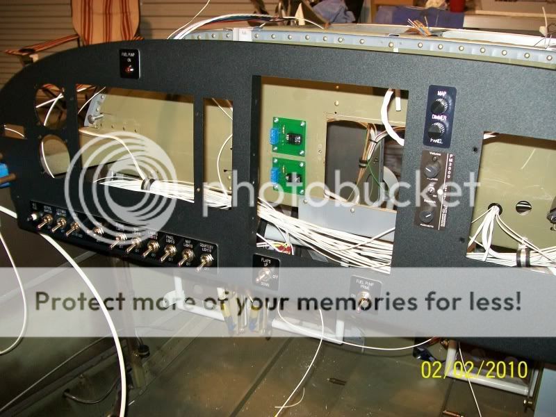

Wow - LOVE that panel Dave! That's almost exactly what I had in mind for my own, very nice setup. I can't wait to start that part!
I was almost sure I wanted a switch strip across the bottom of the panel, on a small sub-panel running the length of the panel, but seeing the way you have them running across the top may change my mind. That's a very clean install and preserves the bottom range for your knees.
Decided that when spending the whole day on a long trip in the plane that the extra 2 inches of room along the bottom of the panel would make for a much more comfortable trip. The space across the top is unusable for much else and with 2 pilots makes access to the switches more accessible to either pilot. They are out of the way of things that may bump them and easy to check without having to look far from the window or flight instruments.
nice panel
Good thinking on the switch placement. Unless you have really small feet, you don't want anything hanging below the panel that could be bumped, hit, kicked, bent, toggled when when you or your passenger enters/exits the aircraft.
Nice Panel ....
...very nice. Your switch placement and related-thinking match mine exactly. I decided I wanted the switches on top when I saw my first Cozy panel and how slick the switches work up there. Once we get flying, most of us don't use the switches anyway; why put them down in the panel's most valuable "real estate"?

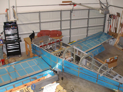

Wings on!
Got the initial wing installation done.
And the flap motor makes a nice whirring noise as the flaps go up and down!

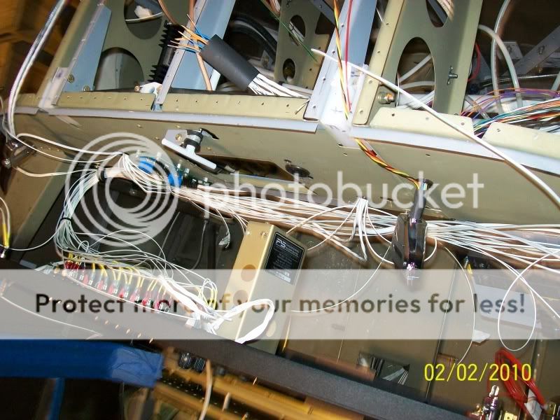

Wiring and Panel Progress
Hopefully I can figure out where both ends of the wires go. :) I got the panel back from the powder coater and engraved the switch plates. Now if I could just get by a week or so without having to order things I forgot. :rolleyes:
