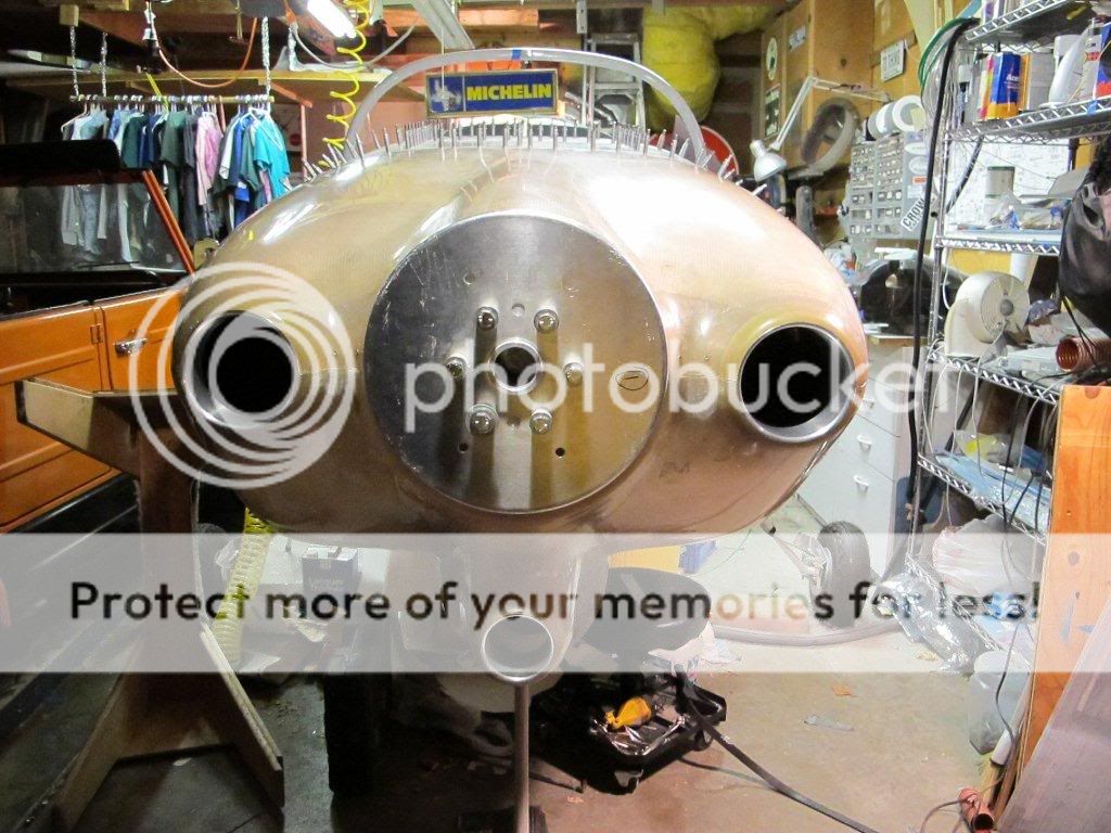

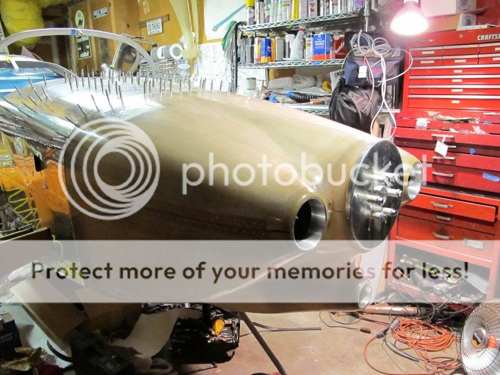

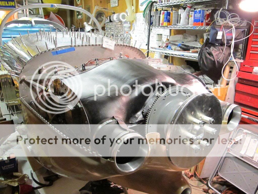

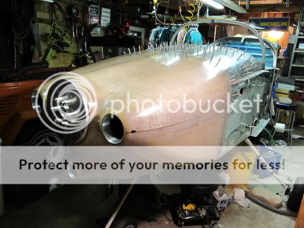

SJ Cowl, plenum, baffling, FWF DONE!
Well, I am calling the cowl work complete!!! I started work on it in July and probably lost about a month and a half due to vacations and holidays. It was more painful than I had imagined. I spent a lot of time figuring out how to fit parts that aren't supposed to work together.
I'm not 100% done but the remaining minor things to do I can do at the airport. You can see the hole and a slot on either side of the cowl for the hinges. I have to make some sort of plate out of either aluminum or fiberglass to cover those but I'll put that off for a while. I also will go through the engine area AGAIN to literally tie up any remaining loose ends.
What's next? Those ugly Clecos holding the last skin on have to go. Then, back to the dreaded canopy, and then finally, the wheel pants. I'm still shooting for going to the airport this year.
You can see I've allowed for quite a bit of engine droop. I have a conical engine mount with the cheap, non Lord mounts so I've read that this set up can droop more than other set ups.
Drool... awesome!
why did you go with that Cowl if i may ask such a simple question! love it!
Thanks!
Well, I hope to lower drag. With a 9, I'm not looking for speed but maybe I can save a bit of fuel.
Secondly, I want to stand out from the crowd a bit.
But the biggest reason ended up being that I really love the looks!

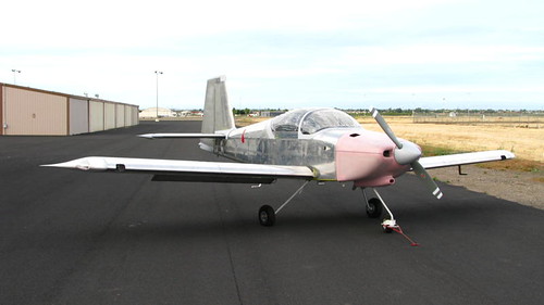

Okay, I am no longer building an airplane in my garage!
Bitter sweet. Awesome to see it go to the airport, sad that I can't work on it in my underwear anymore.
[/IMG]
And on the road
[/IMG]
And at its new home.
[/IMG]

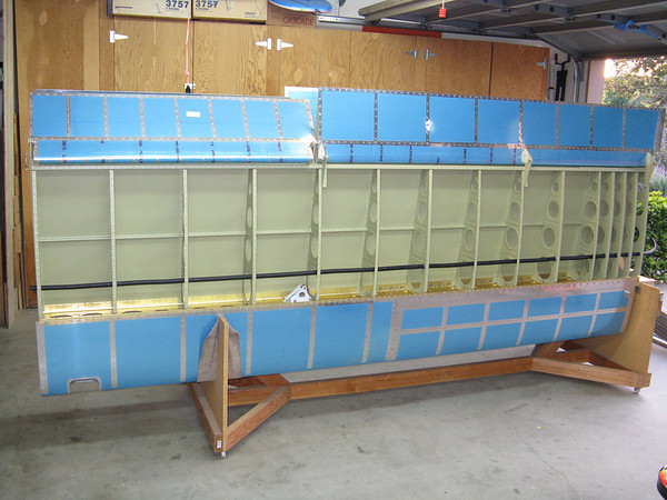

Wings are done (for now)
Wings are off the jig, into the cart. Just some plumbing/wiring/rigging left, but that can wait because the fuselage kit is here.
I must say that building the wings went much faster than I thought they would. I finished them in just under 6 months. That includes time off for the holidays, business travel, and family obligations.

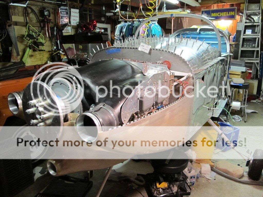

Final skin is attached!
Today, with the help of my lovely wife Melissa, my good friend Paul, and my 19 year old daughter's boyfriend David (heck, if she's gonna have one I might as well put him to work, grumble grumble), I installed the very last skin to my RV-9A. I made some last minute changes to a couple of switches, went through the wiring behind the panel ONE MORE TIME, took some final close out pictures (as we say in the satellite business), and slapped that last skin on.
It wasn't as nearly as difficult as I had imagined laying under the panel and bucking those rivets. I was able to do most of the riveting by myself believe it or not! The toughest places for access were the left and right corners at the instrument panel. The left side was the worst. I have my fuse block, compass, and airspeed indicator over there so there isn't much room. Even after temporarily removing my airspeed indicator, I still wasn't able to reach a few rivets. I ended up using 5 pop rivets over the entire skin because of accessability issues.
Even running a bead of 3M fire caulk along the interior firewall perimeter wasn't bad at all.
The photos below look almost identical to those I posted a couple of weeks ago when I completed my cowl except now I can say, "Look Ma, no Clecos!"
Next is a much needed clean up of the garage and then back to the slider frame work I abandoned a few months back. BUILD ON!

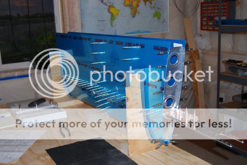

The first part that looks like an airplane part!!
After hours of learning about edge finishing, deburring, hole layout, drilling, fluting, screwing up, fixing and screwing up again I finally have a picture of something that looks like it may belong on an airplane. :D I ran out of cleco's so I couldn't get it clecoed all the way together. I have 150 more #40's coming tomorrow. I should be able to do all the drilling tomorrow too.
I am pretty excited that it is coming together. I also enclosed a picture of my assistant. This is my son Levi and he just loves our shop. He got to do some drilling, deburring, dimpling and riveting today in the shop. His first rivets actually turned out better than my first rivets. I'm a proud papa!:D

Aaron - That first big piece is a real motivator - nice work!

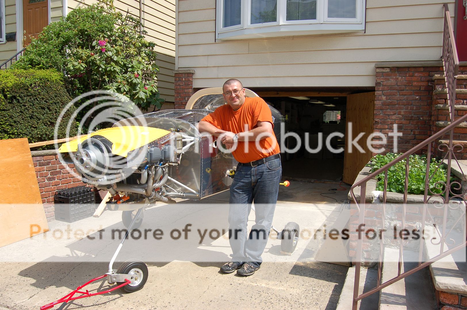

Today was a great day for my wife, who finally saw the plane leave the garage, to make room for two cars, again. The plane went "flying" to the paint booth, a few streets down the road. As you can see in the picture, it is ready and taped up for paint. I had a special lifting jig made (at work) to lift the plane at the front, at the engine mount.
If everything goes to plan, it will be at the airfield on Friday evening, for final assembly. (the wings are already awaiting the fuse, there).
I will report back later.
Regards, Tonny.

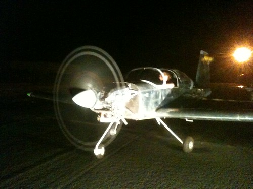

Whew, I am a bit nervous! I did taxi tests today. Everything worked like it was supposed to. I still have a few items let that my tech counselors pointed out.
OSH is not out the question. We'll see.

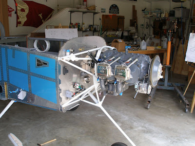

Engine Hung
Well all you other guys had me feeling bad about my progress so this week I got the engine hung. Another milestone accomplished.
