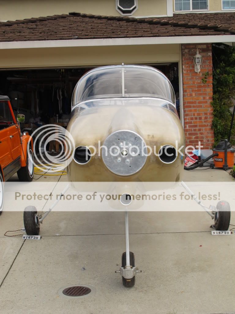

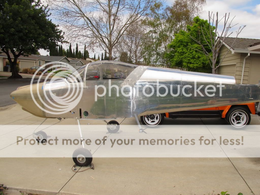

Rolling over the canoe ...
Hi to the Van's community.
Great day for me and my project this saturday !
The D day for "rolling over the canoe".
Empennage and wings are totally finish, I think I am on the good way ...

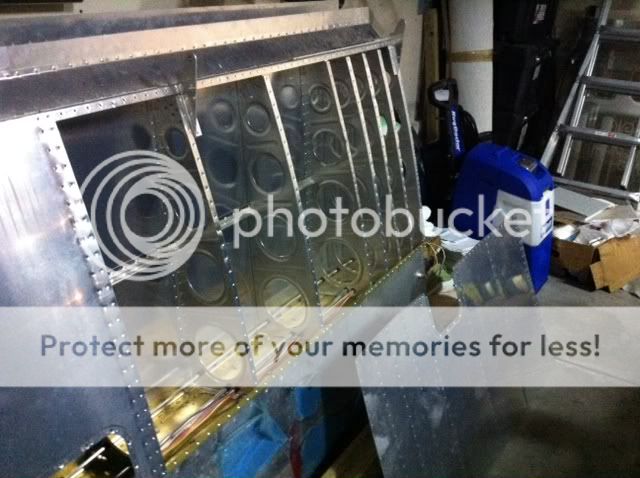

Empennage nearing completion
My last post here was a finished Horizontal Stabilizer. I now have the vertical stabilizer, rudder and both elevators finished, along with the trim tab. Just working to get the counter balance weights installed and then trial fit the components together. The wings are in my garage and the inventory has been completed. You can see the 2 wing boxes in the photo, with the rudder sitting on the spar box.

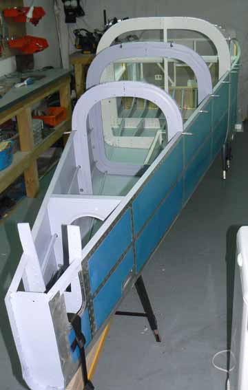

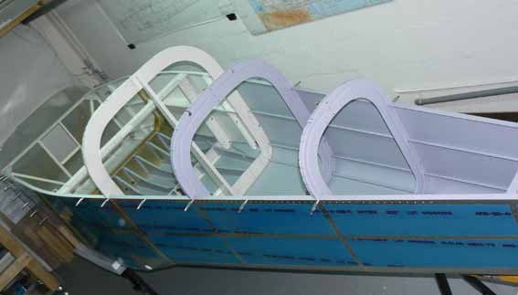

Tail cone assembly
Ok, I read this site often. Figured it was about time I post a pic. Building the fuse is really fun. Found the c frame rivet kit from Cleveland tool, VERY handy! Check out the video on EAA.org. Great for assembling the center spar, small parts, firewall and bulkheads. Ensures consistency of riveting. This is a 9a by the way. Used a SEM rattle can self-etching primer from my local auto body supply. Use a good respirator!

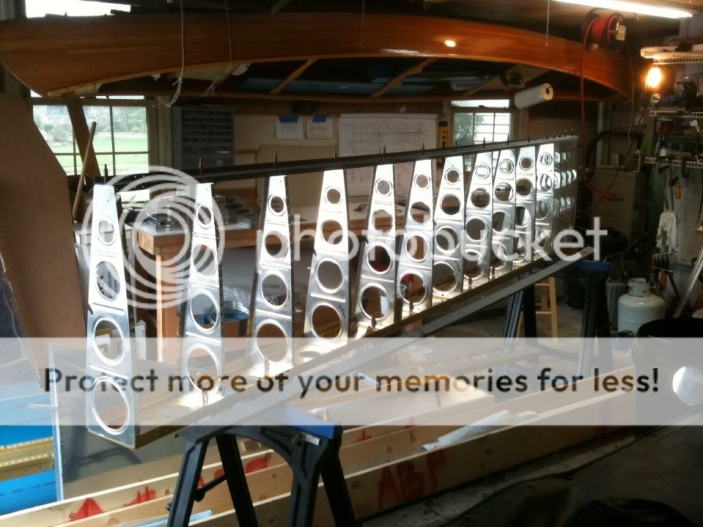

Wings taking shape
Whew - well I finally finished prepping all the spars and edge polishing and fluting all the wing ribs and couldn't resist clecoing it all together. Sure is encouraging to see it taking shape.
