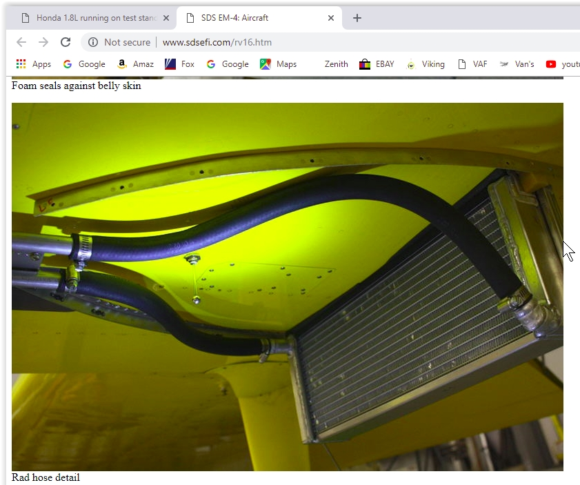

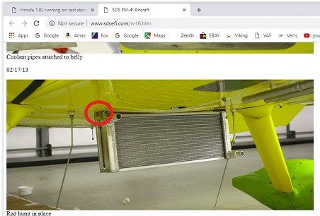

Here are 2 pics from Ross' page.
Question for Ross if you see this post..... Can you confirm the amount of attachments for the radiator itself, is it just these bolts circled in red at the top ends of the radiator? did you capture the "L" angles with 3/16th bolts?
Thanks.
another shot of Ross' radiator install that I plan to copy...
I have a request for a quote from a local radiator shop to build it for me, I believe it will be about $400 to be built.
Charlie

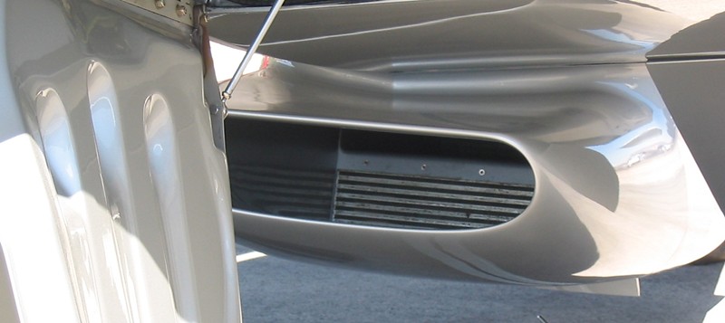

There were a couple .063 vertical tabs welded to the rad tanks with 2 nutplates on each. Two 90 degree angle brackets were riveted to the belly skin with some heavy doublers sandwiched in between. These allowed me to hang the rad and hoses. The rad is really held in place mostly by the scoop. It fits into the recess you can see in some of the other photos.
You'll notice that only the core is wetted, the tanks are not in the airstream like many installations where people get lazy. My coolant hoses and connection are also out of the duct airstream.
Note the guide vanes on my installation. Through flow testing, I found these were required to avoid separation. Russell Sherwood found the same thing in his testing yet you'll find that hardly anyone else uses them.
Above is a photo of a Thunder Mustang setup. Superb composite work but terrible execution inside the rad duct with a big, flat wall of sheet metal for the air to hit. Lots of drag and lots of turbulence. Don't do something like this if you are trying to keep the drag low. Stacked coolers creates even more momentum loss. IMO, it's better to use a good water to oil cooler and enlarge the rad a bit to compensate for the higher heat flow to the coolant.

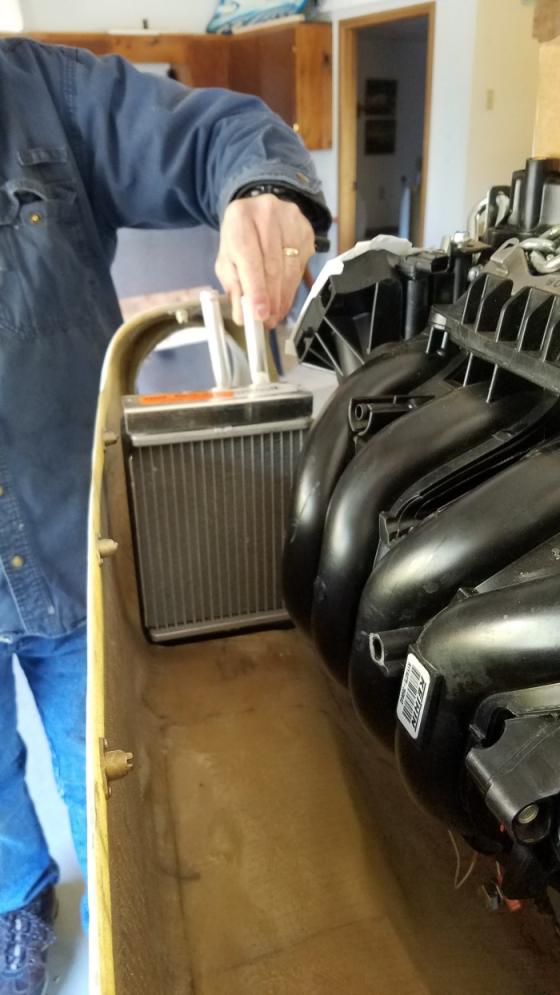

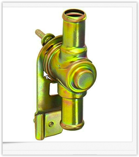

Another aspect I am considering is the use of a manual valve in the bypass loop, or the heater core loop.
They look like this.
Ross, do you or anyone out there have any experience with these... good or bad?
Seem like it would be easy way to adjust coolant flow, much like the purpose of the adjustable exit ramp after the radiator...
Charlie

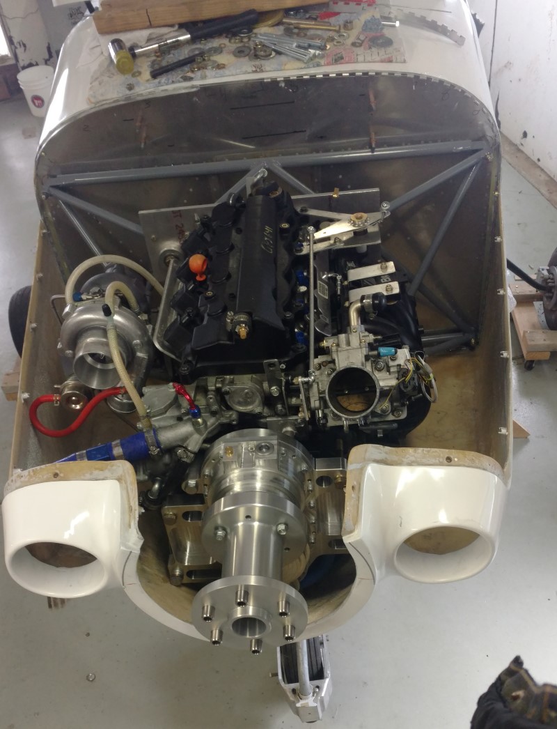

test fit with cowling

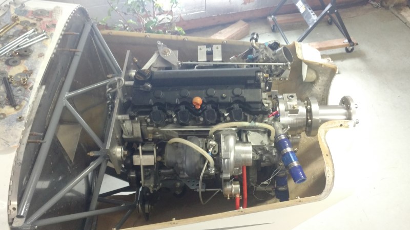

Here are two pics from the first fit of the engine in the cowling. The tough part for me was fitting this set up in a cowling that I made for a different engine. But, the good news is that it look like there will not have to be much modification for things to work out.
Nothing here is hooked up so don't be concerned about all the loose wires and hoses, etc.
Sorry for the hazy pic.
The turbo side. This will be the busy side. Turbo and exhaust, coolant tubes running down and around to a belly mounted radiator, and of course the outlet from the turbo that will be routed to the other side where the intake is....(and disregard the TB you see here. That will be routed lower to fit in the cowling.....
Lost to work on!!

I can comment on that valve. It looks exactly like the heater valve used on millions of Ford vehicles, decades ago, including my 1970 Bronco. They do not throttle, even though upon visual inspection it appears that they should. Heater is on if the knob (cable actuated) is off the stop. After that it doesn't matter if it's wide open or just a tiny bit. in 25+ years and a couple of hundred thousand miles of ownership I've been through a few of them. Despite regular coolant replacement they eventually rot out and spew coolant. If you choose to use one anyway, be advised that they are also directional. Some aftermarket valves have an arrow indicating flow direction stamped on them, but not all. Run them backwards and they leak.
Always an exciting part to put the cowling up and see how everything clears- or doesn't. Good to see the progress.
Thank you for sharing your results. I am still undecided on using it. It would have some advantages to have a valve in the heater core bypass, but I am also a fan of keeping it simple and not adding "things" that are not needed.

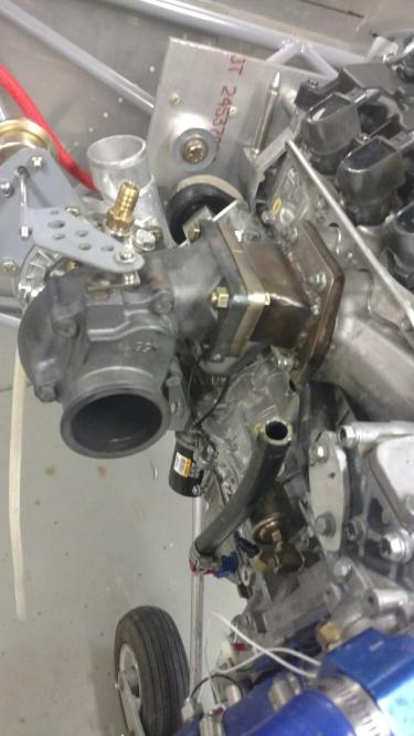

Turbo remount

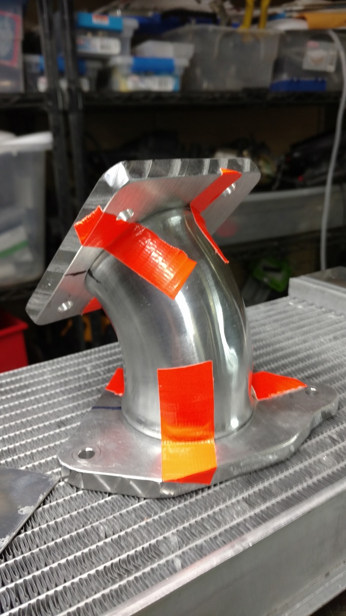

I decided to "flip" the turbo to fit inside the cowling better. I thought I would share this because some people may not know that the center section commonly calls the CHRA (center housing rotating assembly) and the compressor can be rotated, or "Clocked".
In my case, as in a lot of installations, how you configure the mounting of the turbo can include many different positions. All are a trade off. The main issues to work through are the routing of the exhaust pipes and of course compressor outlet pipes so it can connect to the intake. None the least is to also work out the best passage for the oil drain hose.
Here is a picture of the turbo flipped compared to the previous position. You can see from my previous photos this position lowered the turbo by several inches, created a better clearance from the cowling. It does make it a bit more of a challenge to route the exhaust and the drain tube, but overall I like this set up better. You can see that I had to weld up an a short 2" adapter so as the turbo bolt pattern is different that the Honda exhaust flange.
I have not re-positioned the CHRA and Compressor yet. That is to come..
Charlie

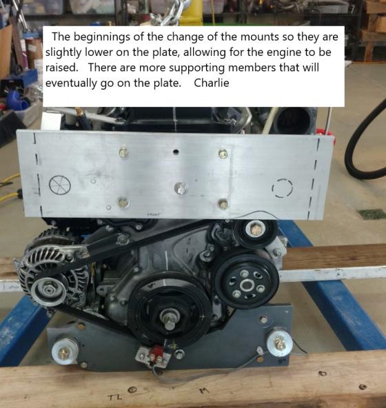

changing the mount plates to move engine up.
One of the advantages of the engine mount and plates of this design is the flexibility to move the engine a minor amount up/down/left/right without having to build a new mount.
Once I rotated the turbo 180 degrees (flipped it) it allowed for a lot of room above the engine overall. With this new room, it just made more sense to move the engine up almost an inch. While that does not sound like much, it will be quite beneficial in my case as it will allow me to do less modification to the cowl, especially around the spinner.
To move the engine up almost an inch, I just need to lower the points on the engine plates down an inch. Here is a pic of the top engine plate being re-drilled with the engine mount bolt holes relocated.
Notice the lower plate with the mounting bushings still in place. The lower plate mod will be next.

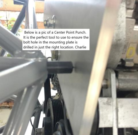

Also, one tool that is exceptionally handy at this stage is the use of a Center Point Punch. As you can imagine, it is critical to get the engine mount bolts holes drilled in the precise location. Fortunately you can get a set of center point punches at most hardware stores for a reasonable price. If you venture down the road to do a alternative engine installation they are a "must" have tool. There is just no other way that is easier and more precise to transfer patterns that this.
I will post pics when both the plates are done. One thing I know for sure at this point, I will also have to redesign the idler pulley mount. Not a big deal but something to accomplish. Those weird challenges are almost enjoyable to me.. It is a chance to tackle something new. If that sounds crazy to you, you are probably not one to take on a alternative engine installation project. If it sounds like something you would also enjoy, you are probably "wired" just right. :) for an alternative engine install....
Charlie.

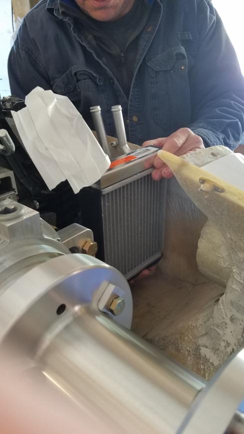

I also got the radiator in the mail today. While looking for the right radiator and talking with a local shop about making a custom unit, I found out that a Honda M/C CBR 1100 was so close to the dimensions I needed that I decided could not pass it up, so I ordered one. I think it will work out well, and they are plentiful and as such very reasonably priced.

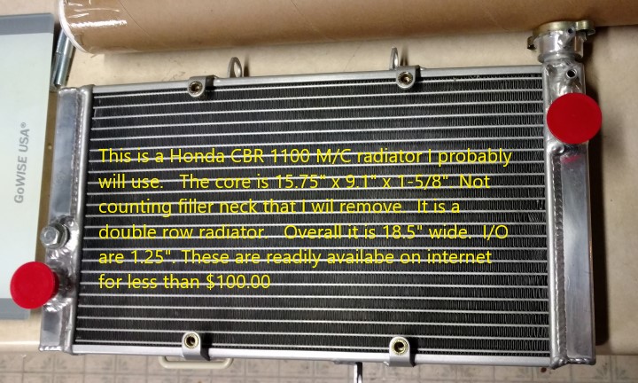

Radiator

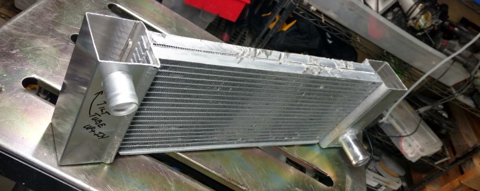

Below is a picture of the radiator I am seriously considering using for the under the belly scoop (like Ross from SDS). Arguably you can consider this somewhat akin to the P51 concept.
As you can read in the pic this is what is used on the Honda CBR 1100 M/C. They are readily available on the "net" for less than $100.
It is not exactly as wide or as thick as would be ideal, but all things that I know, this should work out OK. I also plan to use a fairly generous heater core up front in the cowling on one of the two bypass loops which will also help provide some cooling.

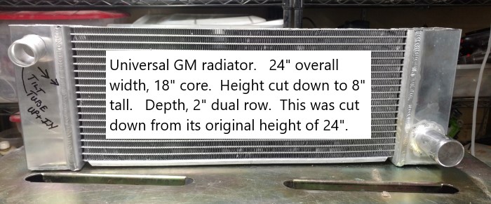

One issue that I will debate while building the scoop is to "tilt" the radiator to lower the profile. While I completely understand it does negatively affect the airflow, as thin as this core is, it won't be as much as if it was a 3" core. If it it was that thick I would not even consider a tilt. This is in the yet-to-be-decided category.
( updated - I end up not using this and went with one that was shorter and wider...…-CR)
I wouldn't consider tilting it. Any reduction in frontal area scoop drag will be likely offset by increased drag within the duct. If you look at the angle required to actually reduce the frontal area given the depth of the core, you'd have to lay it down a lot. This makes it harder to mount as well.
Ross,
I do agree "tilting" is not ideal, especially as it relates to the direction of the airflow, and knowing the radiator I am considering, it is only 1.2" "taller" than what is ideal, it would be easy to remove an inch for a better (reduced) frontal footprint.
I remember your write up, you made sure to avoid angles that are greater than 7 degrees. This is consistent with what I have read in various other articles. I also agree that ideally tuft testing for laminar flow is very helpful, and if I remember correctly in your case this helped you to learn that adding a sheet to direct flow to reduce separation and get more laminar flow.
Thanks for your willingness to share your experience.
I do plan to create a cardboard mock up and see what I like, as well as see how well things go together and of course, how much I can keep it simple but effective.
Charlie

I also found another radiator and a professional sheet metal guy who is willing to chop it for me for next to nothing so the other one would have a core that is 20" wide, and 2.2" thick. I would probably cut it down to about 7.5" tall.
Not a huge difference but maybe enough to avoid some high temp on the hottest days....like waiting for TO at OSH!

Now that I have the mount done, the cowling on, the turbo flipped, and the decision made to install the main radiator under the fuse.....it is time to get serious about "plumbing" and routing.
I need to find a home in the cowling for the:
1) Intercooler. Looks like this will be "inside" the engine mount. The cool air duct will probably be from a naca inlet in the bottom of the cowl.
2) Heater core on the Bypass loop. Looks like this will fit just inside the left inlet.
3) Oil cooler. Not sure yet. I might be able to snake hose from the right inlet but I need to do other work first.
4) Exhaust. This will loop 135 degrees to angle down outside the bottom of the cowling about mid way.
5) Route the coolant lines to the belly radiator.
6) Clock the turbo and create new oil feed and drain lines. These will have to be redone since I flipped the turbo.
7) New mount for the Throttle body. Which of course means new linkage too. Fun....
If you are new here and wondering that this all looks like the last few pics of the engine in the cowling are on post 267...
This should keep me busy for a couple of days. :)
The NACA duct isn't a good choice to feed heat exchangers, especially a thick one like a typical intercooler. A ram duct will be far more effective if you have a place to fit that in.
Yes for sure. I certainly am open to that idea, I would think that a 2" opening would be more than enough (considering it is ram air up to 160+ mph) (?)...and the bottom of my cowl slants downward so it really does lead well to doing this. I might try to create a mock up using PVC pipe of what just crossed my mind to see if this is what you are thinking.....(Essentially having a 2 inch tube protrude a very slight amount and glass it in...)
Charlie
Charlie
I doubt if a 2 inch round duct would provide the required air and you'd need a very efficient diffuser to wet the whole HX surface efficiently.
Based on some early design ideas i do think I ll be able to get the air flow coming at the face of the heater core and intercooler.
There's always a trade off. Either bends in the supply routes or bends in the cooling tubes, but rarely are both sets straight.
I know the goal is to work on the design to get the most fresh air there with as few (sharp) bends as possible. And... without compromising the supply lines.....
The bigger concern is that a 2 inch round hole only has an area of around 3 square inches and you won't get the same mass flow as my inlet which has about 17. 17 may be overkill but pretty sure 3 isn't nearly enough. Climb is where you'll see most oil temp issues where your mass flow is about half of what it is at 160 mph.
Sorry I may not have been clear. I'm leaning towards a ram air for the intercooler. The left nose inlet for the heater core and a separate dedicated ram air for the oil cooler. Sizing of ducting TBD...
Depending on compressor efficiency, boost and altitude, the heat load of the intercooler can be substantial and you'll need a fair size duct feeding that too. I was way too small on that initially. I eventually re-positioned the intercooler and tripled the size of the duct feeding it. IATs all good now.
I got the heater core yesterday. This is what I plan to use for the bypass loop. This one has a core that is 9"x6"x1.5". It is a heater core from the CJ series of Jeeps.
The pics show it held up front behind the left inlet of the cowl. It fits very nice there. But if i moved it to the right side I could dedicate the left side for the intercooler, which would save me the need punch a hole in the bottom of the cowl for a new ram air source for the intercooler. The only problem is the right side of the cowl is really busy and squeezing even that small heater core will be a challenge.
Belly radiator in progress
Here is a look at the newer slightly larger main radiator that will go under the belly. I opted to go with it instead of the Honda M/C CBR 1100 radiator because it was slightly bigger. The Honda was about 200 Cu In, and this will be about 290 cu.in. Since they both had to be cut down, I figured might as well go with the one slightly larger. Plus at 24" wide this just happens to be the right width for me to be able to capture the angle aluminum in the belly which will be a good place to rivet to.
This is in the cut down stage prior to being welded.
This pic below gives a better view into the cut off section. I used a metal blade on my table saw, which does an excellent job of cutting it. the top part of the core is actually a coolant tube that I split with the table saw blade. I will reinforce this with a 0.125 bar of 6061-t6 as well as cap off the side tanks. The tanks were much larger than I prefer at 2.75" square, but not so large I was interested in cutting them down. It calcs out to about 4.3 lbs of water in the side tanks so not real bad...
One thing you cannot see it the filler cap that I cut off and this will be closed off with 0.125" 6061-T6 as well.
Charlie
new rendition of the throttle body location
I thought I would show my newly modified TB mount. It is in the mock up phase and I hope to have it welded by Tuesday.
P.S. I cut 1/4" and 3/8" aluminum plate on my table saw with a non-ferrous metal blade with no kerf. These are common in the aviation section in Lowes or HD. Works great!
It will go where the intake variable length runner motor/actuator usually live. I took it out. Not beneficial for my needs. ''
